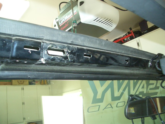

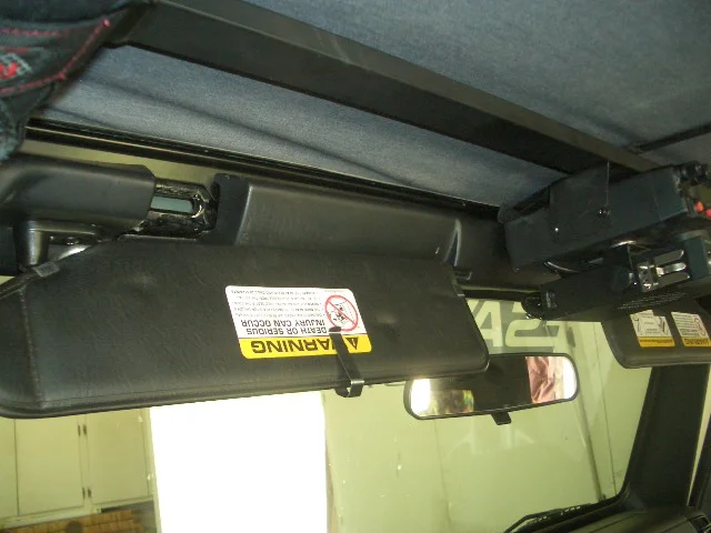

You can install Bestop's permanent header bar that mounts on the inside frame of the windshield, it can stay in place with hard tops and soft tops. You just have to make sure to get the right Bestop bikini or safari top that is made to work with the header.
On 2002 and older it attaches easily with just screws. On 2003 and newer it mounts the same way but you have to temporarily unsnap/lift off the plastic trim to allow the header to be installed underneath it.
This header provides a long slot across the top that you slide the bikini/safari top sideways into. It works great, much better and easier than the cumbersome "no-drill" header that I finally threw into the trash.
