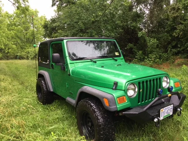

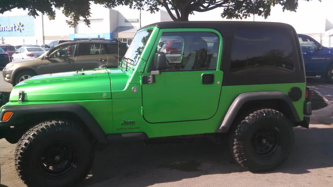

2005 wrangler SE 2.4 banger
I'm not sure if I call this a build or not. I've only owned it for about 3 months so I'm fairly new at this. I'm changing a few things here and there. I want it to be solid & reliable more then anything. Get me to work in the snow, weekend vehicle/toy. Nothing special, mostly stock, no lift. A few things I've done so far:
15 inch Pro-comp steel rims
Crosswind mudders 31X10.5
Moog front & rear sway bar links & bushings
SkyJacker steering stabilizer shock
Smittybuilt XRC front bumper 3/16 steel
Barricade trail force HD rear bumper 3/16 steel
Front & rear drive shaft u-joints Dana spicer
Cobra sound tracker 29 WX CB radio
6 ft fire stick antenna
Best top floor mats
Cabelas trail gear seat covers
A winch is on the list and I'm pretty sure I need a new muffler.
Thanks for looking
