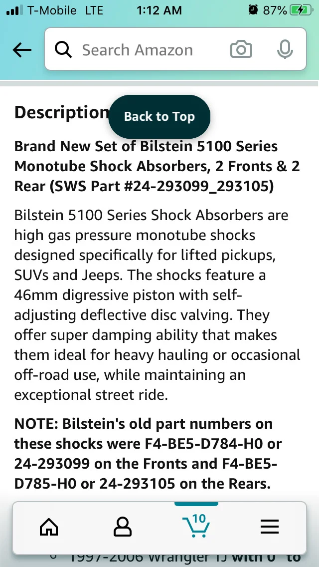

Hey gang,
I hears lot of talking how great the Bilstein 5100 are for stock height applications but I was wondering if there’s a difference in the part numbers noted on this post for a zero inch lift and other ones I seen on Amazon besides the blue or black boot option. Don’t won’t to make the wrong purchase. Thanks in advance.

Look for those part numbers on the Bilstein website and they will tell you what lift height they are meant for.

They check out. It appears as if they’re both made for my application and not to mention on sale none the less. Thanks for the heads up. You sir have saved me 60 bucks.

Keep reading. Great might a generous statement, unless your are ok with a jittery ride.

You might look into the 4600 as well. That is the shock for a stock TJ, the 5100s are longer even though they are advertised as 0-2" the 4600 is actually the stock size.
