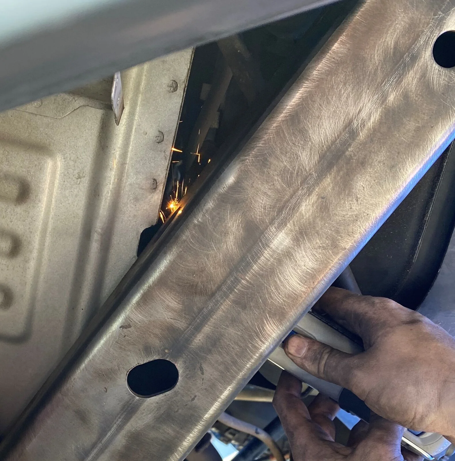

I went with the 5100s; thank you for listing part numbers. Only issue I had is the dreaded top bolt breakage on the top rear left shock mount. Took a dremel tool with metal cutting disk (went through 4 of them) to cut the welded nuts off the frame. Really only had to break the welds, then knock them off. Very hard to get to though and the whole job took about 6 hours because of this. Replaced with new bolts (not provided) and was good to go. Note; These 5100s worked perfectly with my 4" lift on my LJ. The ride is much nicer now, though there is still a bit of sway at speed that I don't care for.
