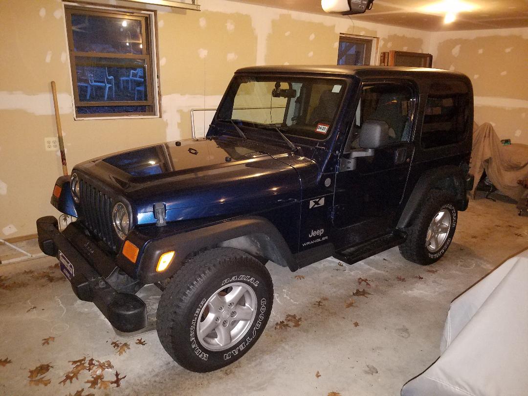

2004, X, 4.0, 5 Speed. This is my daily and I live in the New England area so pot holes are a norm.
Looking for smoother ride. Narrowed them down to the two brands I keep seeing.
Of the two (and only the two please) what's your choice, Bilstein or Rancho?
