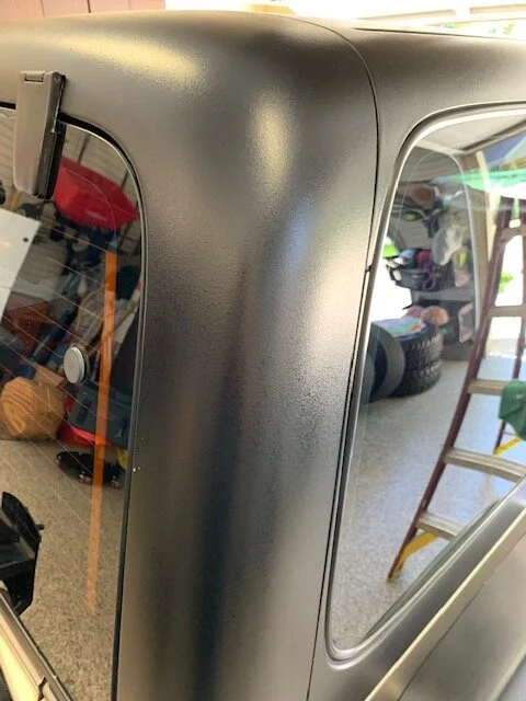

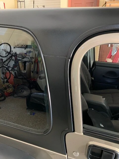

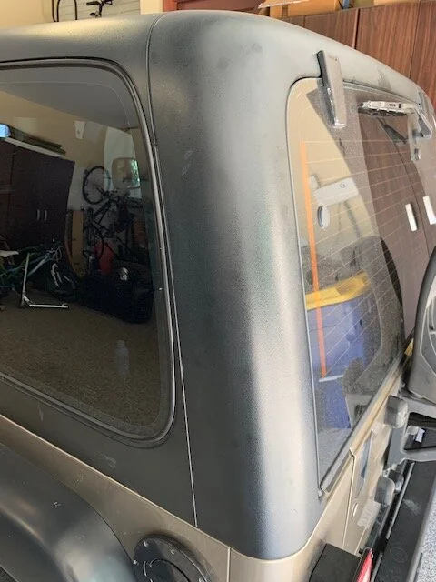

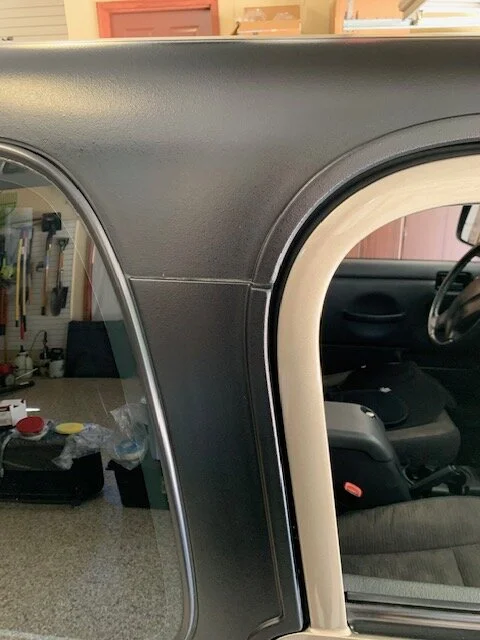

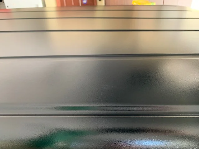

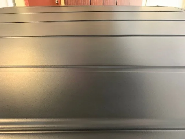

The next several posts contain pictures showing the "before" any work was performed to the hard top followed by each step mentioned above. I'm separating pics to show the difference on the top, side and rear corner using the Magic Eraser, compound, and polish.

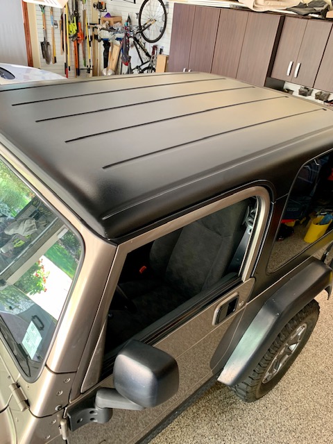

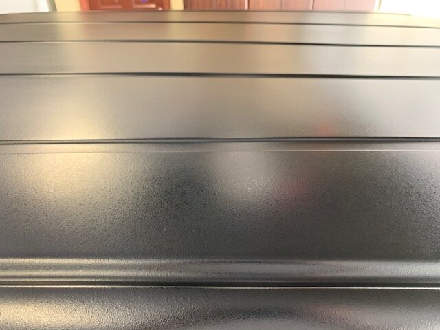

Following pics are of the top of the hard top.

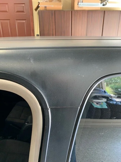

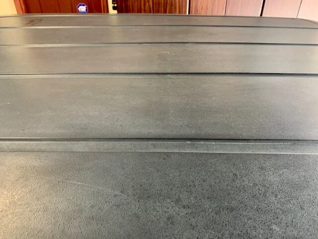

Before any work was performed...
After Magic Eraser...
After Meguiar's Ultimate Compound...
After Meguiar's Ultimate Polish...

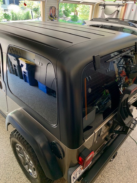

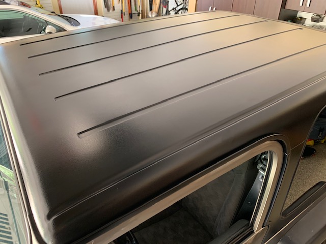

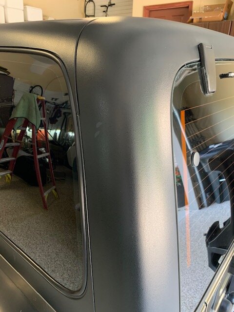

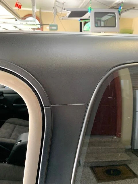

Finally a few more shots of the hard top after the last step of polish was applied...
Hope this is able to help others contemplating what to do with their hard tops. After I apply the Turtle Wax Ceramic wax spray I'll post a few more pics. I'll also keep track on how long the finish stays this way and if/when the oxidation comes back.
