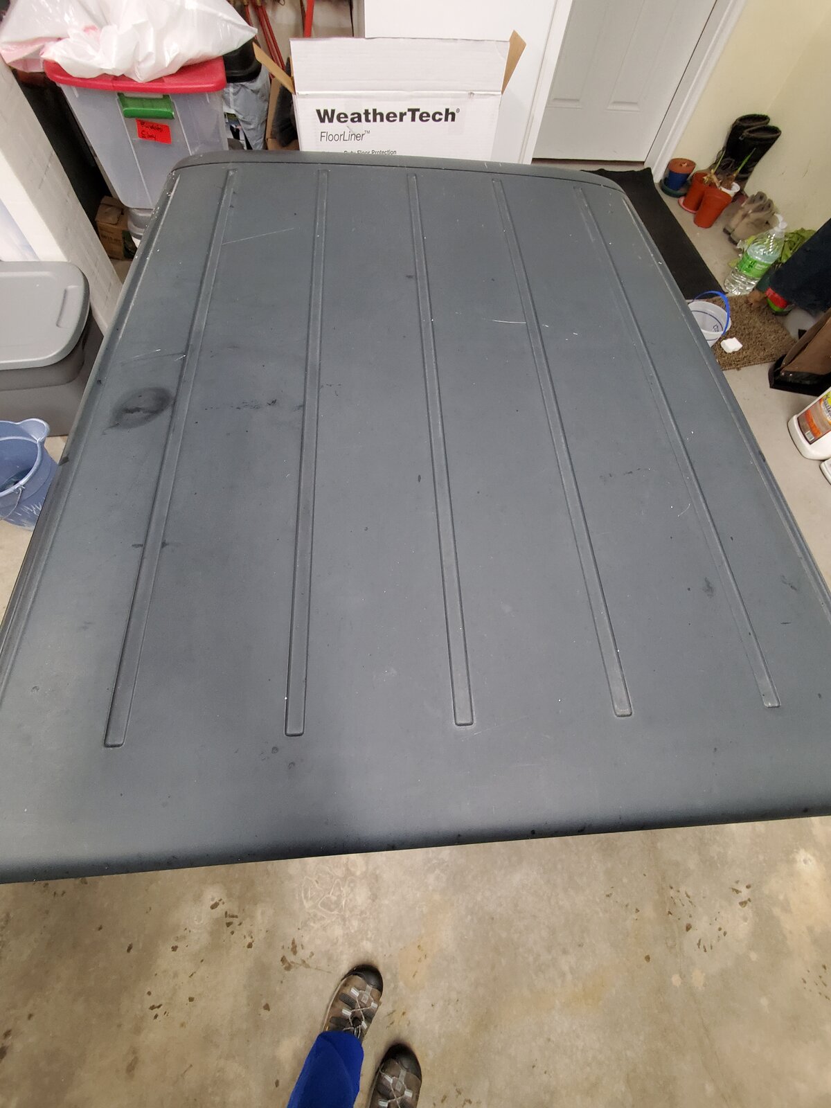

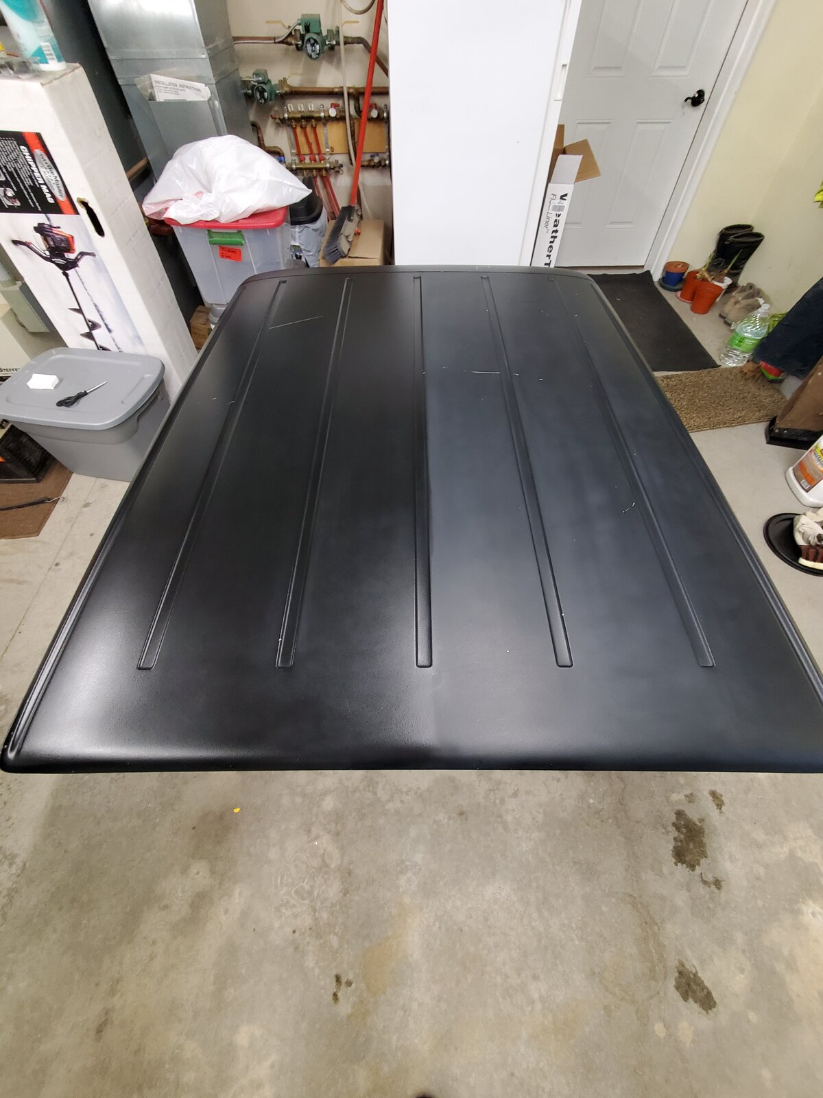

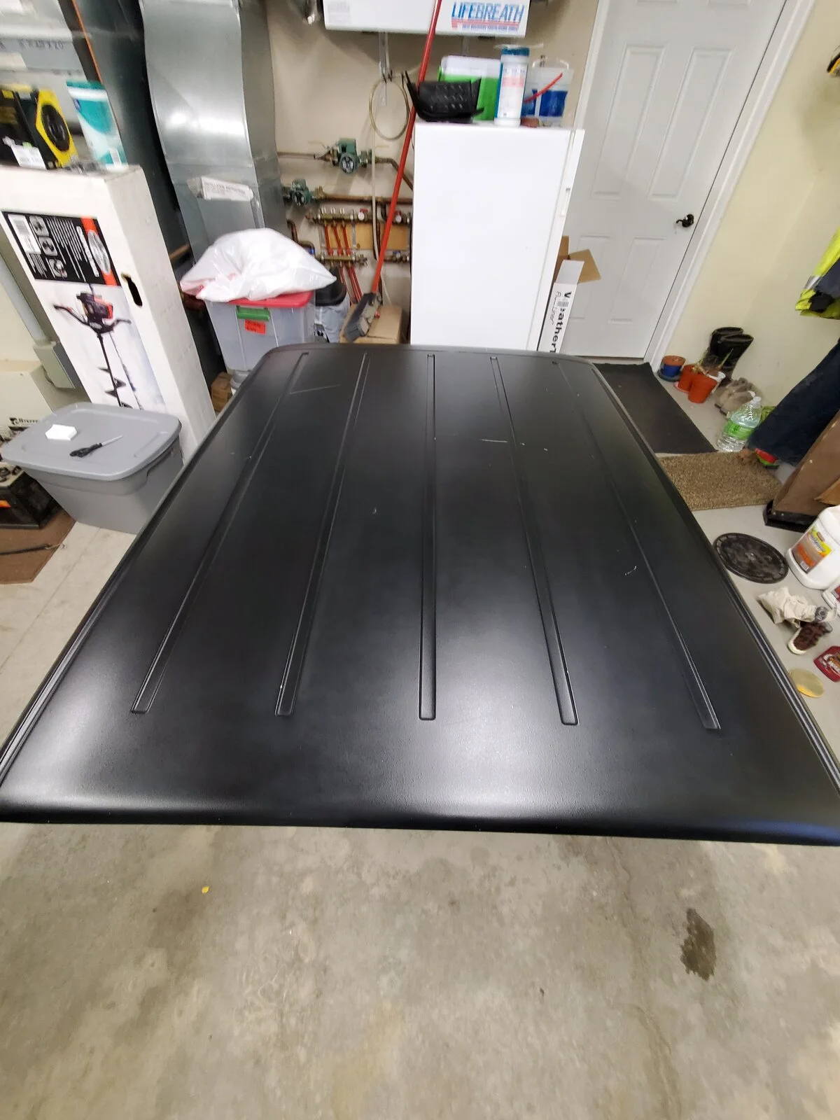

After performing the multi process listed in the main post, this past weekend I applied Turtle Wax’s spray ceramic wax. It’s not a 100% ceramic application, it appliers to be a hybrid.
I was questionable about using a spray application and thought paste wax with elbow grease was the way to go. To my surprise, the spray ceramic Turtle Wax is considered easier to apply and performs much better.
1st application was yesterday around 3PM. S simple spray on, wait to haze, and the ln buff off. The surface was was very slick. I kept it in the garage overnight and throughout the next day. At 3:30, 24 hours after the first application (to let it cure), I applied the second application. Everything went according to plan. Adding another application seemed to increase the surface gloss and slickness. I’ll let it cure for 24-hours and then drive.
Turtle wax’s supply of ceramic was was very easy to apply and cost maybe ~$16 for an entire bottle.
Product information says it would last up to up to 6-months. I’m monitor by the “feel” test.
Hope this entire write-up is beneficial to several folks. It was all trial and error, thankfully all success. Expect to use some elbow grease😉, the orbital buffer was a great time savior. Although not 100% needed. Lastly, used quality soft fiber cloth to apply and removed. They can be washed and “refreshed” with Chemical Brothers laundry detergent as well.

Hard top came out great! Very nice job. Did the turtle wax change the appearance at all after two applications?

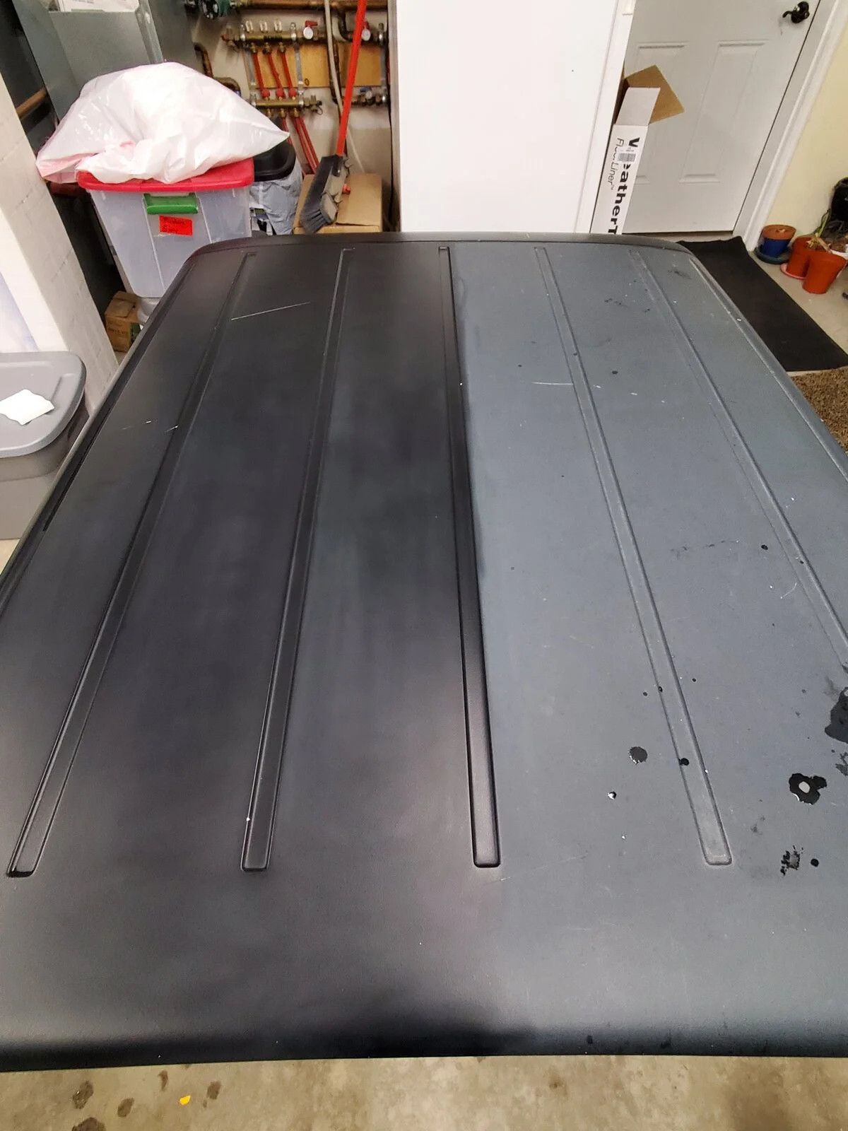

Wow, what an amazing write up! Thanks so much! I just got an 03 as well and the top was grey. Thought about the whole painting thing until I read your how to. I figured it was worth a shot. I did magic eraser, meguires cleaner wax and now am waiting for the ceramic turtle wax to arrive to finish! So far very happy with it. It's actually black again!!!!!!
Pictures = nothing, half magic eraser/half nothing, half cleaner wax and buff/half magic eraser, all cleaner wax and buffed.

Wow! What a difference!!! Glad to have helped. Your top came back surprising well. I had my top off and stored in the garage after I cleaned mine, hard to say how long it will last. The hard top went back on last week with the colder weather. I plan to update this thread during the Fall and Winter to show how long it lasts and if I needed to perform any additional steps.
What's nice about the process, it doesn't take an extremely large amount of time. Hopefully I can catch any additional fading before it gets out of control to keep it looking nice.

Sorry, I missed this earlier. The Turtle Wax gave it a bit more of a shine, didn't remove any oxidation. I did the entire Jeep and the pain is still very slick and the water beads and rolls off just as it did the week after applying. It's only been a month+, we'll see how it performs going into the Fall and Winter. It's so easy to apply, I might give it another coat if we get a day of warmer weather during Nov.
