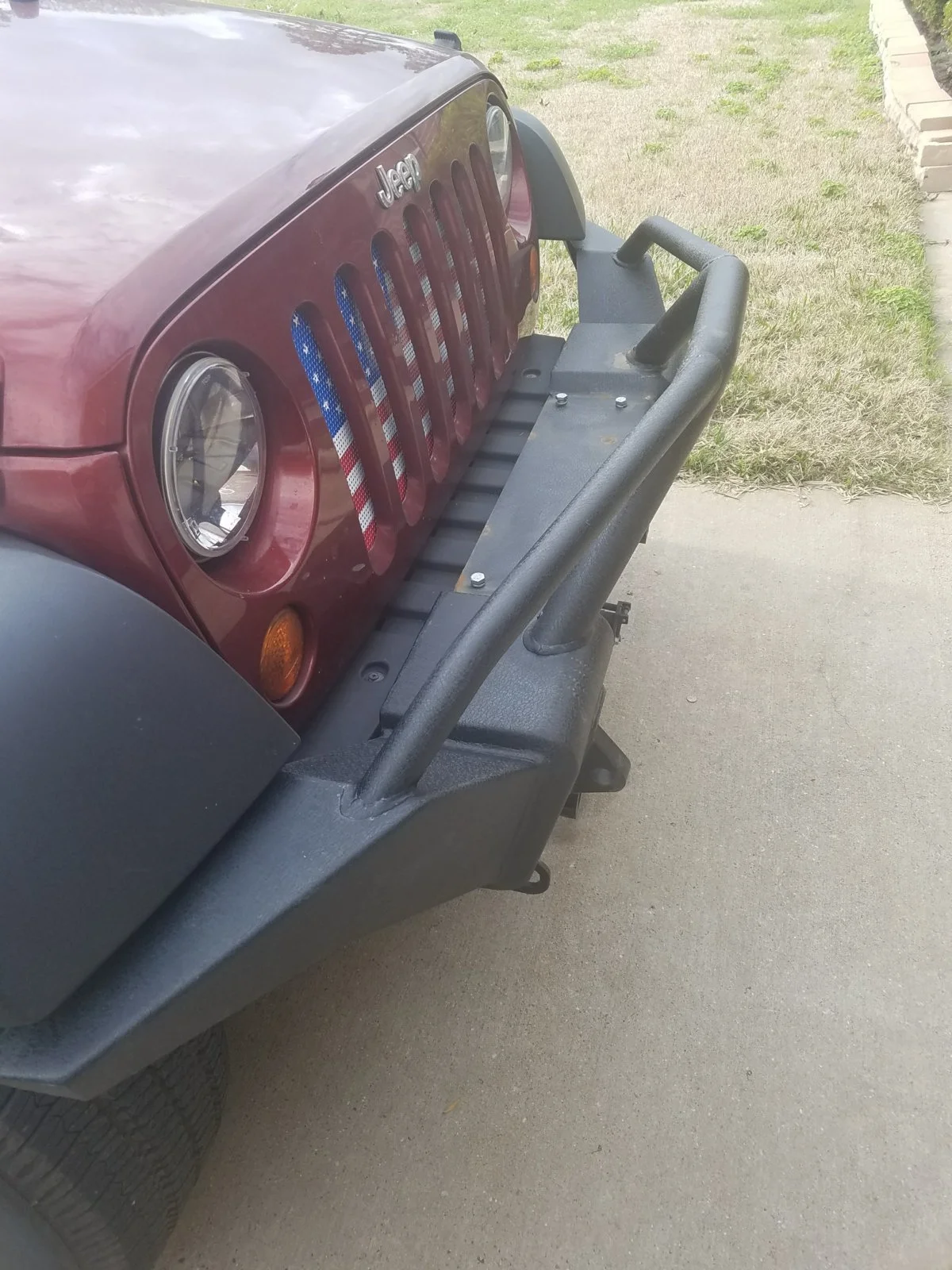

Well this is antidotal I know but when I mounted my front bumper I chose to grind (think more of sanding) off the dross and surface rust using a 10 dollar air angle grinder from HF. Once satisfied I laid down a coat of VHT Rust converter (SP229). This gave me a solid base for the final coat but it more importantly converted any iron oxide (rust) missed into iron tannate chemically. The resulting surface is black and very rough. This served as a solid base for Dupli-Color Bed Coating (BAA2010) it took 2 16 oz cans to do my bumper in 2 coats. It's been two years and there is not one sign of wear or peeling. I could not be happier with the result. What ever you decide put 80% of your effort in prep 15% in the finish saving the last five for beer and grins.
