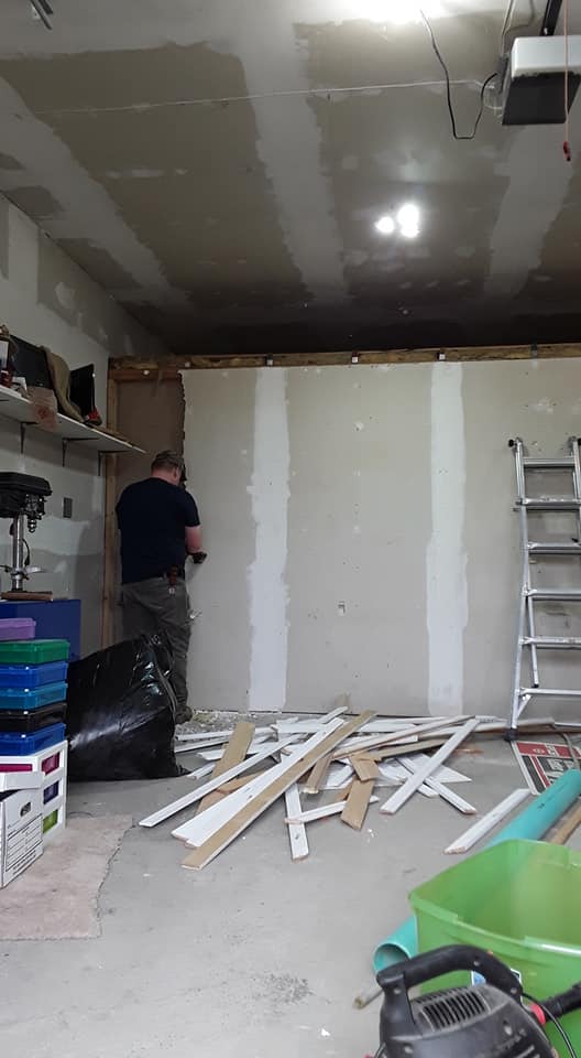

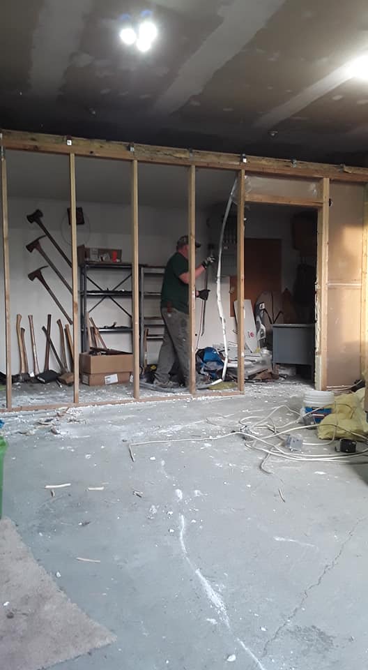

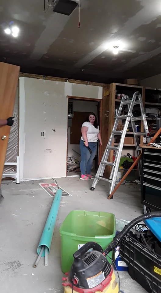

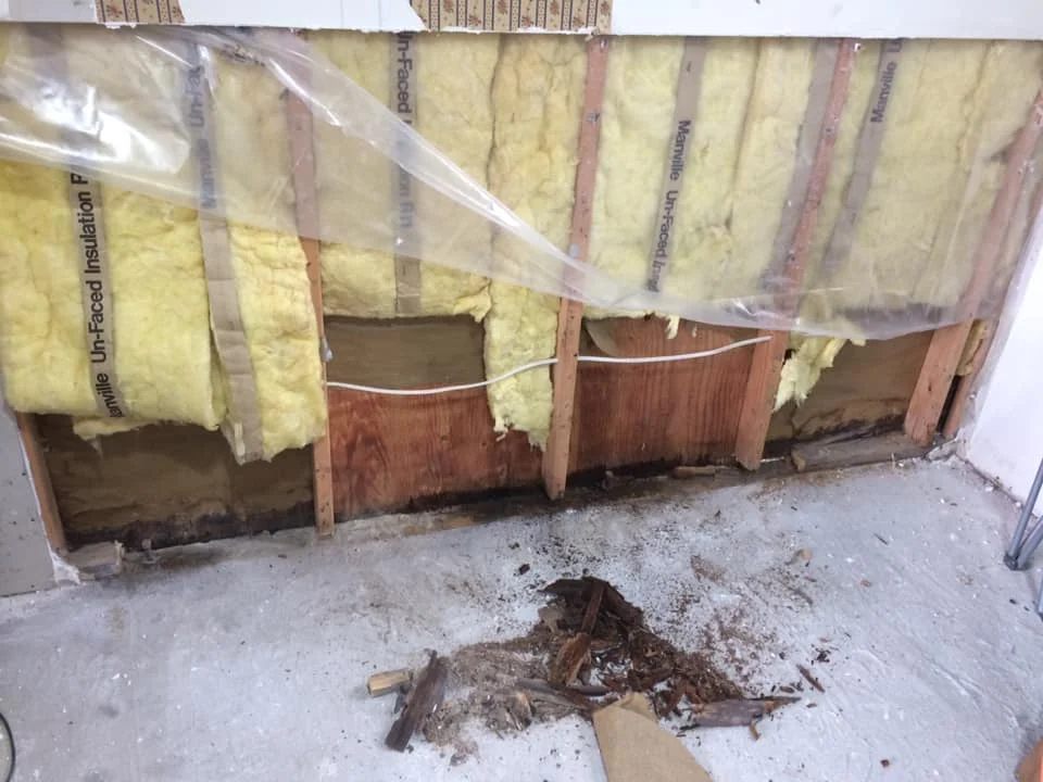

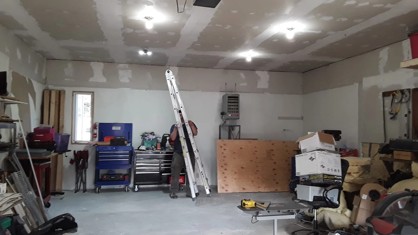

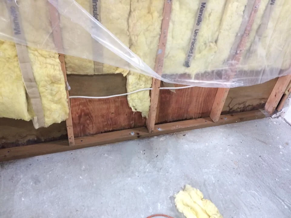

The first real problem that had to addressed is that at some point one of the previous owners had converted the back of the shop into basically a bedroom. It was walled, had a ceiling and was wired and insulated. The shops Modine heater was in this space as well and had not been in working order for some time. So first order was to yard that all out.

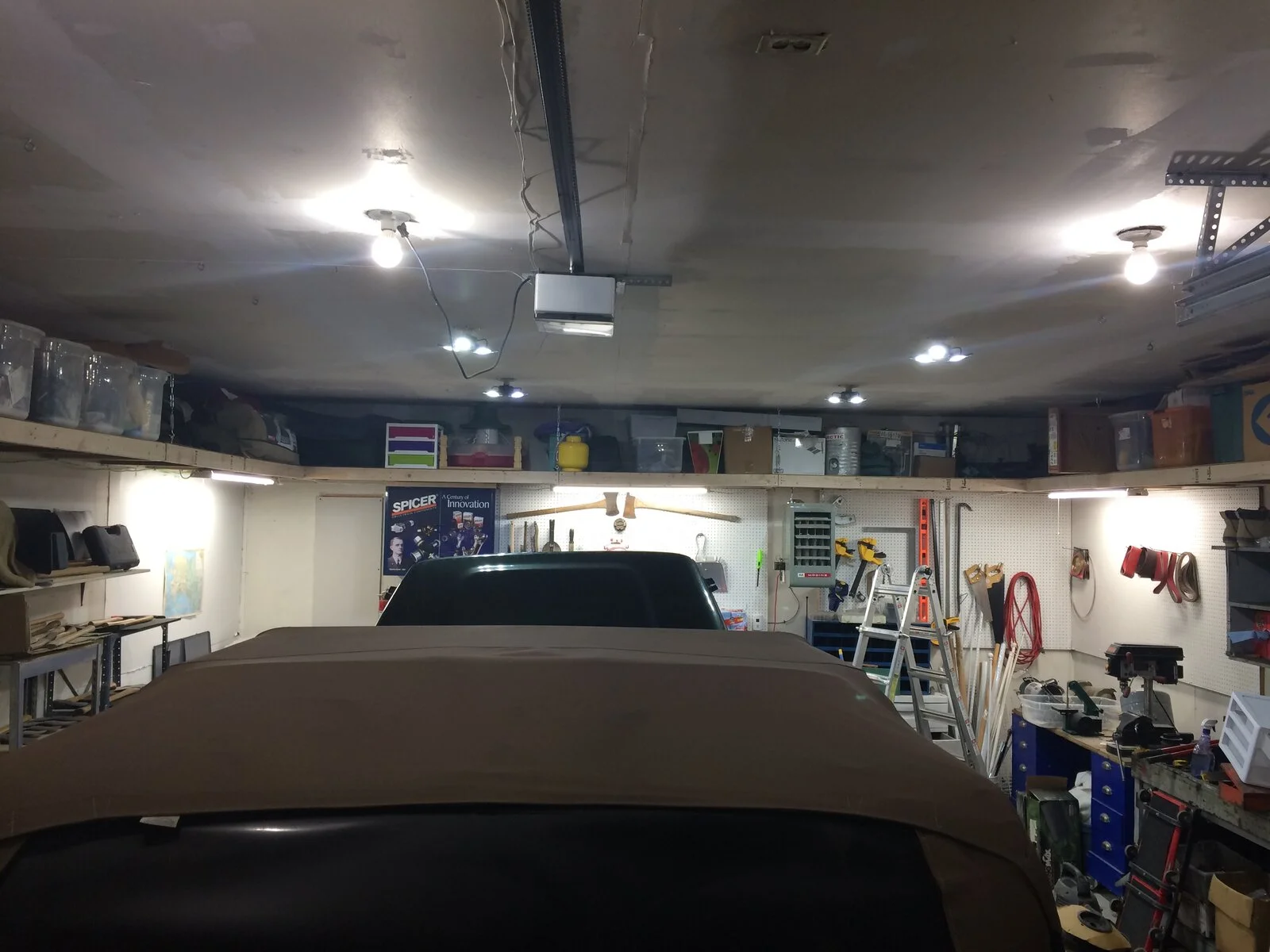

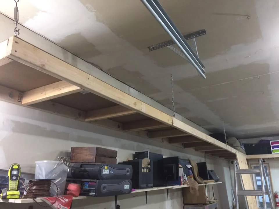

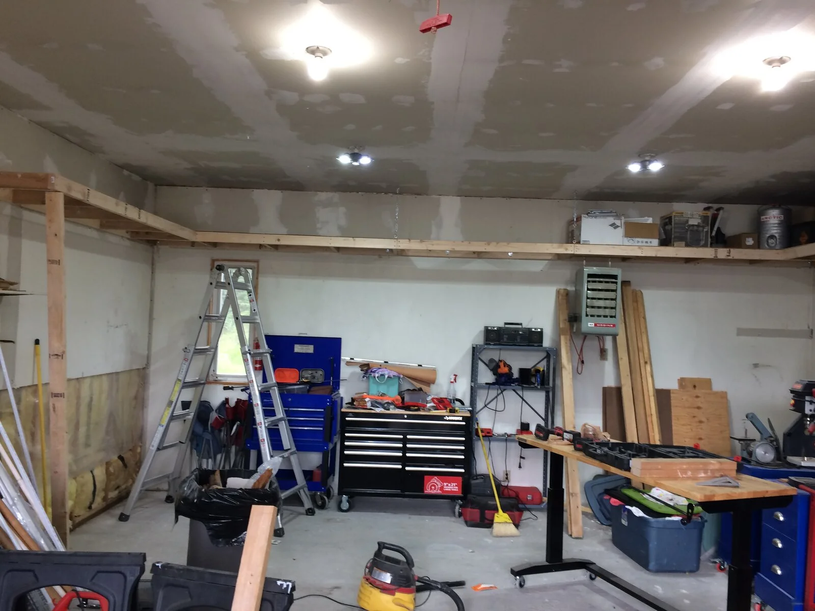

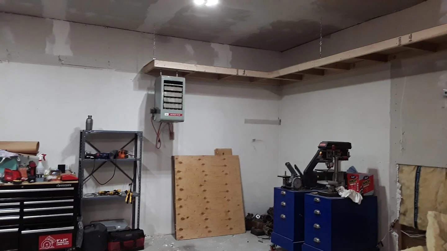

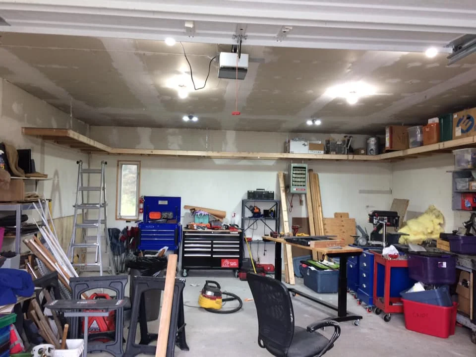

One of the challenges was this summer was a fairly wet one so that meant I was stuck moving things around many, many times rather than outside to get to whatever area I was working on. The next thing to address was storage. I needed shelving to store the usual suspects, totes of Christmas decorations, camping gear, spare parts and equipment for repairs on the house and the like. What I decided on was an overhead shelf that wrapped two thirds of the shop walls. It is constructed of 2x4 boxes that are screwed and lag bolted to the wall studs and uses lag eyes, chain and turnbuckles tied into the ceiling joists.

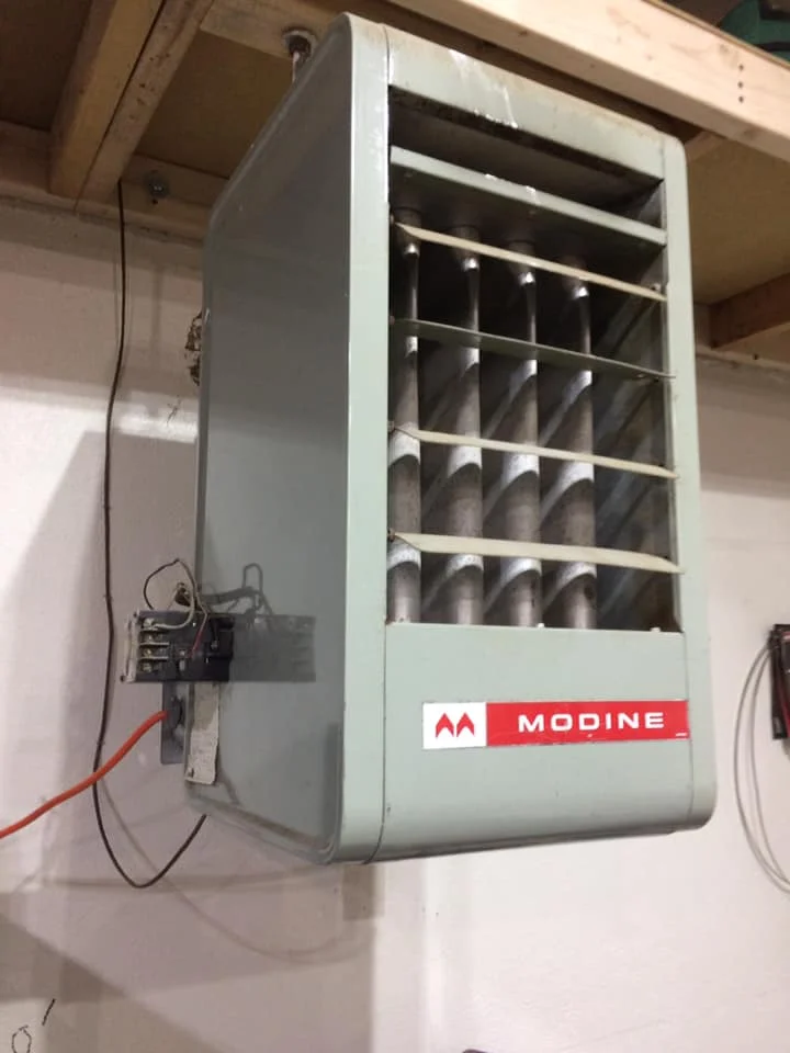

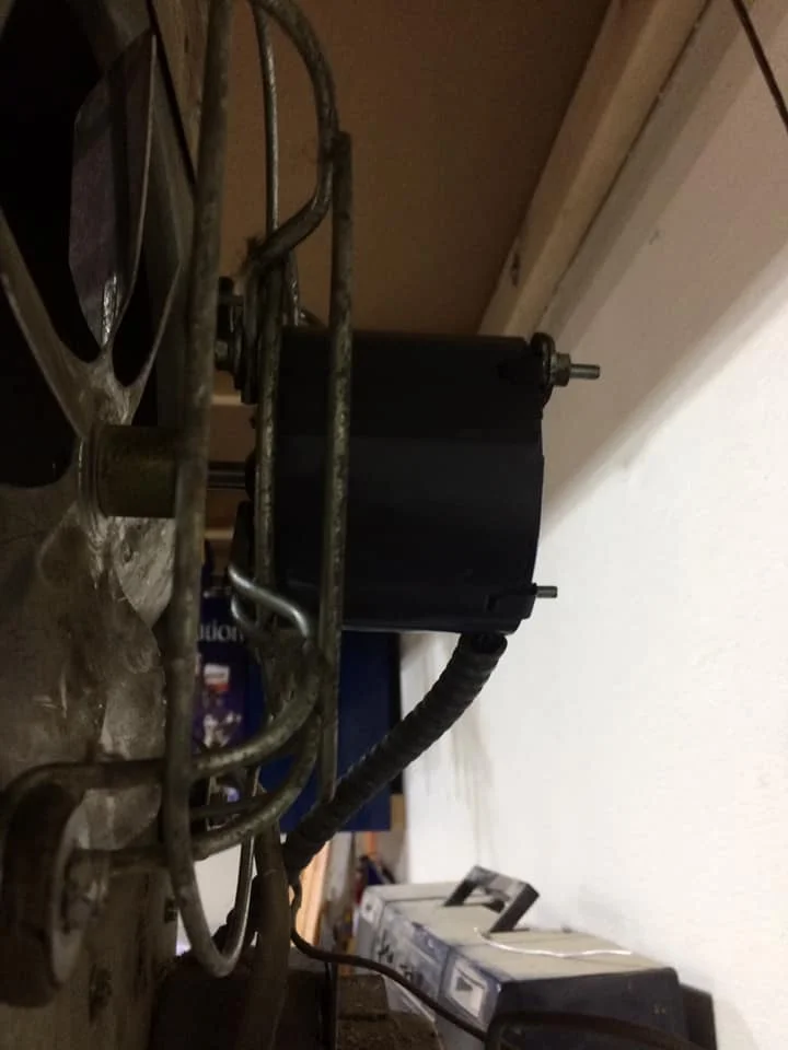

With the shelving up I could now work on getting stuff off of the floor making room for workshop type things. One thing the shelf did was give me a place to secure the Modine since it was attached to the ceiling of the added in room I removed. I figured out all it needed to be pressed back into service was a new fan motor, a thermostat along with a cleaning. It is almost too small at 30k BTU but so far it has worked pretty good. The real test will come in late Jan-Feb when temps dip in the negative double digits. I leave it set at 46f when I am not working in there to keep stuff from freezing.

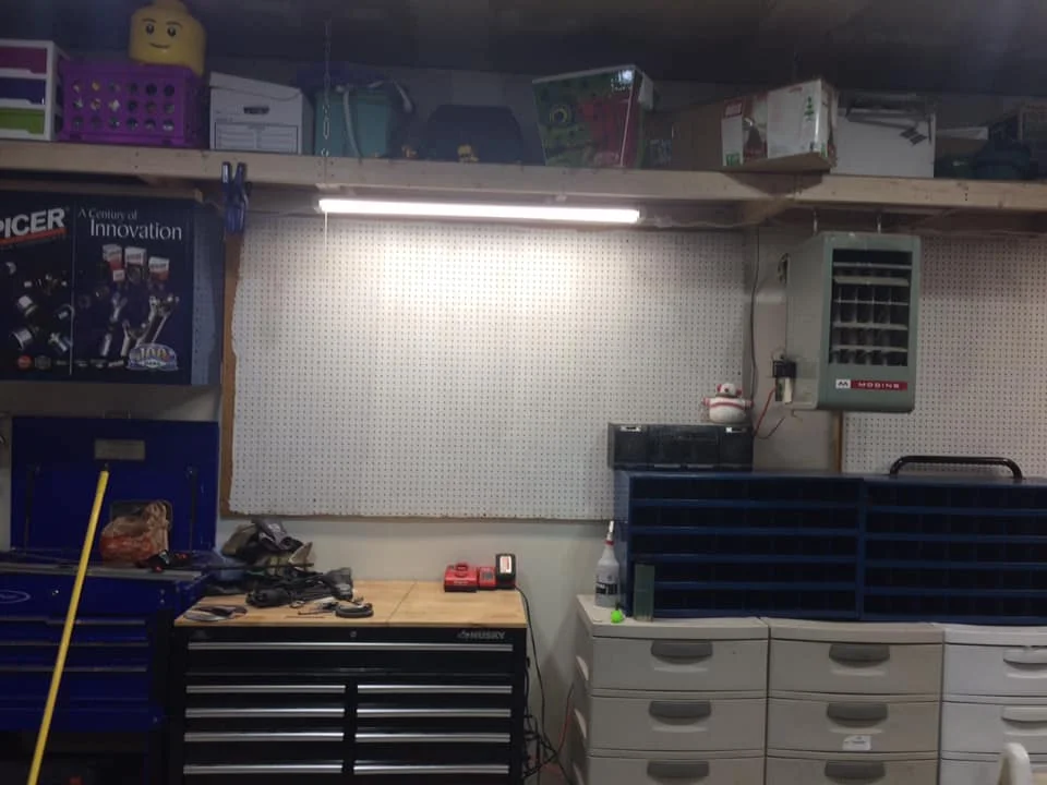

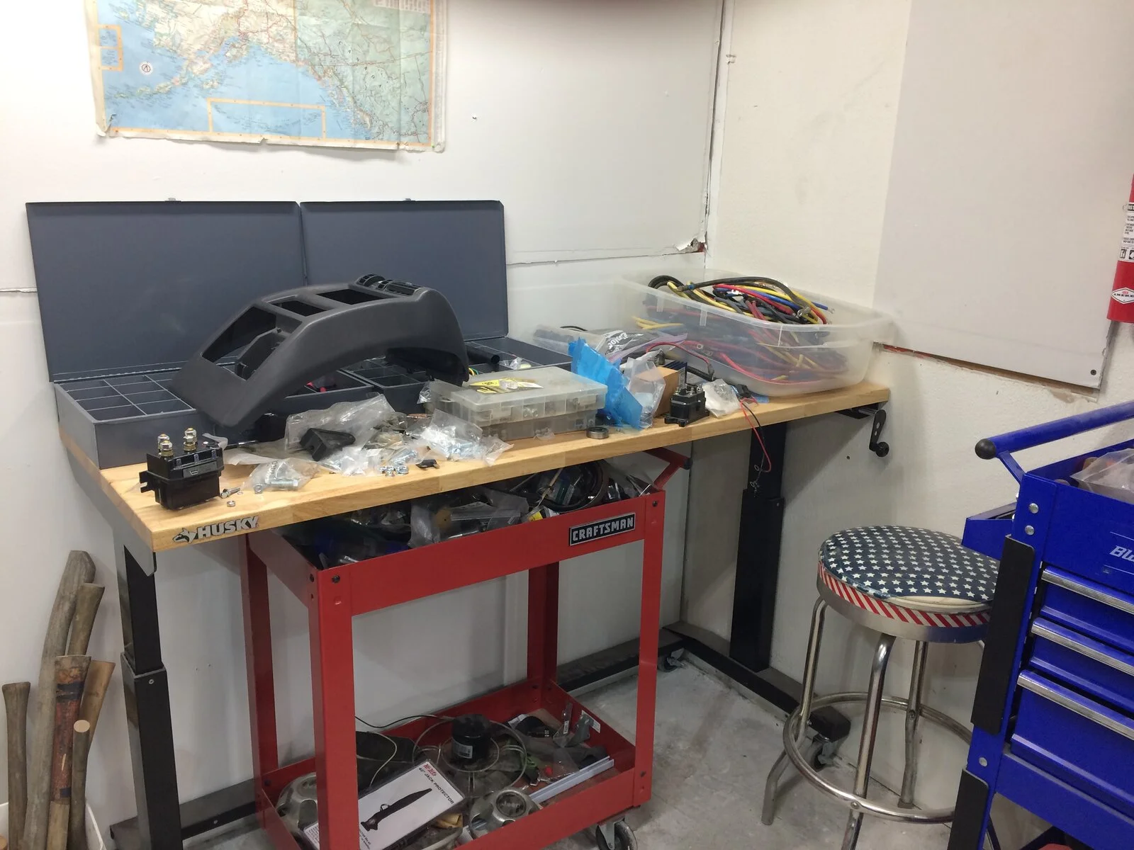

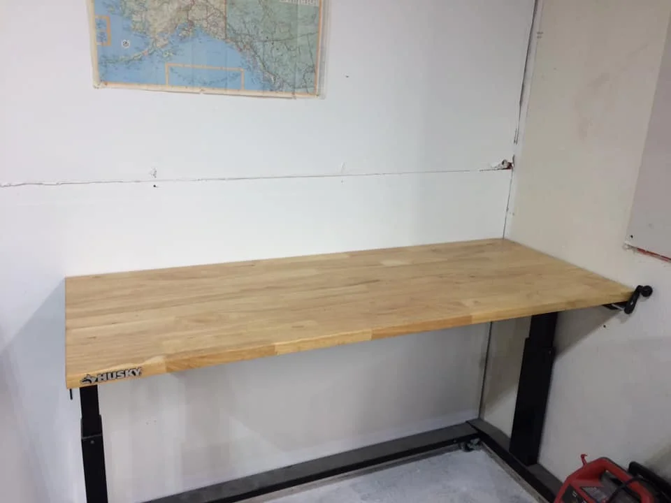

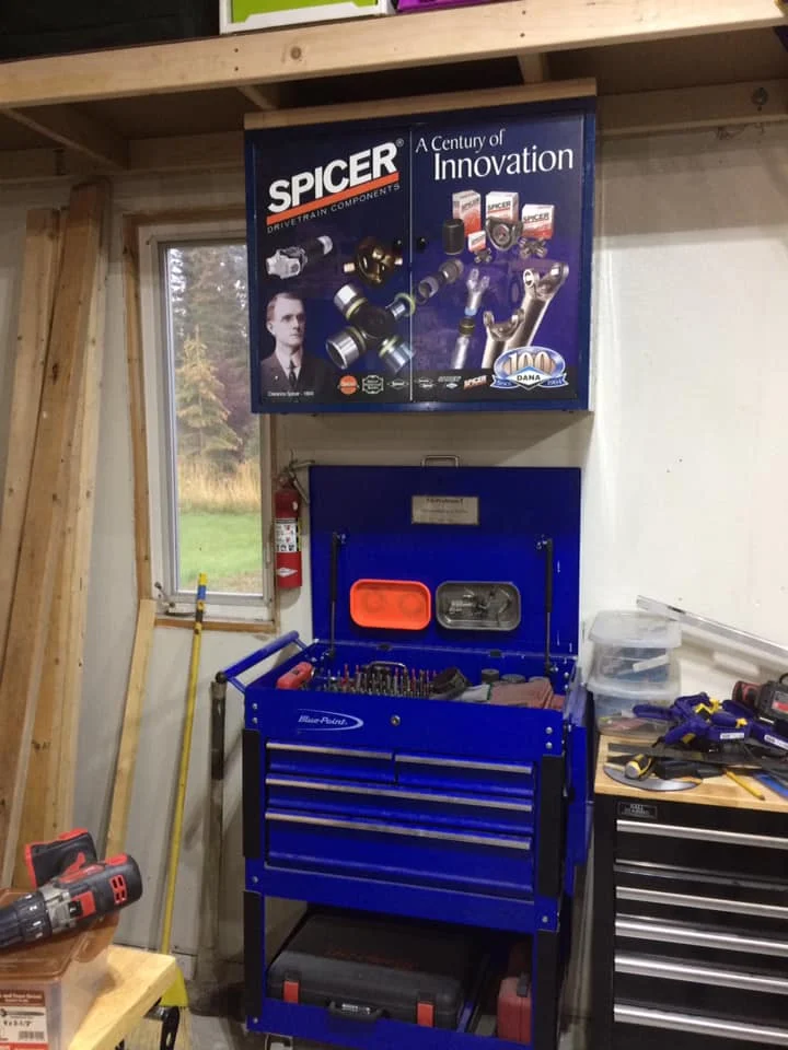

Next up is figuring out some kind of useful layout for tools and benches. I started with my roll cart and a cabinet that I am going to use for storing automotive type tools and stuff like electrical, testing tools etc. To the right of it is a Husky cart that will house other hand tools, a junk drawer for tubes of silicone and the like. On the left wall for now is a Husky adjustable height rolling table the wife got for me. I was not sure about it at first but it has proven itself to be quite useful. Under it will be where my small roll cart will store.

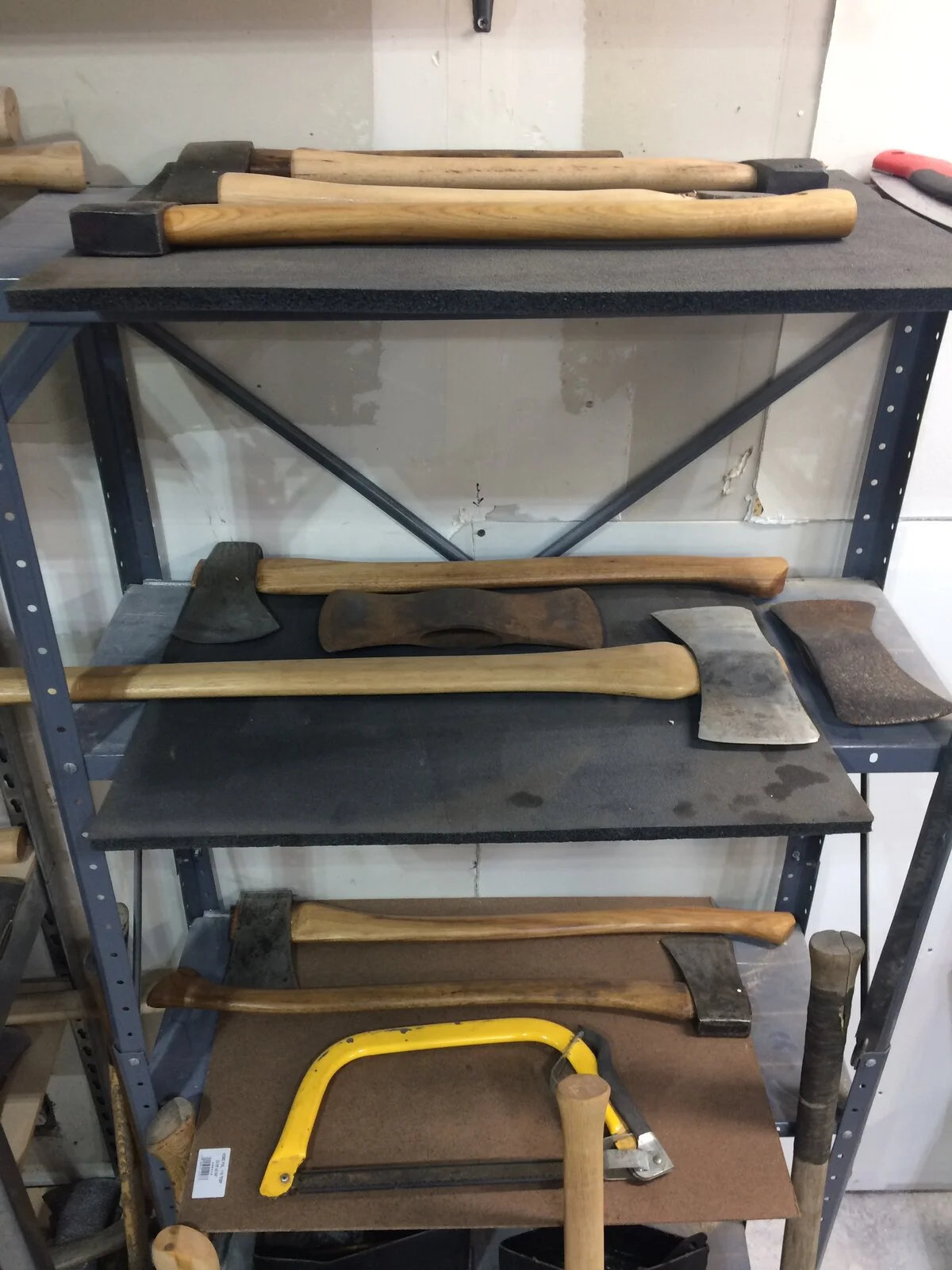

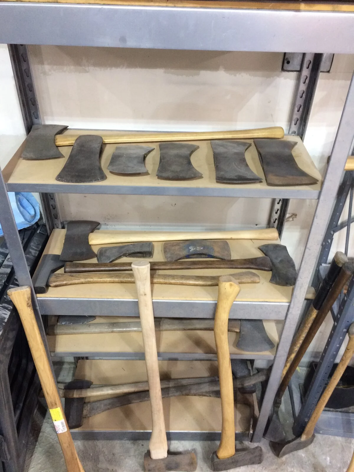

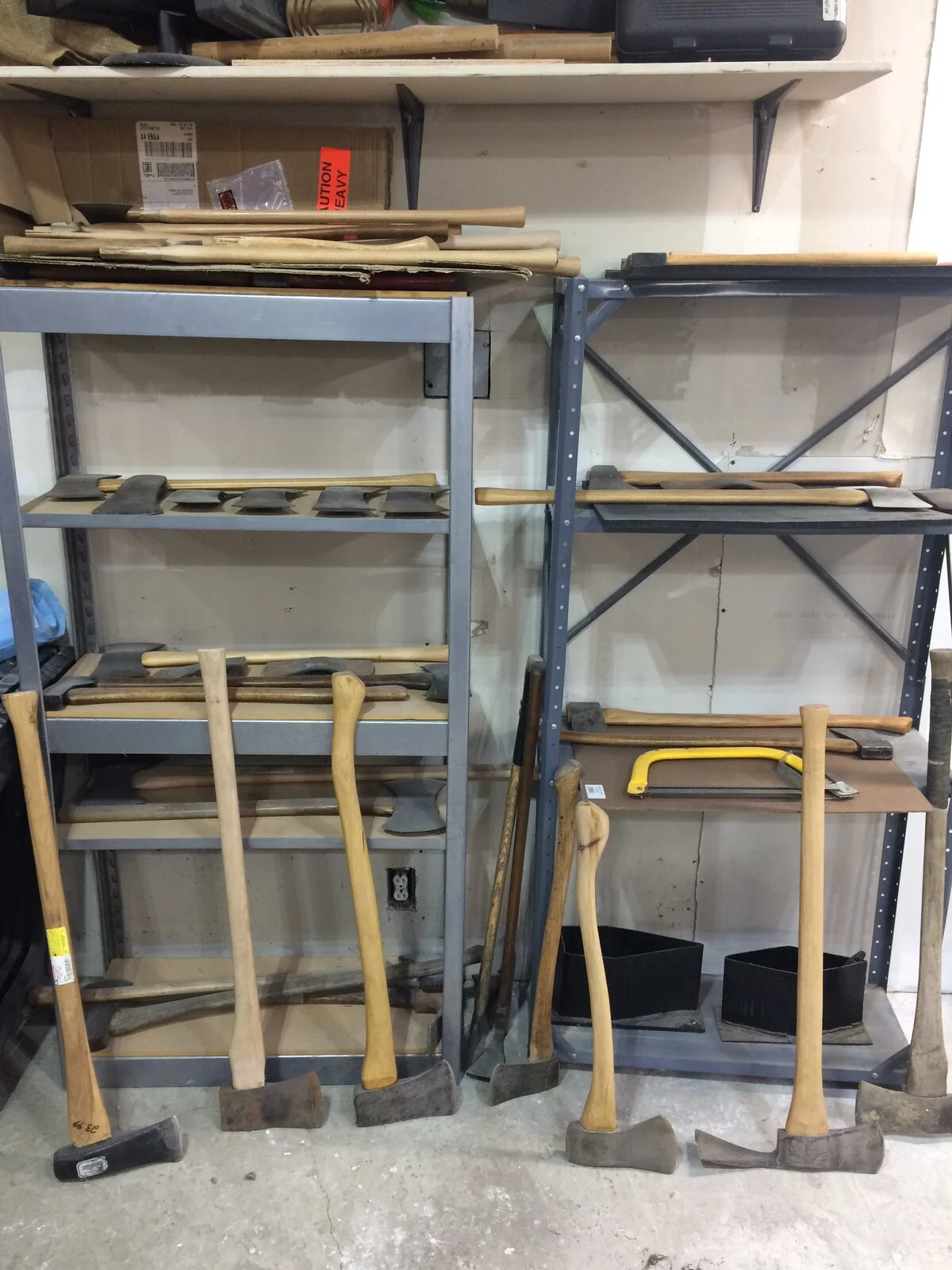

Since axes were mentioned by @qslim I will jump ahead and show you the somewhat sad state of storage my collection is in at the moment. A proper axe rack is on the list of projects to accomplish this winter if the price of lumber comes down some.

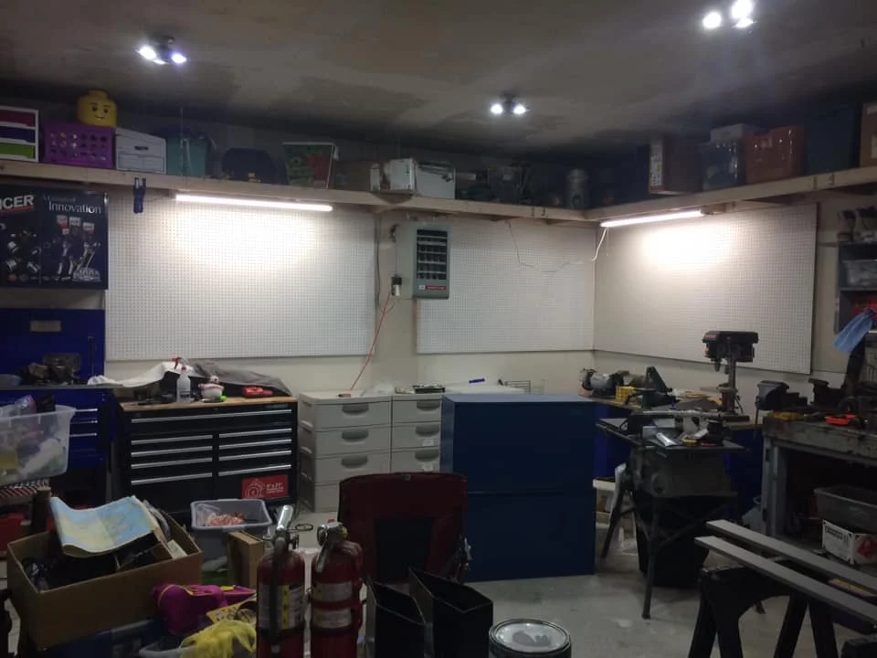

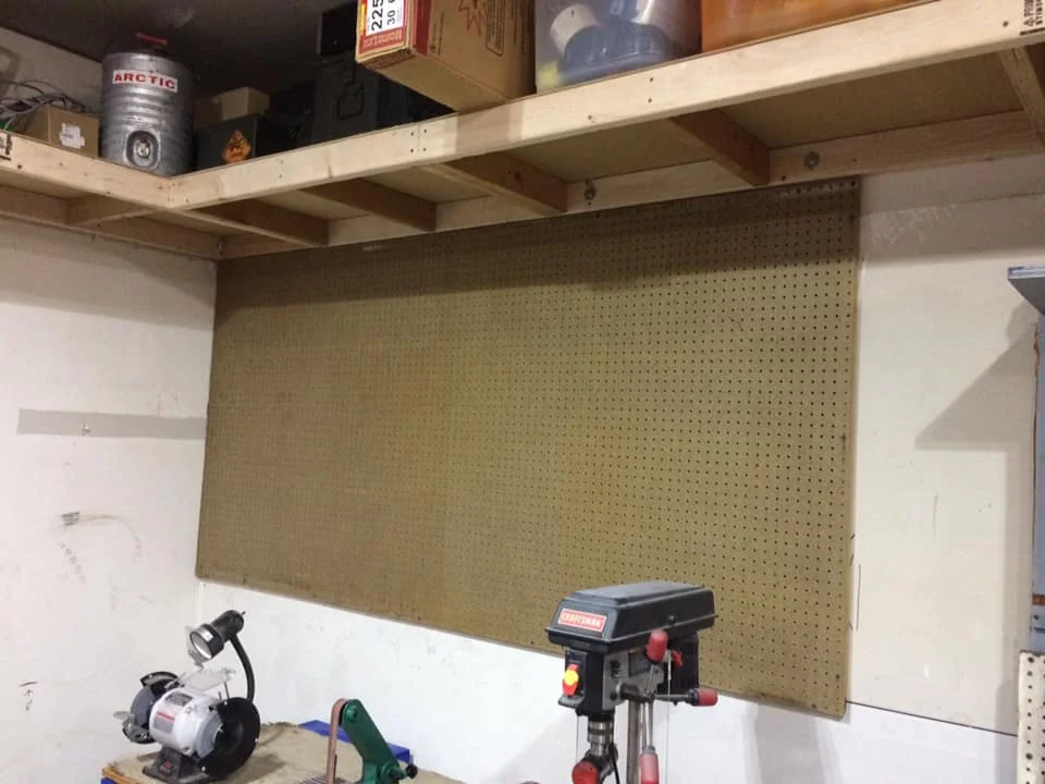

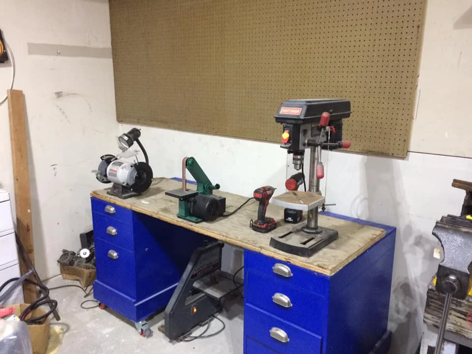

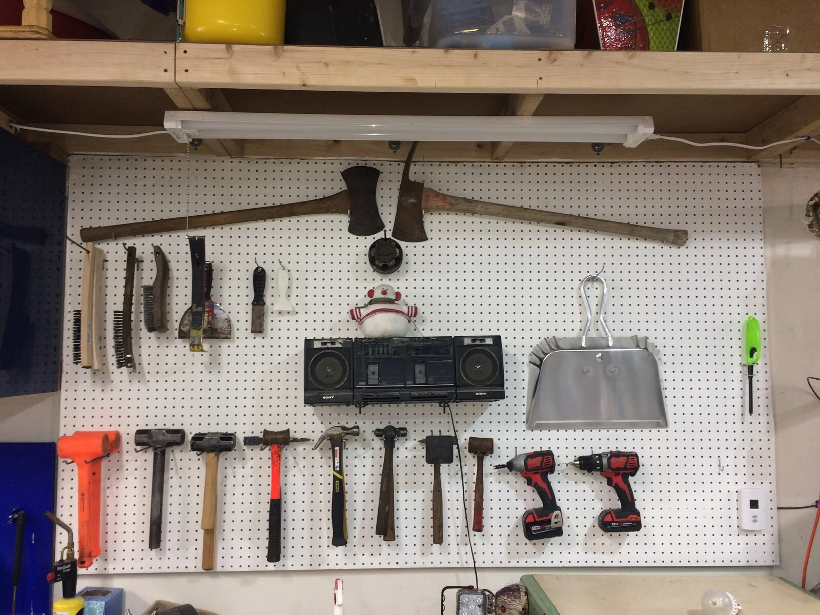

Next up was peg board. I had to scrounge for this because the current offering at Home Despot is garbage. But I was able to find three sheets of good board, make frames out of 1x2 and hang them up. The right corner of the shop I am thinking where I want my benches for machine tools, bolt bins and part storage. Unfortuately by the time I was ready to start this the price of lumber skyrocketed up here so for the moment we will improvise. I need room for a drill press, 1x30 belt grinder, two bench grinders and a bench top band saw. So I had an old desk that I had made into rolling stands that I just added a scrap of 5/4 ply and some plastic dressers to make do for now.

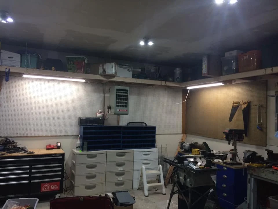

So fall had set in and it was cold and wet, So lighting and a quick coat of white on the peg board was next. The shop had nine ceramic fixtures, eight on the ceiling and one by the man door. So four of the ceiling and the door fixture have 100 watt LED bulbs. The other four fixtures have those winged LEDs from Home Depot. Under the overhead shelf at the rear I added three four foot LEDs. This works pretty good so far but I will play with this some more over the winter and see what I like and don't. Lighting is all too important but technology has not only made lighting more affordable, but the amount of light for watts consumed has changed everything. I have only two circuits currently in the shop so the amount of lumens I can put in there now without even taxing the circuit is amazing.

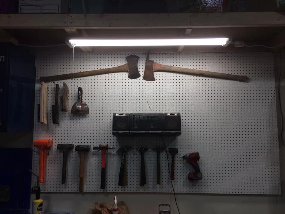

And we cannot forget the all important wall art. My only two wall hanger axes a Marshall Wells Hand Made double bit, a retired USFS Pulaski and a vintage Warn Jeep locking hub. And a Jeep outhouse poster because Alaska.

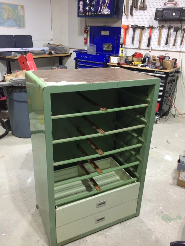

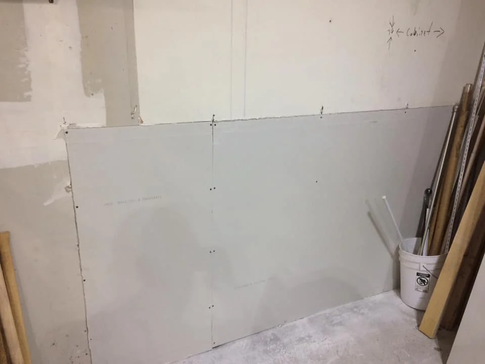

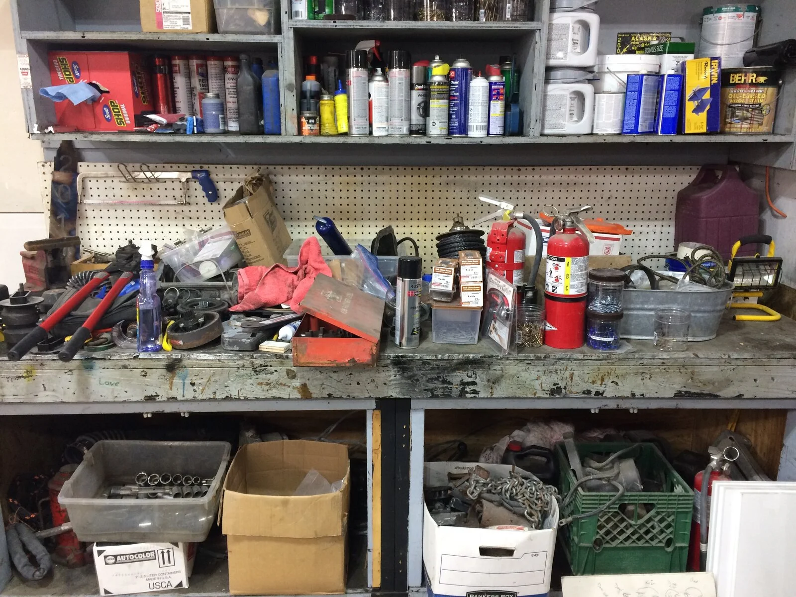

The wife found me an old military dresser for a few dollars and I found a 3x8 foot sheet metal topped work bench for (insert monster garage voice here) zip, zero, zilch, nada. The workbench is not exactly what I want but it will work just fine until I can get the time and funds to change it. When warmer weather comes this summer they will get some paint and put in their (mostly) permanent place.
