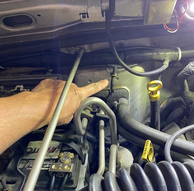

I started at what i believe is the easiest point to begin diagnosing hte issue and that is at teh T fitting in front of the firewall next to the AC hoses, here:
When I disconnected the fitting where indicated by my finger, there was a significant amount of vacuum present in the line, so I don't think a leak is the issue.
