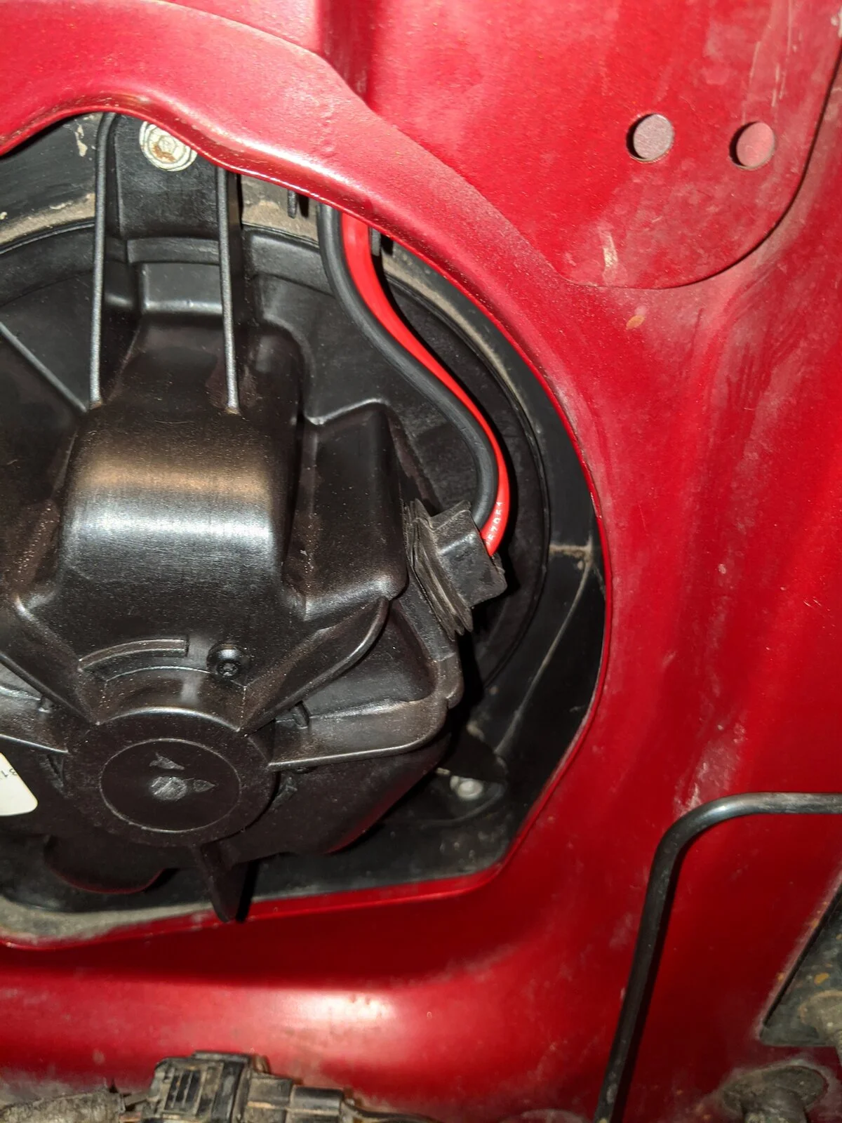

Does anyone know where the two wires (positive and negative) exit the firewall to go to the blower motor?
The ones I am asking about are the ones that connect directly to the blower motor. It seems like they pass above the heater box but I lose them there. Thinking of redoing the negative from my relay setup and then bringing a positive direct from the battery with some larger gauge wire (8 or 10 gauge)

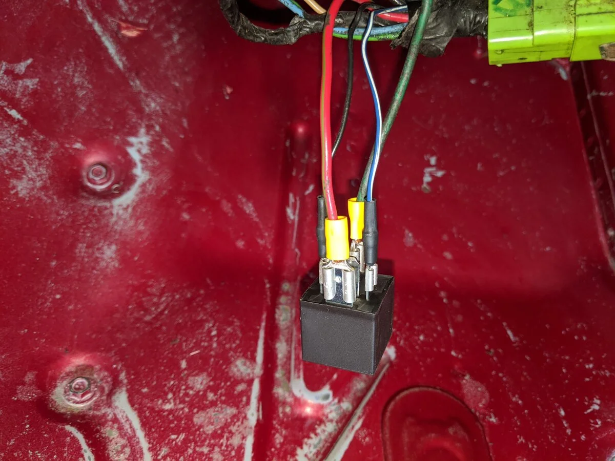

I'm still chasing hot wires at the positive relay and have rewired it with a 80/60 amp relay. This made it better but the relays and wire connections are still pretty warm to the touch.

It doesn't really exit the firewall. It comes down between the heater case and the firewall. The blower motor sets back a little from the firewall. The wires come down on the interior side of the firewall.
Thanks @GEEP4ME that is gonna make it much easier. Do you know if you can buy a connector for the blower motor? I haven't been able to figure out if anyone sells one. If not, I guess some spade terminals would work.
I don't believe there is one. I think you have to replace the harness, or find a used one to splice in.

I just went and checked my connections to the 12v+ relay, super tight and the relay even has .375" spade connectors on it.

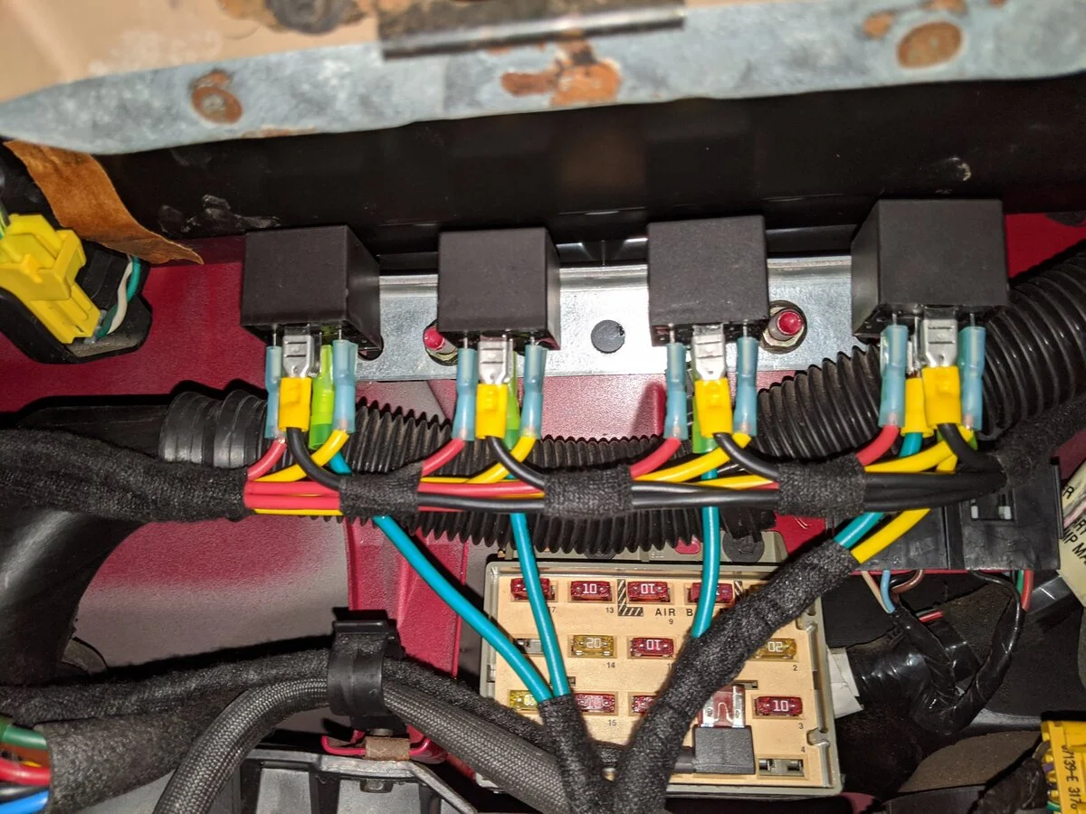

Btw- here is a pic of my relay setup on the ground side of the circuit
Reactions: TJ Hunnicutt

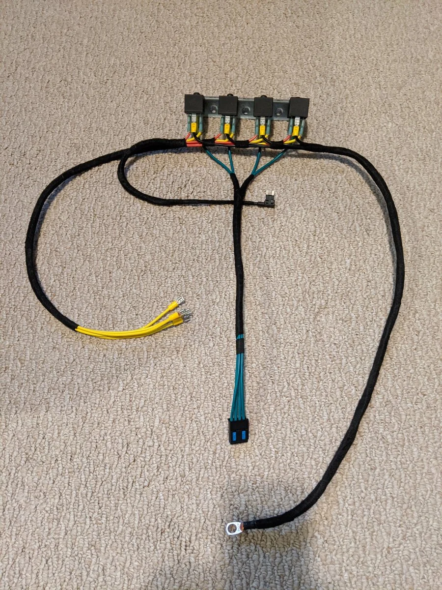

I have essentially replaced 90% of the wiring for the blower motor circuit.
For the 12v+, I ran a 10 gauge wire from the fuse box thru a new fuse and directly to the relay behind the glove box. I used a 70 Amp relay made by Song Chuan that I bought from Mouser Electric. I then wired a new 10 gauge final lead to the new Mopar Blower Motor.
For the 12v- side, I also swapped out the 40amp Online LED Store Amazon relays for some 50 Amp Song Chuan relays (also from Mouser) and a new 10 gauge negative wire from my relays to the blower motor.
This has solved my wiring issues. Relays and wire no longer get hot and everything seems to be working perfectly.
Key to the relay mod. Use high quality relays rated for continuous use and replace the old tired wiring with some quality pure copper wire. I was seeing about a 4 volt drop at the motor before replacing wiring and now I am seeing about a 0.2 volt drop.
