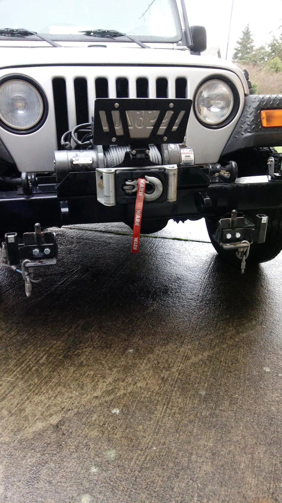

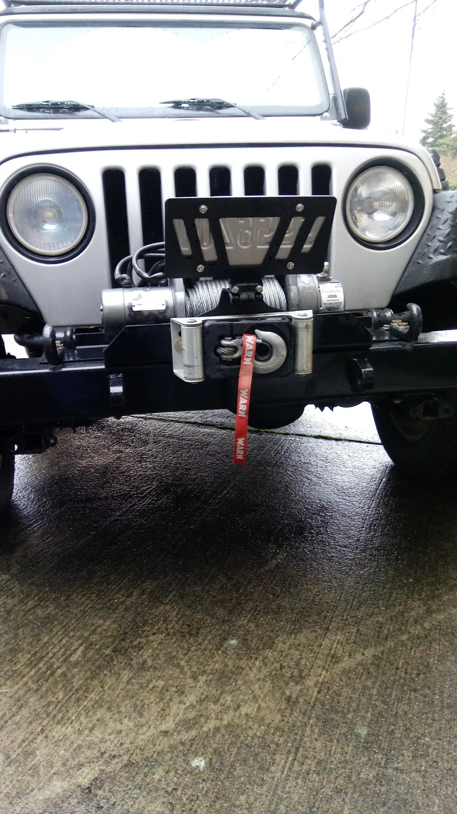

Here is a picture of my jeep with the permanent brackets installed. While they are always there the only way to really do any damage is to take a header into an obstacle. The only real issue is that you can't install a power steering guard.

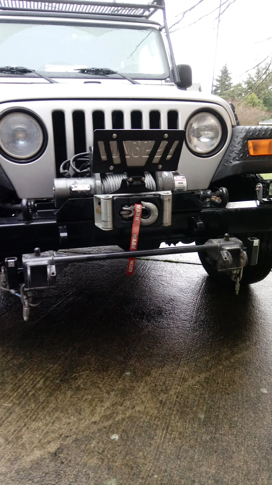

Here are the insert brackets that hold the crossbar for attaching the tow bar.

And here is the complete set up with the crossbar.
