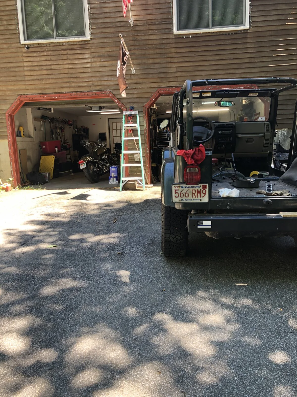

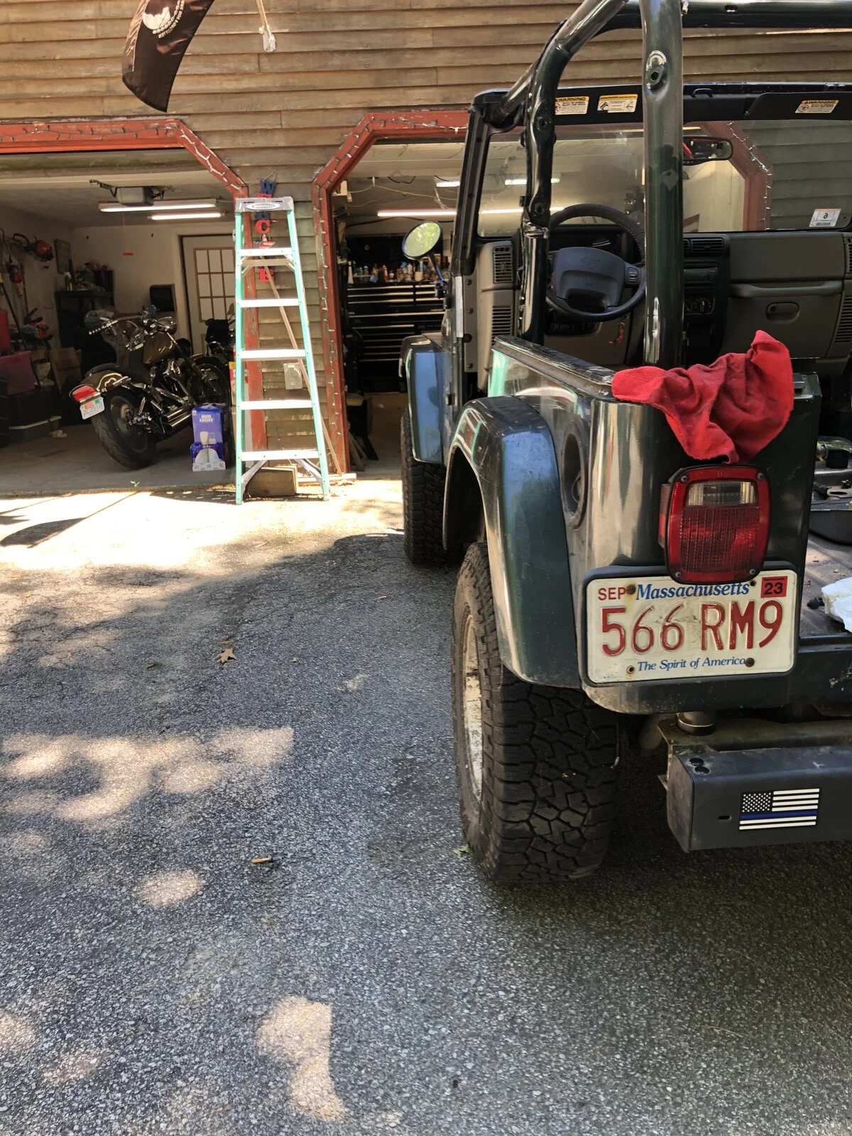

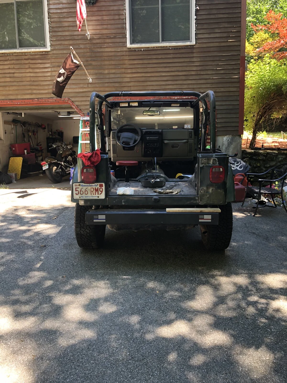

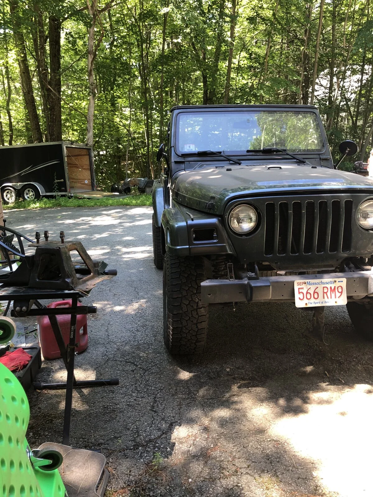

Well, I’ve got it as close to straight as humanly possible….
I finally was able to pull it out of the garage and ready to power wash and body work before lining it…
Still a few little things to wrap up before that, but a big step just getting it moved 😉
Still need to cut the bumper or get a new one depending on MA regs…
Heading in the right direction now 😜😀
P man
Keister Bunny
Apr 11, 2021
2,315
Washougal Wa
Dude for as much repair work as you have done that looks fine..just go enjoy the jeep and quit worrying over body alignment.
