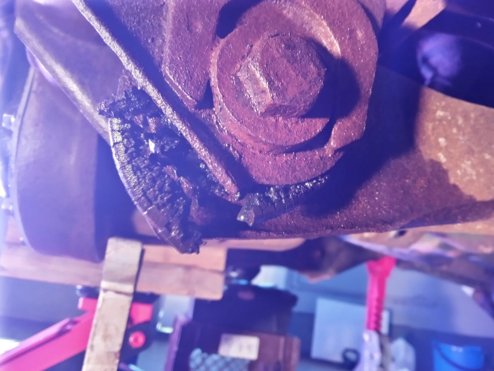

I havent even started work yet and they look terrible

If that's your actual control arm then be prepared with new arms and hardware as I'll pretty much guarantee the bolts and bushing sleeves have bonded into one. That way you only have to cut it free and drop which is a PITA project.
I have a new arm ready because I realized removing the bad bushing from the old one may not be practical. The new one is a MOOG control arm I got for 25 bucks. I thought I had all the appropriate hardware but I misunderstood alot about the difference between early tj and later model bolts. I thought the later ones like my 2006 still had Cam bolts but that they were centered or non adjustable.
