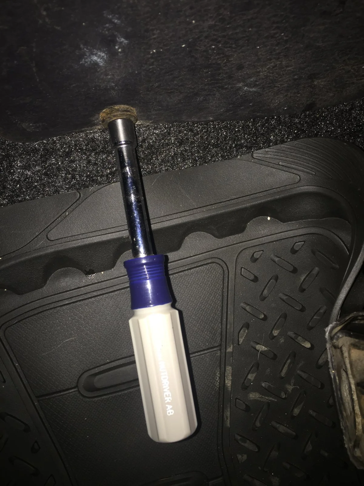

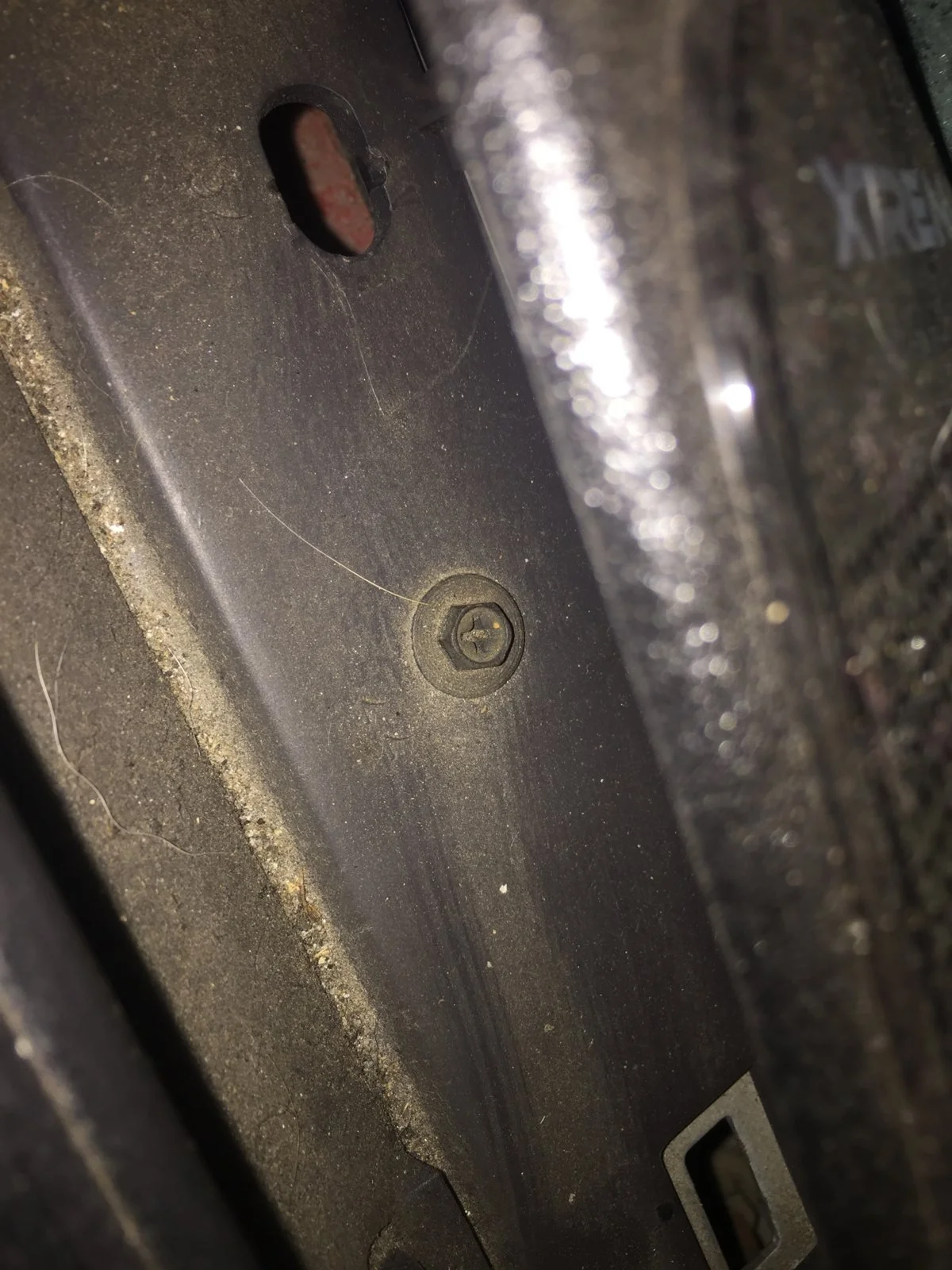

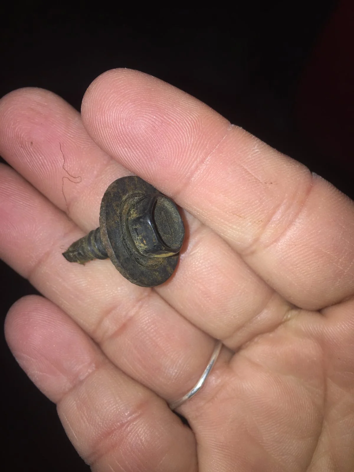

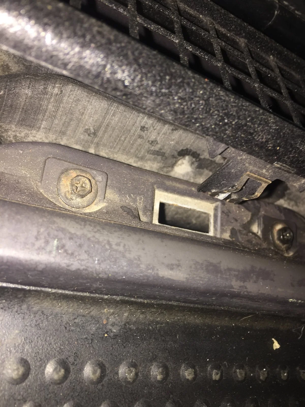

I have a 2000 sport. 10 mm is mine by passenger horizontal. I’m not positive what fasteners or screws you were talking about by the windshield but here are a couple pictures. I didn’t have time to dig more. Let me know if I can help anymore tonight
