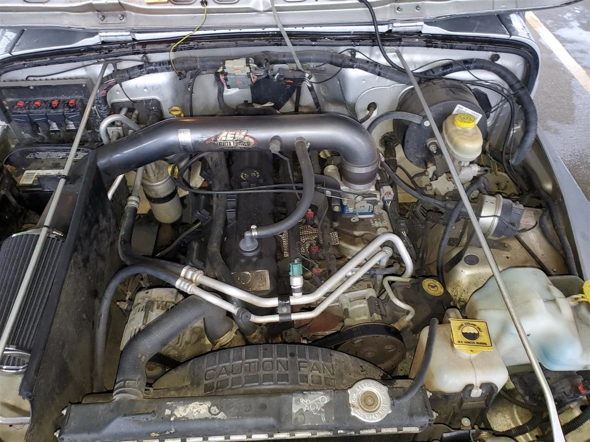

I just purchased a 2005 LJ. It is an 4.0L with auto transmission with 140K miles. It is pretty much a stock LJ. So far, I have found no rust other than a few paint chips and a few small dings.

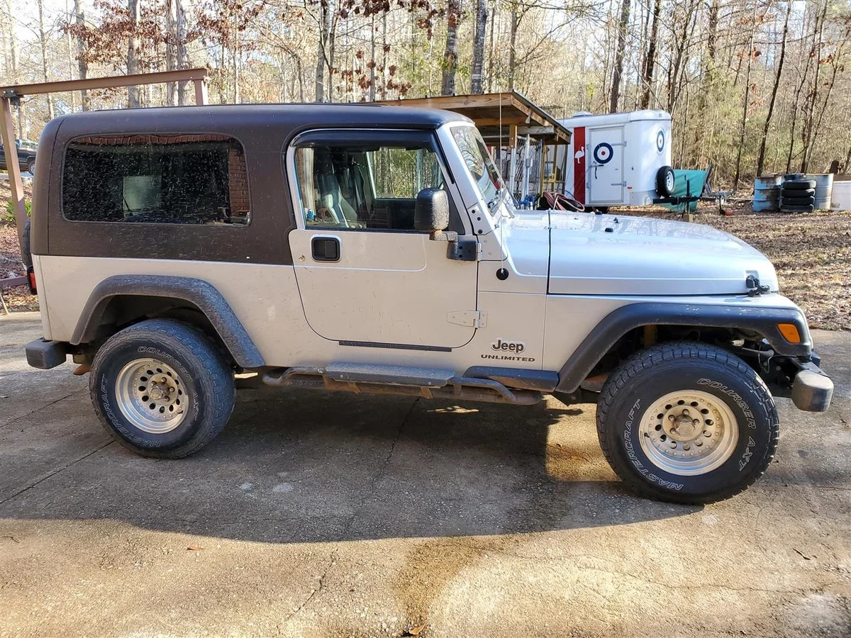

It does have a few issues that will have to be addressed. It will pop a code when cold - something about the cam sensor replacement. It has some shimmy that feels like tire shimmy and not DW. The tires need replacing and the wheels have the wrong backspace. You can see all the spray down both sides from a mud puddle. So, I plan to find some OEM wheels to get the backspace correct and install OEM tire size since I don't do hard core offroading. I hope that fixes the shimmy. I feel a little vibration at speed that may be a bearing or u-joint. Both diffs need pinion seals. I already ordered some fitted floor mats, rear window lift rods and a cheap steering stabilizer.

I'd get rid of the cold air intake and go back to the stock air box. You're not getting any better performance and the stock set up with a good filter will be better for your throttle body. It also looks like you may have a throttle body spacer. You could remove that too. It doesn't really help with these motors.

On a side note, I know those style wheels are pretty dated, but they have always been one of my favorite styles. I have a set of American Racing Outlaw II's on my '99 Silverado for the last 20 years. My brother calls them old man wheels. LOL
Thanks guys. It is a Florida, Georgia, Alabama and now back to Georgia Jeep. I will look for the intake parts and airbox thanks for the info. I try to keep my vehicles close to stock.

The wheels are not going to stay...the wife doesn't like them at all. I would keep them if they did not sling road water and debris all over the sides. But, I am going to change them and get some better tires.
