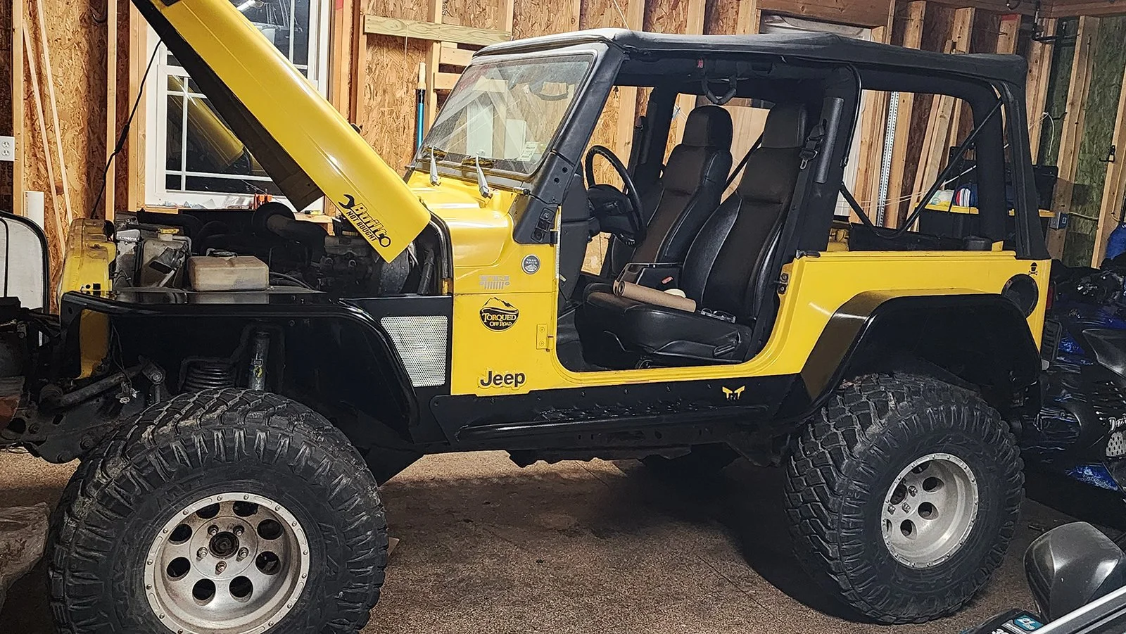

I bought this jeep last week and there is a check engine light and the code is p0501. The speedometer doesnt work and the sensor itself looks ok.
Below is the info they had posted when I bought it if it helps at all.
Thanks for any help. Like the jeep has alot done so I have no idea if they unhooked a plug under the hood, or a fuse somewhere or that!
4.0 automatic 111,xxx miles
