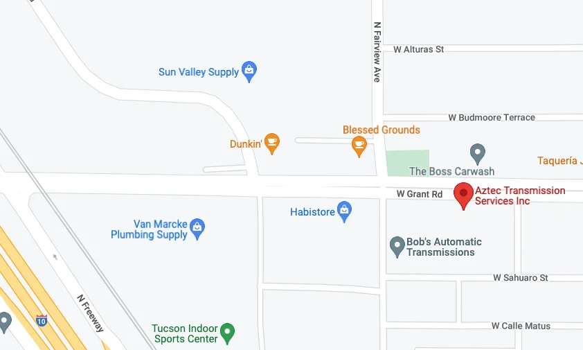

Aztec Transmissions (owner's name is Eddie).
It's a small hole-in-the-wall place and super easy to miss. If you head east on Grant (coming from I-10) make sure to look to your right as you pass Fairview. The little white building is on your right. I came from the University area (opposite way) so I headed west on Grant towards I-10 then did a U-turn at Fairview.
At some point, Eddie will be moving his shop to the nice taller blue building NE of his current location (just giving you the heads up). Pretty sure he's just waiting on the seller to move his things to the smaller blue buildings across the street.
