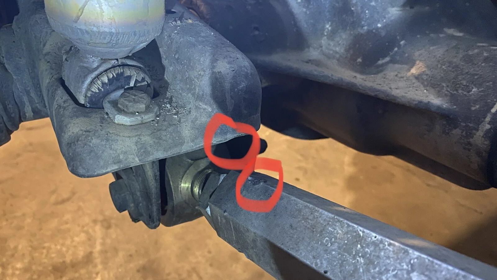

I wanted to strengthen the lower control arm mounts and was wondering if I can just use a piece of 3/16 plate and weld it in and leave about a 1/2 inch from the lca. Or should I wait and order the Currie mini skids , does the extra length and offset on the Currie skids make a difference? Or am I overthinking it?
I'd get the currie. They're offset/angled just a bit that allows them to box in the entire underside of the joint housing. Similar to the artec ones I have
Reactions: SvtLdr
x2 on waiting for the Currie skids. The offset allows the skid to weld to the axle tube. This provides more strength (3 welds) than just connecting the bracket sides to each other (2 welds).

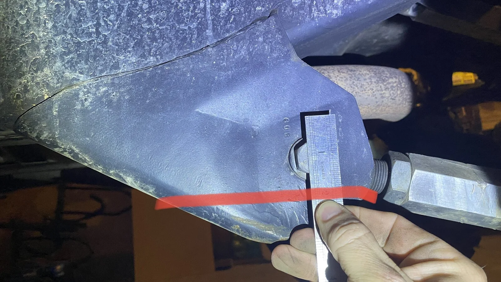

That and I want to do the 1/4" weld washers for the front lower CA's. I can't find any weld washers that are 2" OD and 9/16" ID, so I guess I am just going to make those with my rudimentary tools.

@mrblaine, I went out and measured the front lower CA for a 2” OD weld washer and it takes me all the way to the edge of the stock bracket. Are you sure you’re supposed to use a 2” OD weld washer?

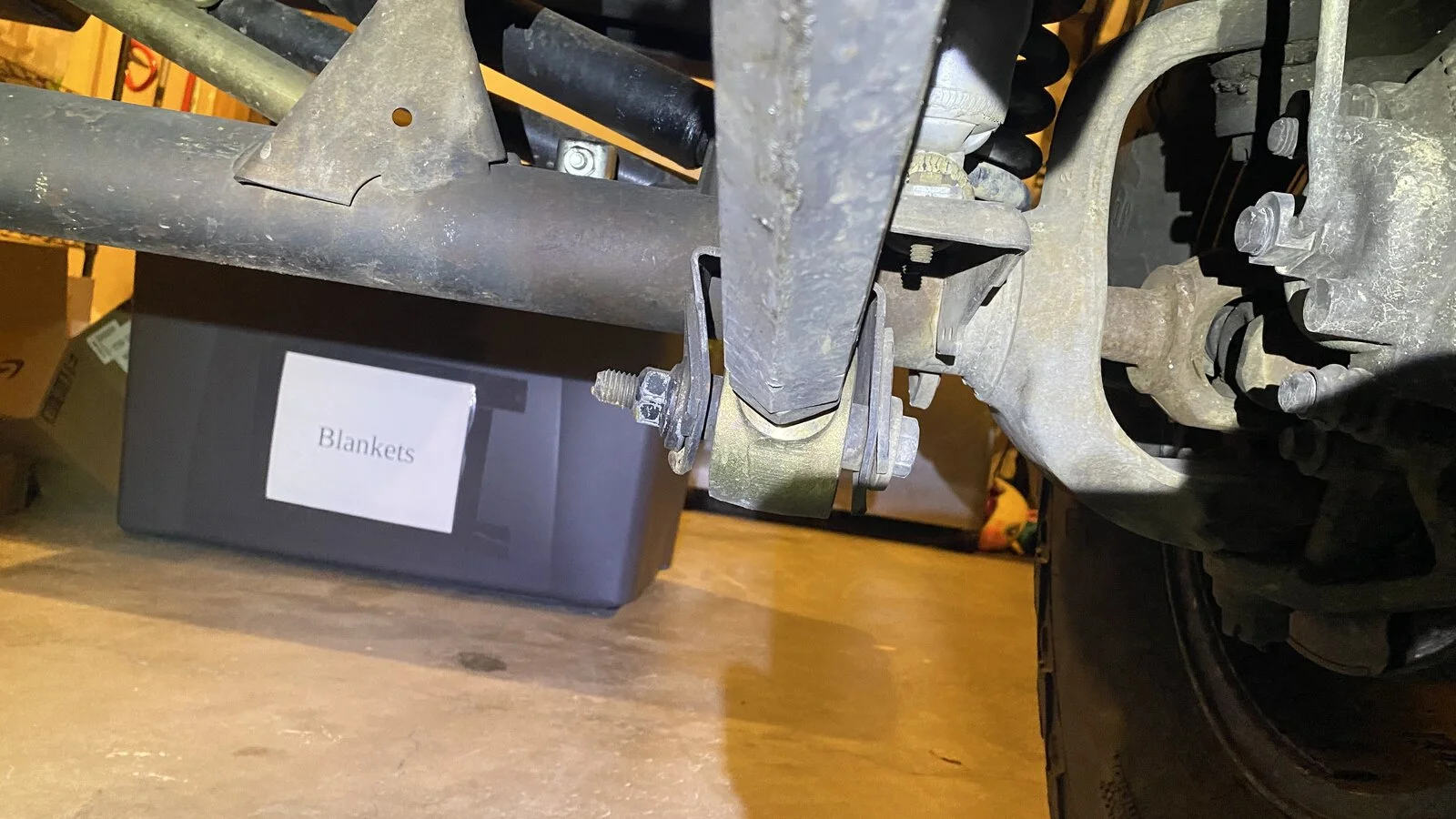

Also, it looks like I could use them on the front and rear CA frame mounts. Is it okay to cut all of that away in the pic below?

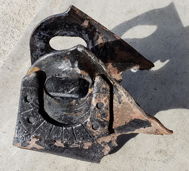

One of my front stock CA brackets is misaligned. Thus the need for mini skids before this happened. 😒
Looks like I need to trim the front shock mounts so the CA’s clear during articulation. ☹️

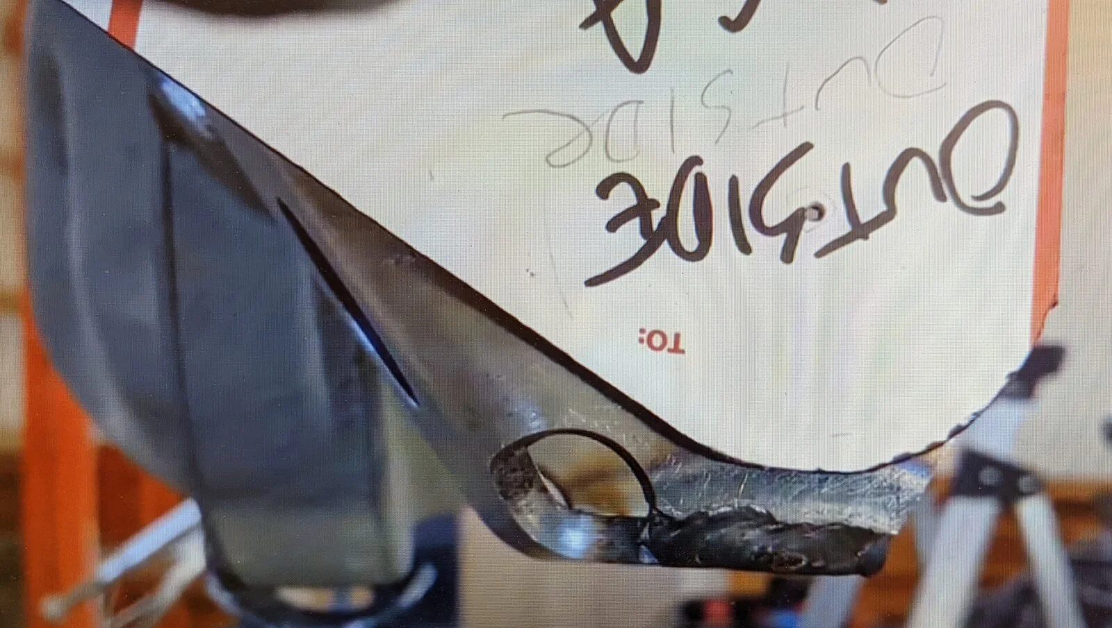

I would advise you to stay away from Artec brackets. They should be included in the hangy downy thread....
The main problem is that the angle is far steeper than stock and hangs lower than stock. I made my own 3/16" brackets that mimicked stock. The steeper angle of the Artec bracket will stop you in your tracks while the stock and similar will act more like a ramp. In the picture, the cardboard is stock.
You want the washer close to the OD of the joint body. If you want the joint body to take all the abuse, then use heavy grade 8 washers under the head of the bolt and under the nut and trim away to that without a weld washer.
That really weakens the mount. Are you sure you want that?
Yes you do.
