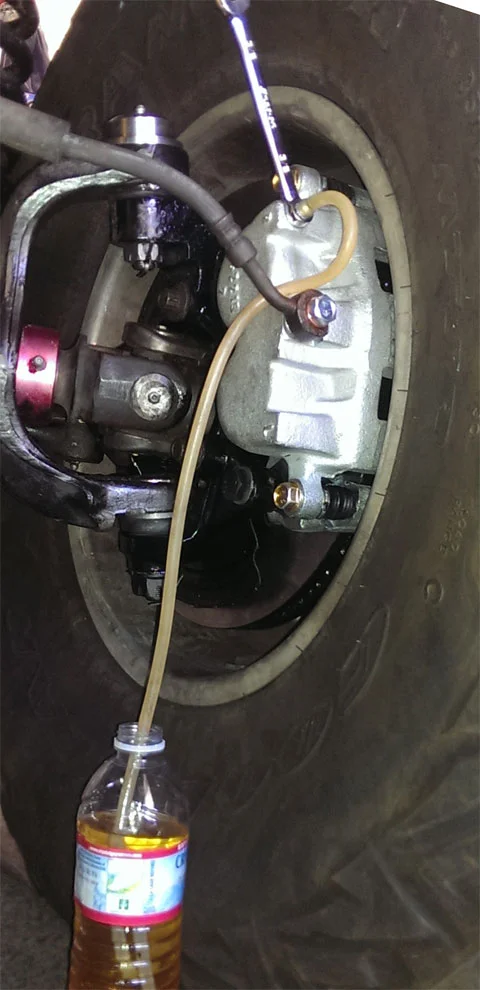

That you changed your front brake calipers makes me ask the question.... did you get the sides reversed? If you accidentally swapped the left and right side calipers you will NOT be able to get the brake lines properly bled. They will bolt into place like they belong there but that doesn't mean they can't be reversed.
If the brake line is above the bleeder port you have the sides reversed.
This shows how it looks when properly installed with the bleed port above the brake line.
