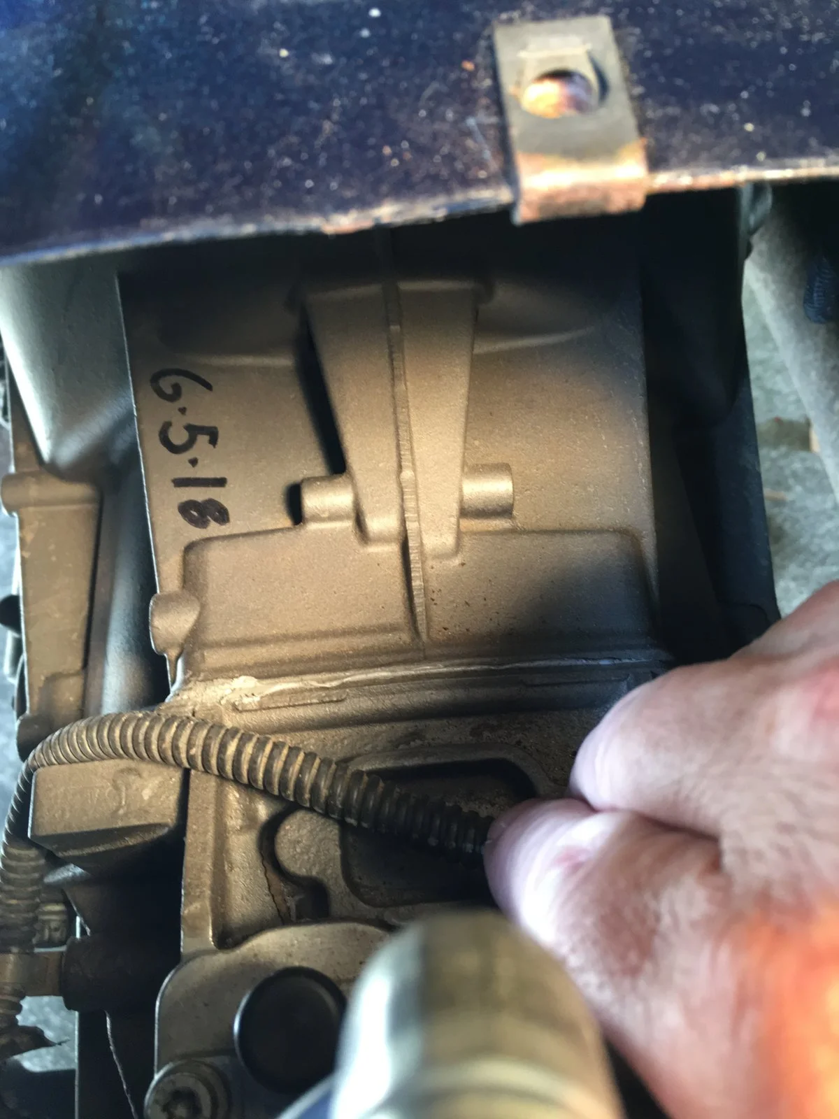

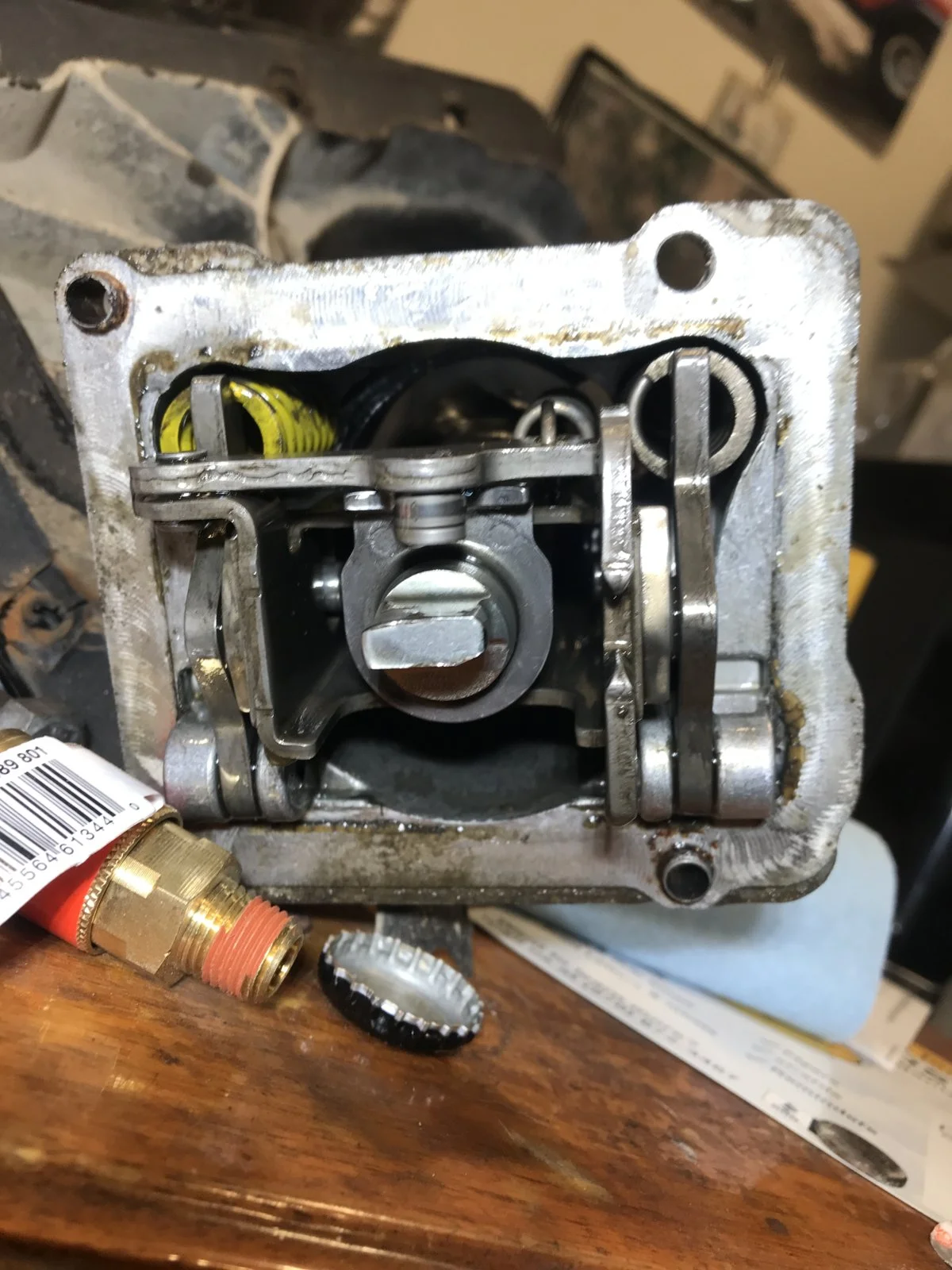

I pulled the dust boot and shifter and can shift the jeep into reverse with my hand simply pushing the shifter fork forward? There is a little more play in the reverse shifter fork direction so my shifter is an 1/16 or an 1/8 shy of getting her into gear? I have inspected both boots etc and no luck......The shifter itself does look a little beat up and Twisted??? See pictures
When I drive around normally the jeep feels great, clutch feels ok for 120k miles and all the gears are tight and precise....nothing comes out of gear?? Does anyone know if there is an adjustment of the shift assembly or is mine bent and mangled so much that reverse doesn't engage fully enough anymore...
I know the 05 is notorious for reverse problems but I am still clinging to the hope of some mod or fix...I have even thought of trying to put a bead on the shifter itself to get that 1/8??? Anyone ever tried that? It also seems hard to get into a vice without wrecking the whole unit to try and manipulate that hard steel?

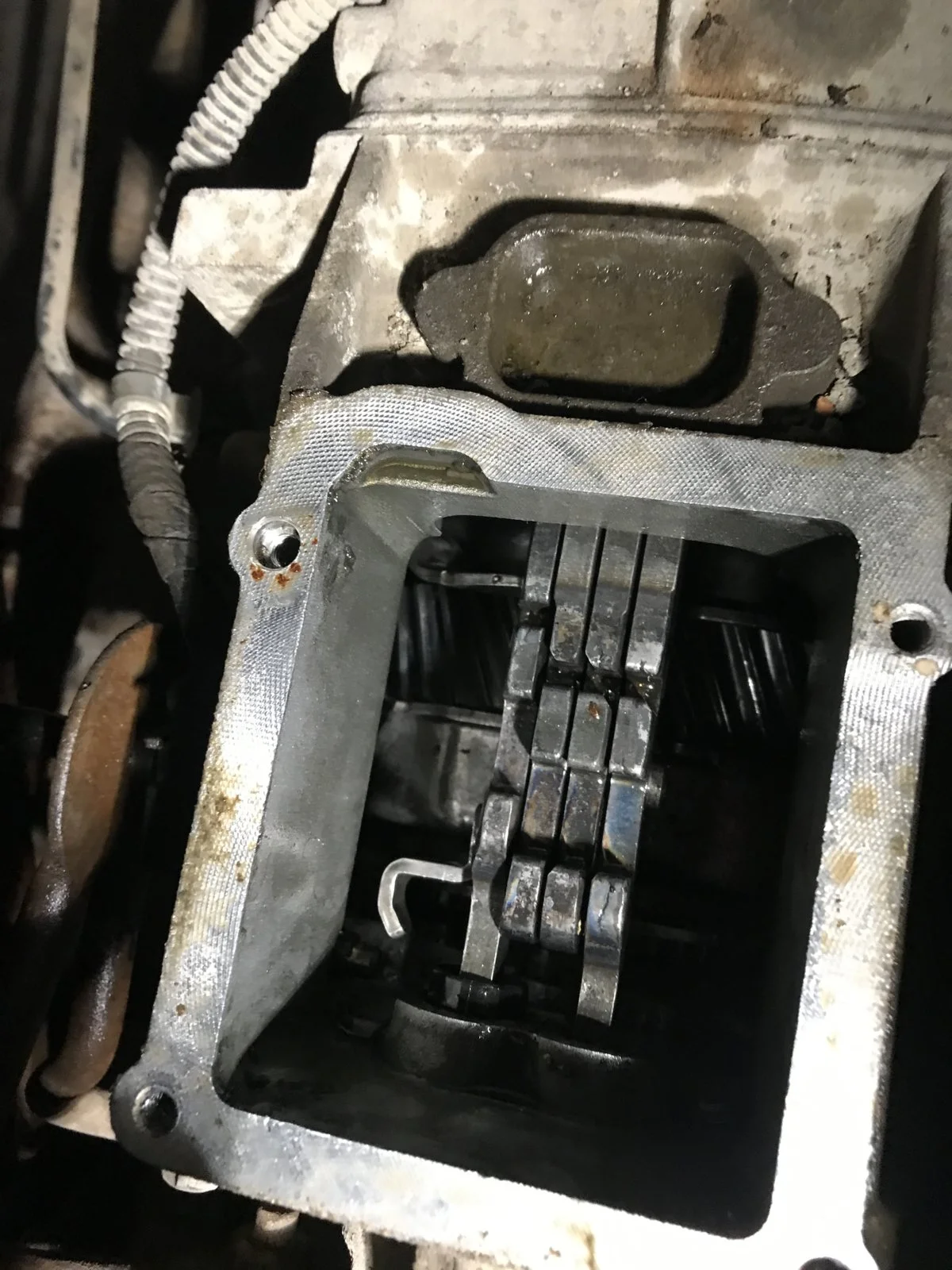

This last pic is the slop in the reverse......its the shifter fork on the left....?? Hmmmmmm
