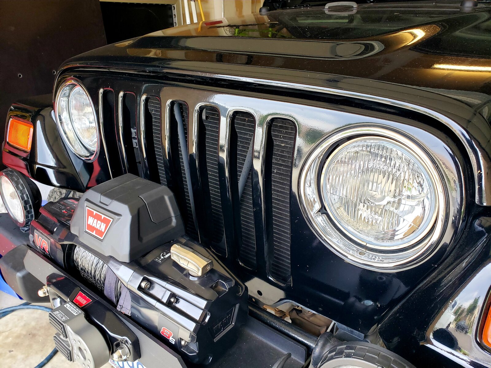

Toyota/Koito H4 conversion with HD harness to run 100/80’s Might be a great option.
DOT approved. Kit is under $50.
Once you switch to an H4 housing, you have a huge selection of 'extra bright' bulbs.
Just make sure they're aimed properly.

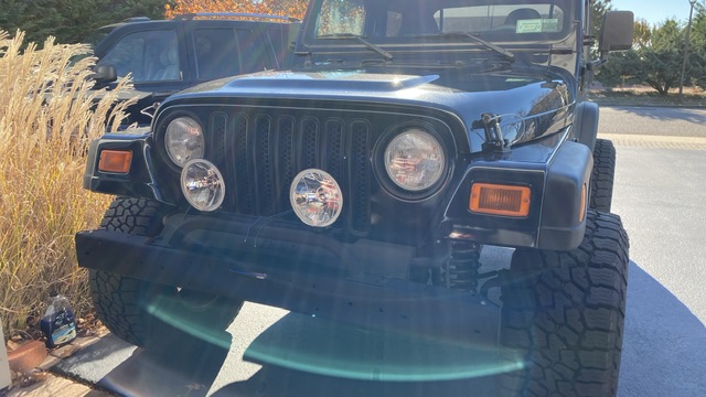

I'm running H4s with 100/ 80 watt bulbs and since they're aimed properly, never had a problem with the law, or even being flashed. You can get even brighter bulbs, 130/ 90 watt is the highest I know of, but you absolutely want the add on wire harness to run those.
I also have white fog lights with 100 watt bulbs that I use just about anywhere where the street lights are not very good. They are aligned with my headlights so that they don't blind other drivers either. Additionally, they are canted outward about 15 degrees to light up the side of the road better.

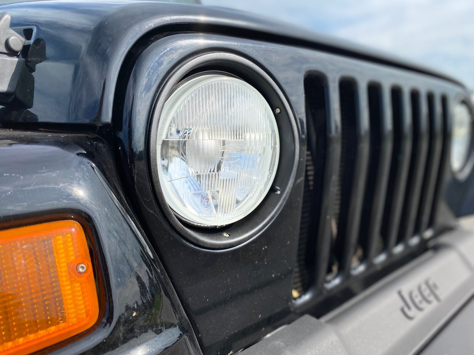

I got the Toyota upgrade, lens and harness, and the Quadratec 130/90 bulbs for like $2.49, and now I’ve soem actual headlights.
They are aimed properly and never once a flash, they still aren’t ridiculous LED’s that blast everyone’s eyeballs out if their head, not even close.
