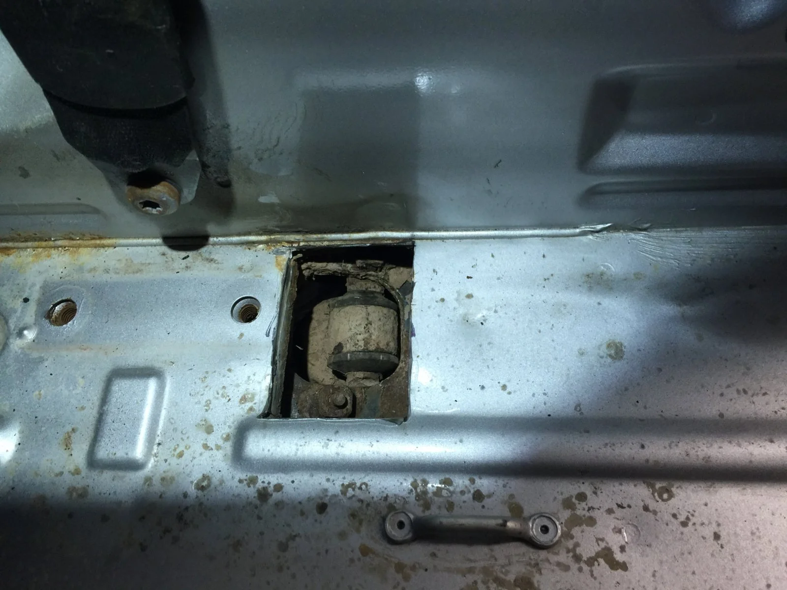

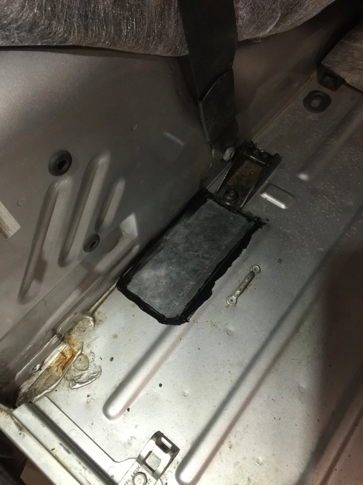

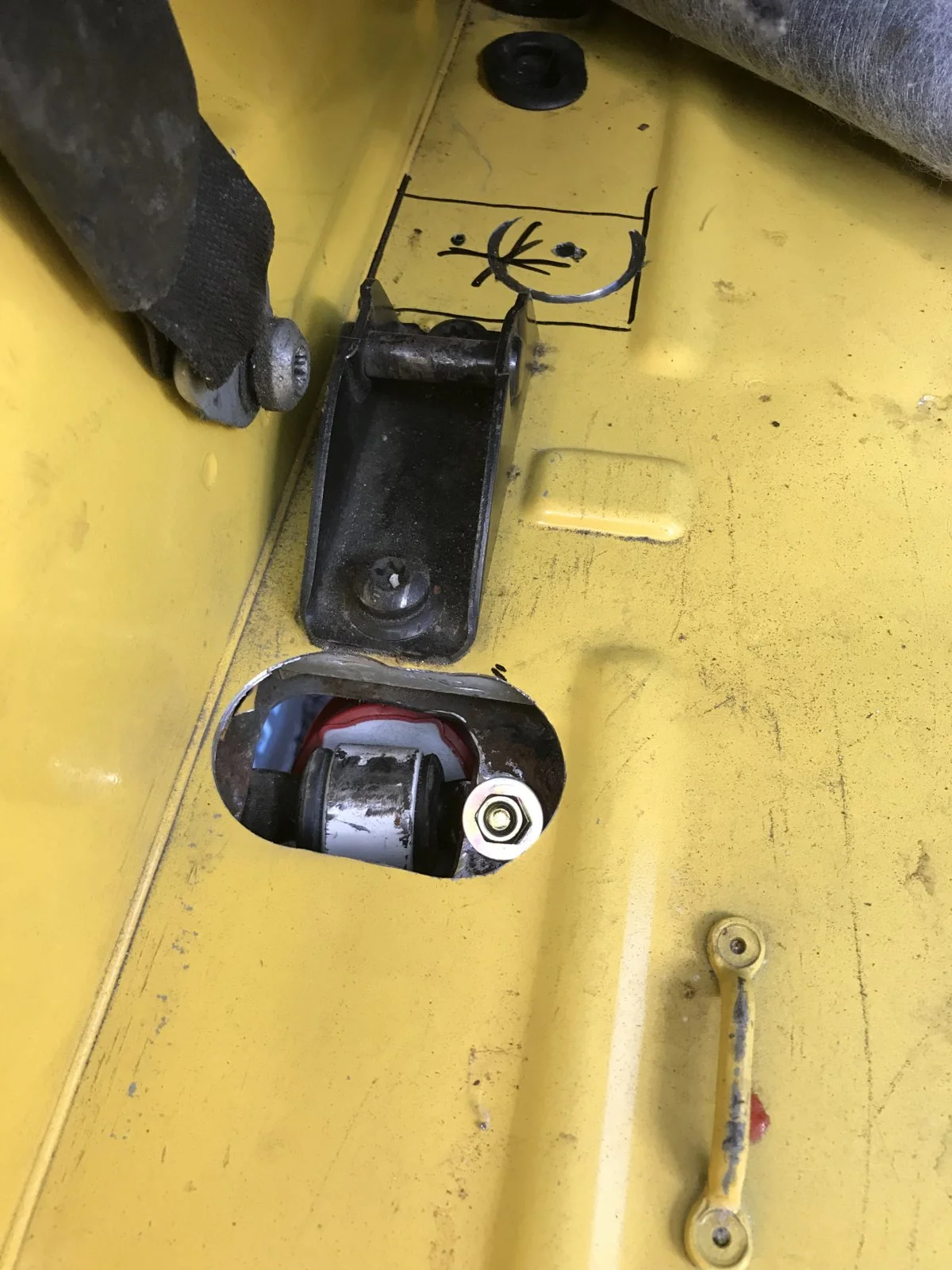

I found cutting access holes to be the quickest and easiest way.
I lifted my body, cut the welds with a Dremel, and bashed them out. Welded some bolts in to replace them. I was doing a body lift at the same time, so it made sense. If you run carpet, @derekmac's method would work well.
Do you have dimensions on the cut outs?
Think I might go that route

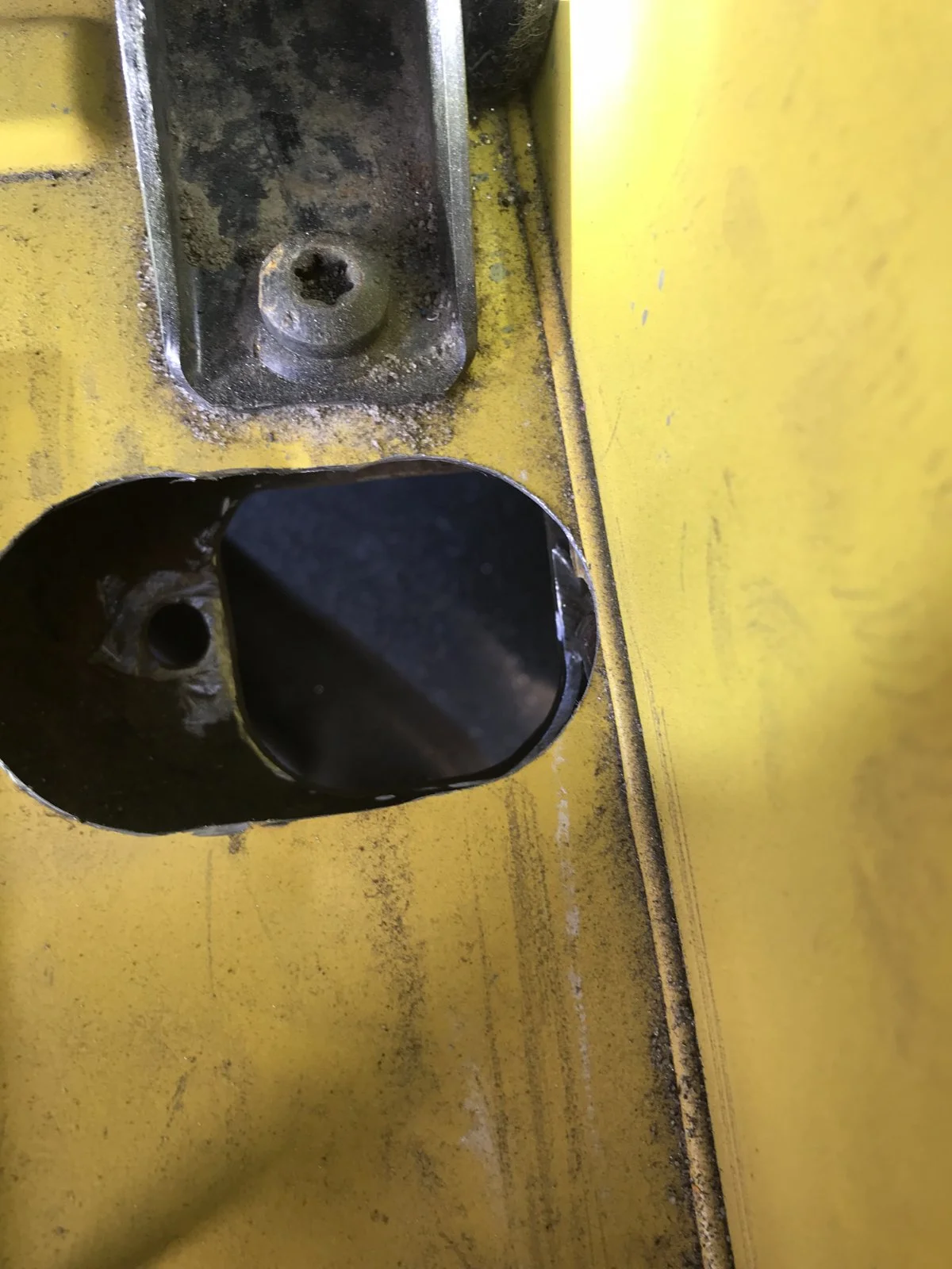

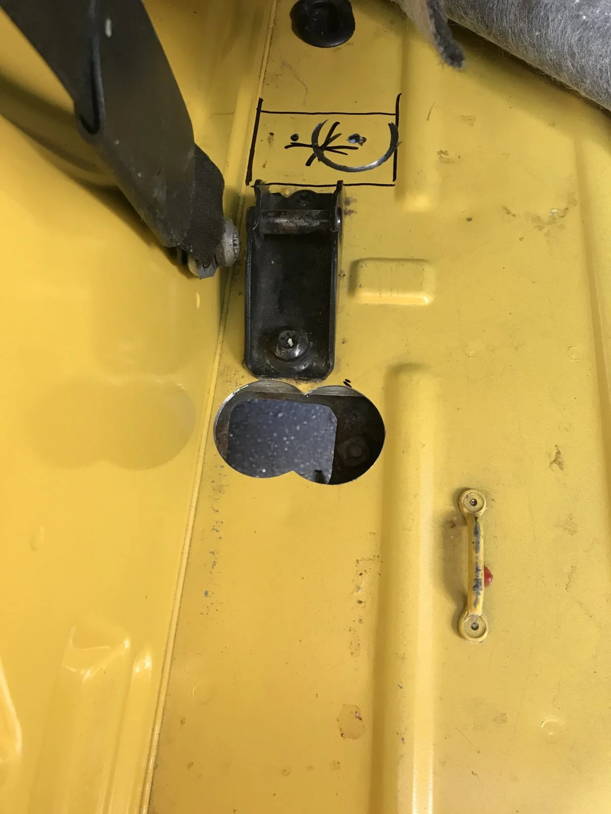

No sorry, I don't. Use my pics for reference though, and you should be good. The first pic is the pass side, and the two bolt holes are from the seat bracket. The last pic is the drivers side.
The plate I use for the patch doesn't need to be near as long as it is, but I didn't feel like cutting it down, lol.

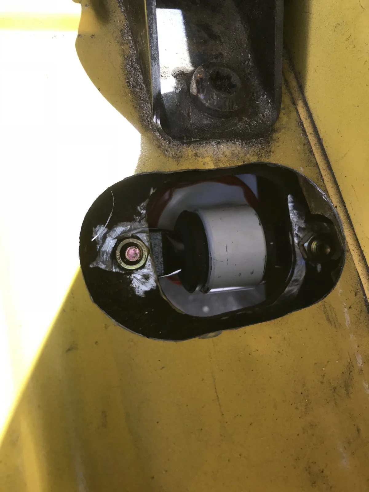

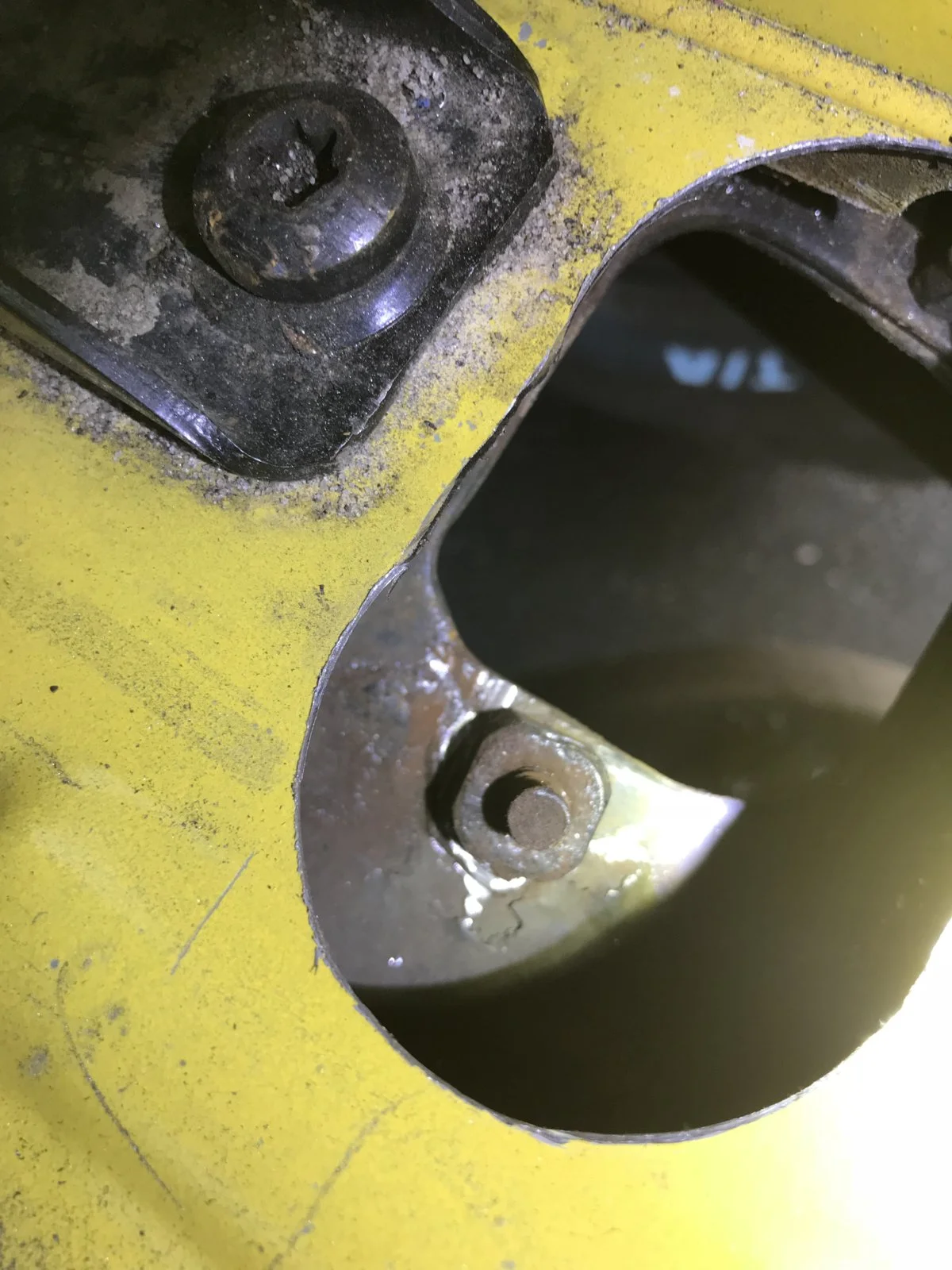

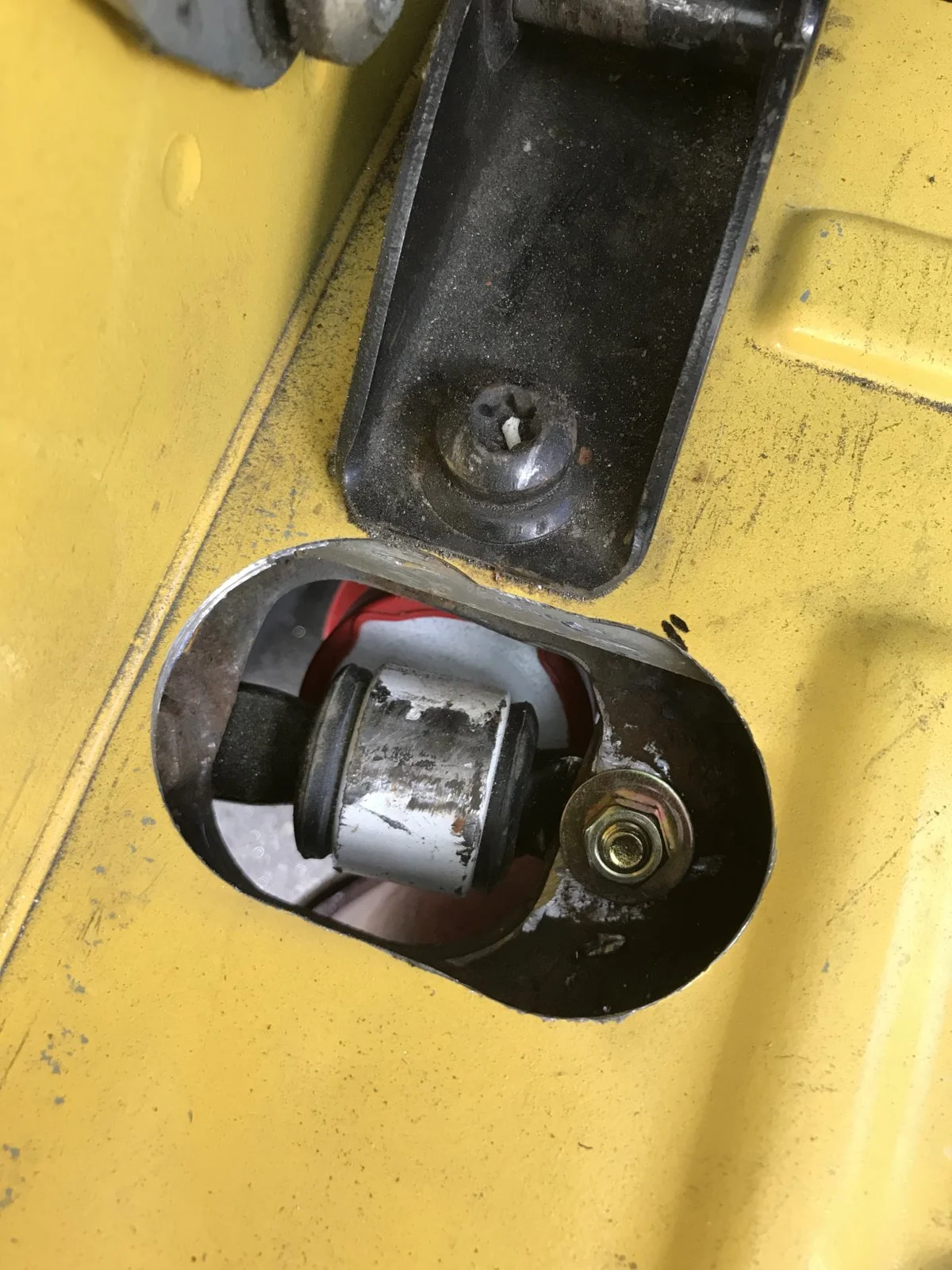

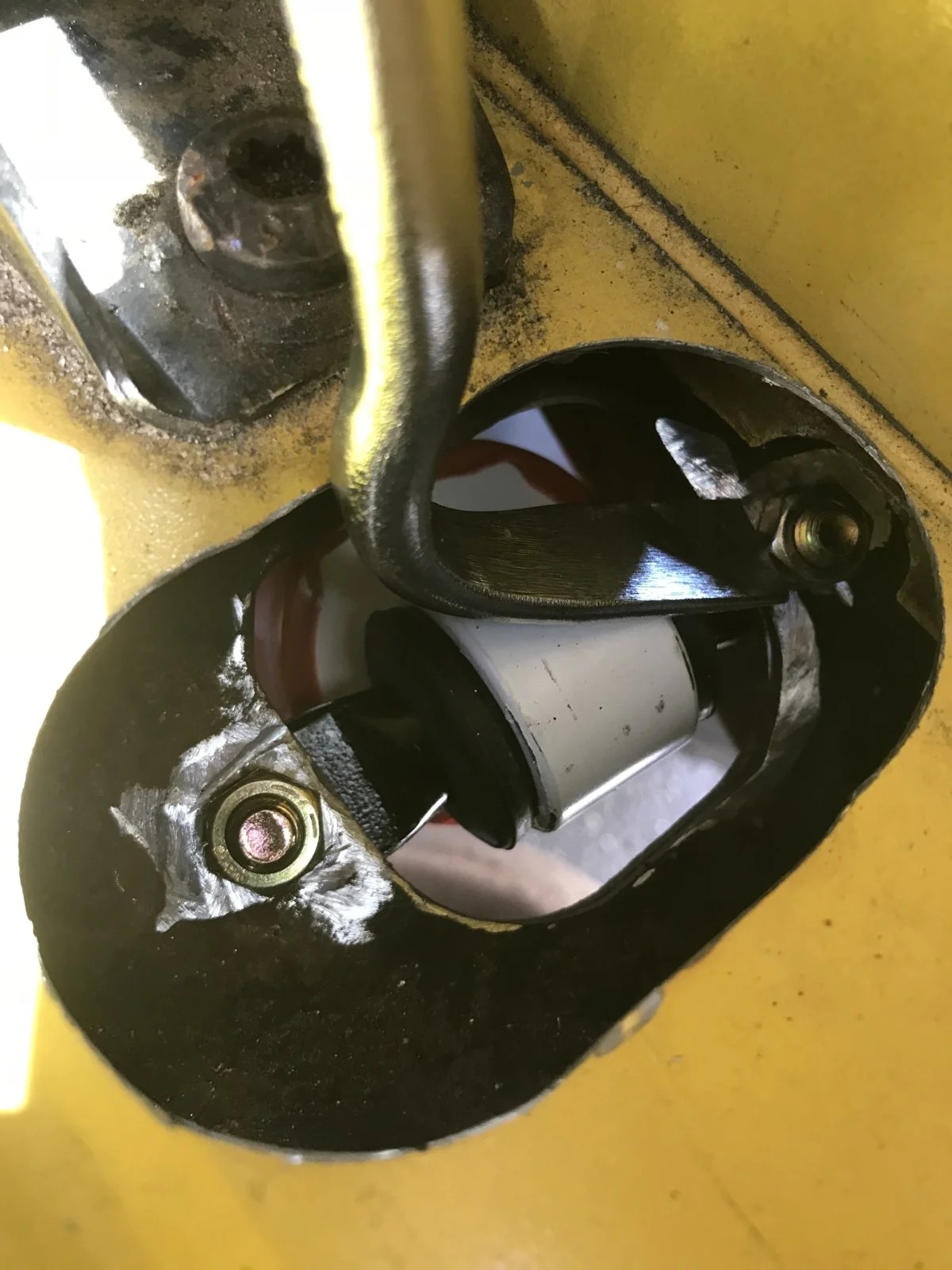

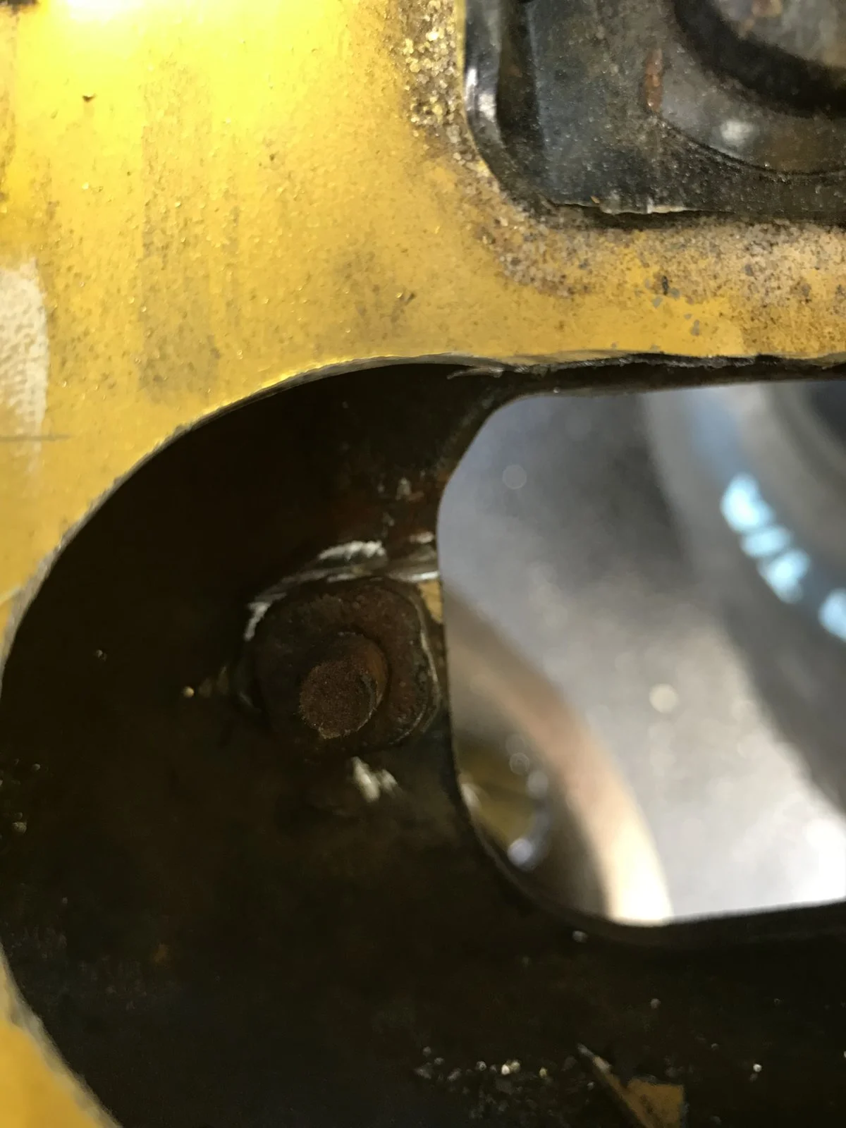

Thank you all who gave me ideas on how to remove those damn broken shock bolts.
I took a little bit of info from you all and conquered on getting them out.
So here it is.

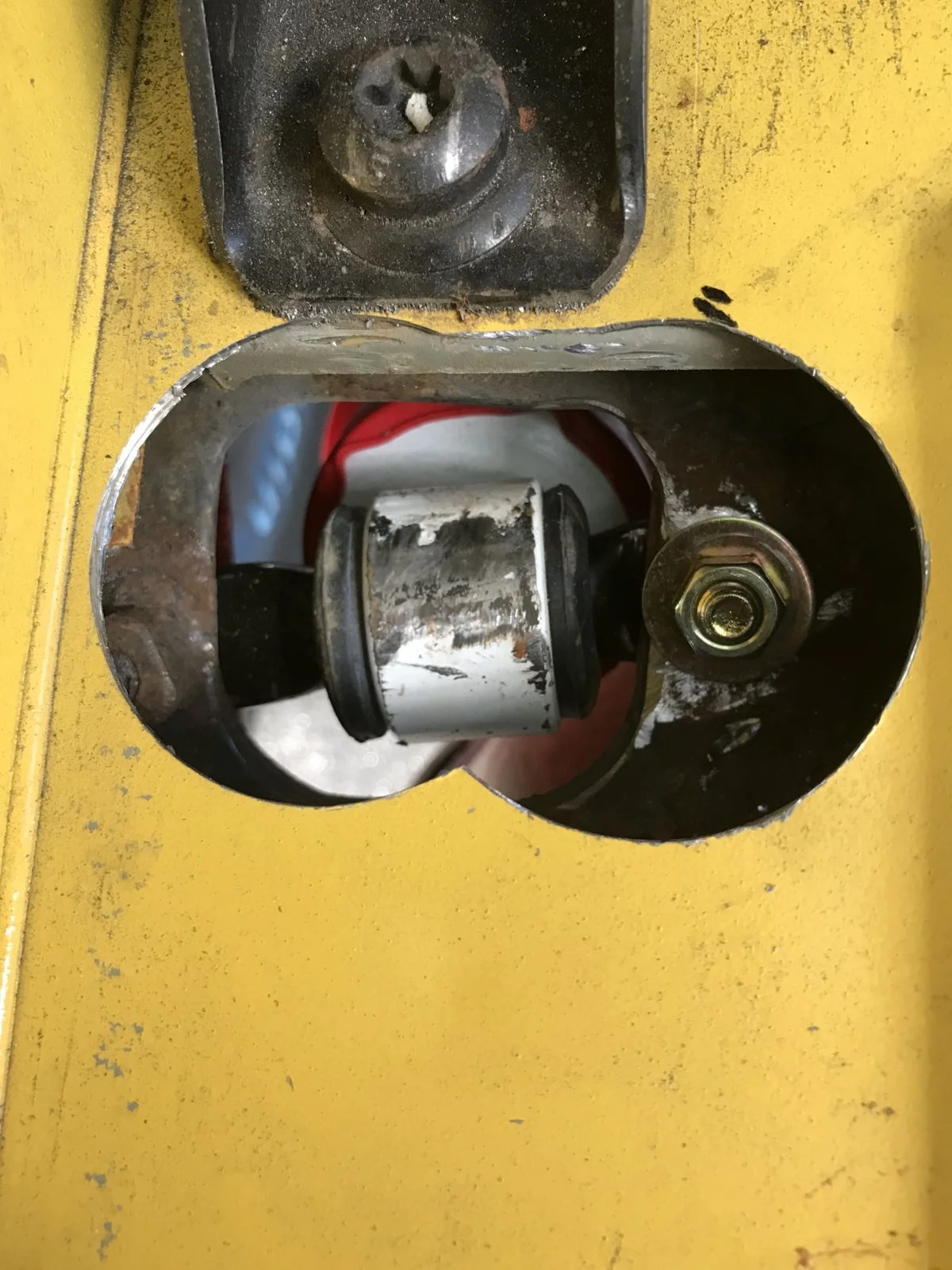

I went under my Jeep and drilled a pilot hole in the center of the squarish hole where the shock sits.
This gave me a idea of where to cup saw the floor from inside the bed section.
Took a guess on the width and made two 2” cup saw holes in the bed.

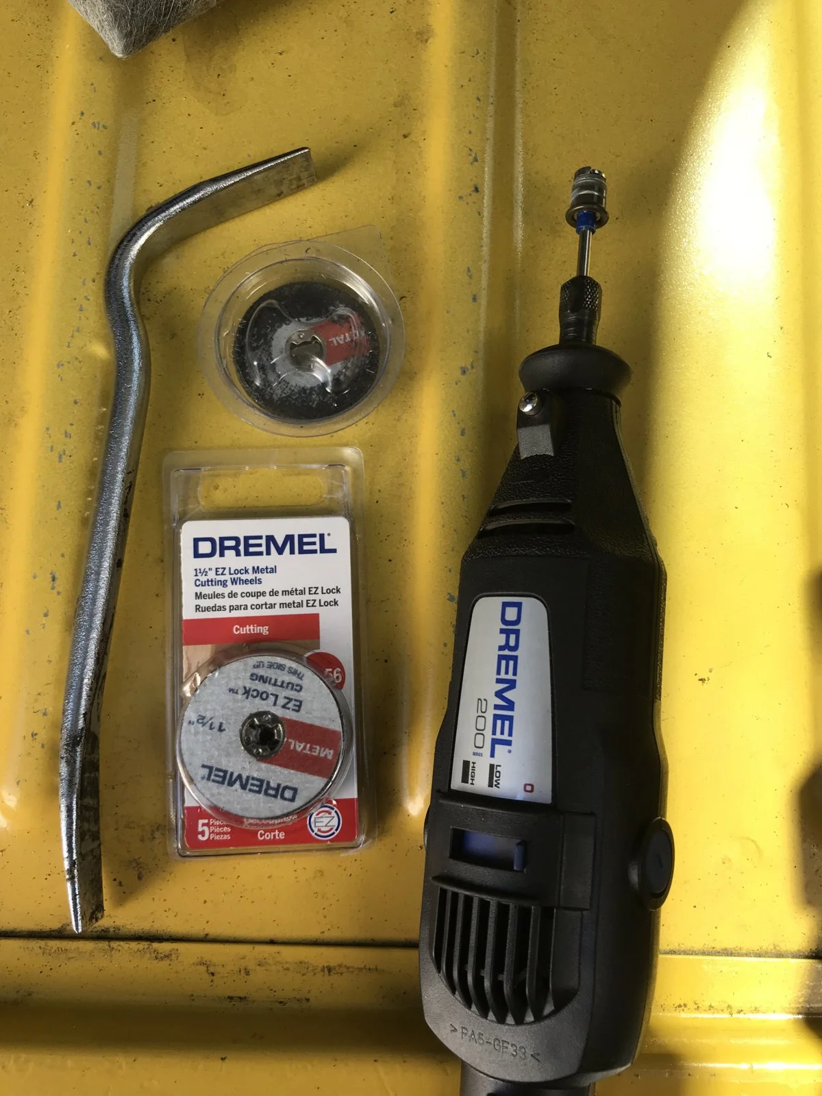

In the video the guy got those dremal cut off wheels, THOSE ARE THE BEST EVER, what a life saver they are.
I bought the attachment and some wheels and let me say they WORK GREAT.

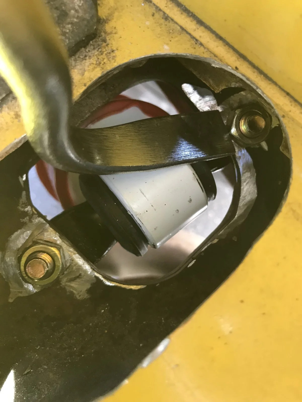

The outer bolts were a pain to get to but you can get them off.
One tool that came in super handy was a brake adjustment tool to pry out that outer bolt once cut deep enough. Who would of thought, lol.
All in all it took about 2 hours start to finish which to me isn’t to bad considering what’s involved.
Here’s some pics for your enjoyment and maybe help others out.
Again THANKS to all with the ideas. You guys are the best.
Derekmac,
Thanks again for the great idea.
I messed up on the first start of the hole location.
I didn’t realize it should of been BEHIND the seat bracket, lol. No big deal.
