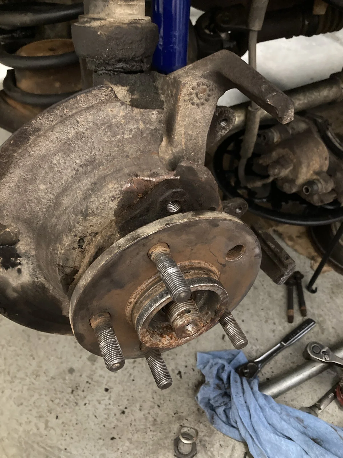

Just called the local autostore. $2.59 a pop for dorman front studs. I am just going to replace all of them probably since I don't want anything to go wrong for the next owner.

Anyone have any advice on getting the unit bearing out? Took the big nut in the middle out and the 3 bolts on the back out but it seems to be stuck in place. Hammering a screwdriver in between the flange and shield seems to be just damaging the shield

You can use the power steering to pop it off. It take some thinking but it's the easy way to free a hub. As you turn the wheel you can wedge something to pop off the hub. To check the studs I'd thread on a lug, if it binds the studs are probably bad.

Did you have any success with getting the studs in? I have to say that video made it look easy to remove and re-insert a new one, but then again, things looked a bit different than what your picture shows (or at least seems to)? Have you tried a puller on it (assuming it can be removed in that manner)? I wonder what the heck is holding it all together?
One thing I do know, if it doesn't feel like it's going to budge - don't keep going. More than likely, something will break - and whatever it is, it will be expensive to fix (or your injury will be). Instead, stop - and re-assess things like you're already doing. Something is keeping it together (hopefully it ain't something where you have to tear half the front-end off just to remove the stud).
Removing the hub isn't a big deal. Just leave the axle attached and pull it all out together. I can't really tell from your comment, are you doing this or just researching it in general? The studs have splines and are press fit in the hub.
