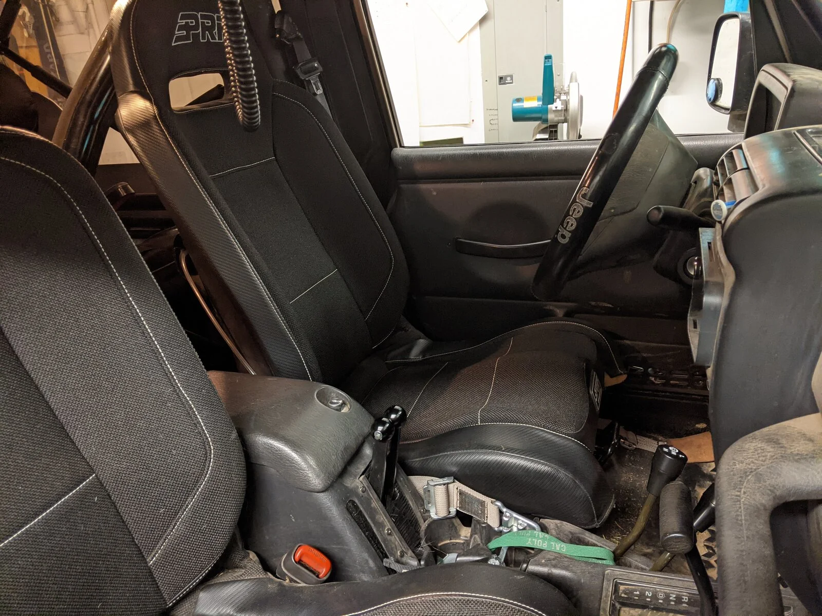

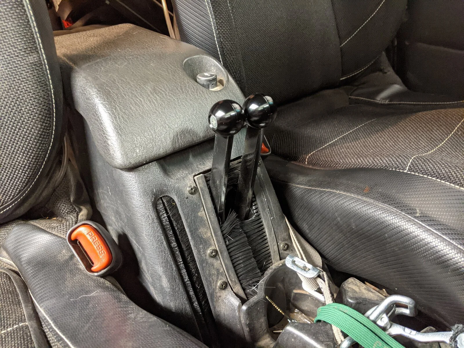

Here's the final install pics
I also find myself using it as traction control. More than a couple obstacles around here when it gets really slippery a locked rear will just slid ride off the line. So sometimes I will go in open rear diff and apply cutting brake as I get a little slippage and it keeps me from getting kicked off the line.
Blaine has brought up a cool idea which is now a lot of the factory calipers have a solenoid operated rear parking brake that might be a very cool cutting brake option. I was told the feel of the cutting brakes is really important but that is from my buddy with 14 bolt rear brakes. With my smaller brakes I'm pretty much all on all off. Either way having cutters gives you something new to play with on the trail and it's tons of fun.

Here's the final install picsView attachment 292817View attachment 292818
