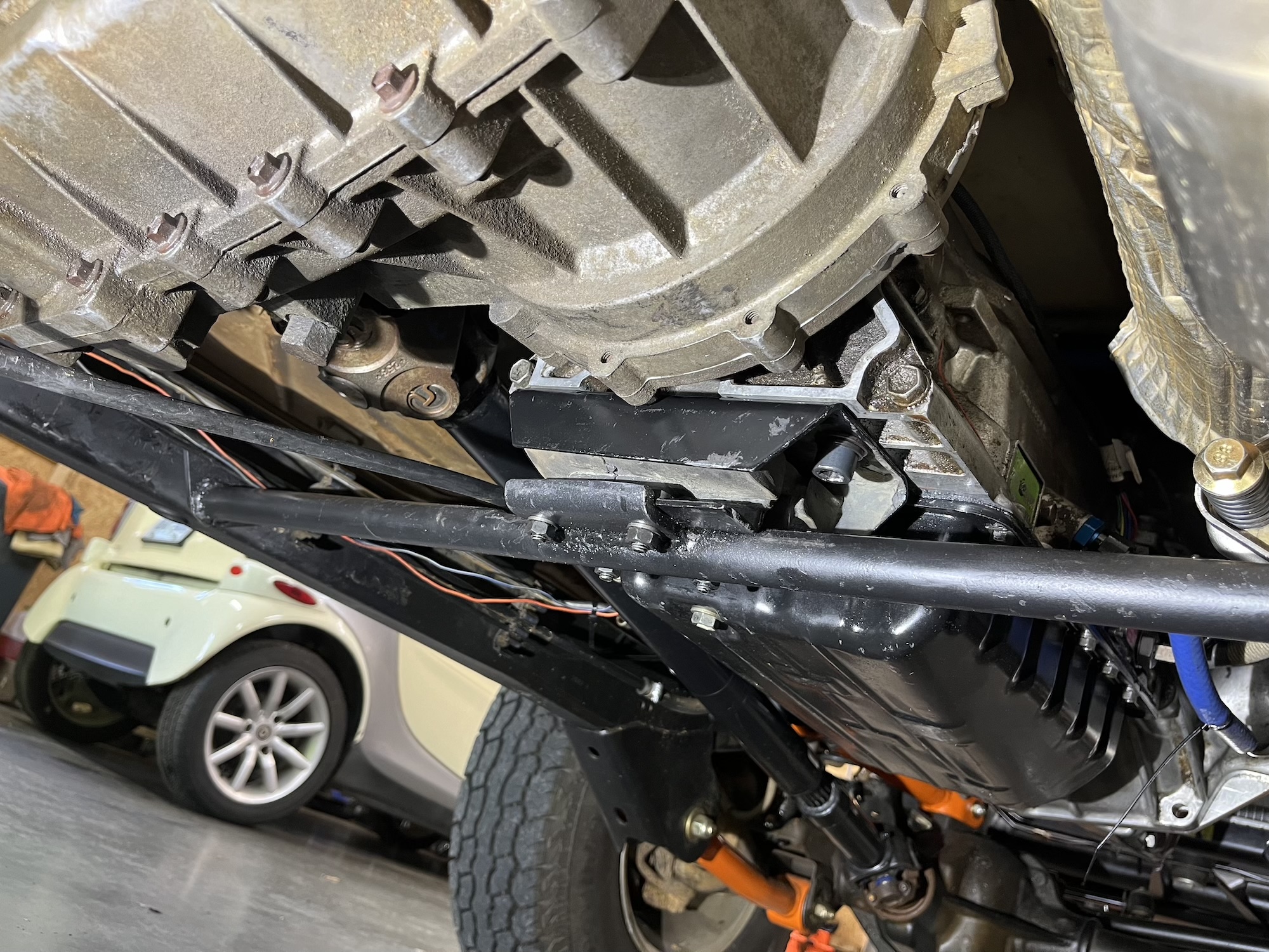

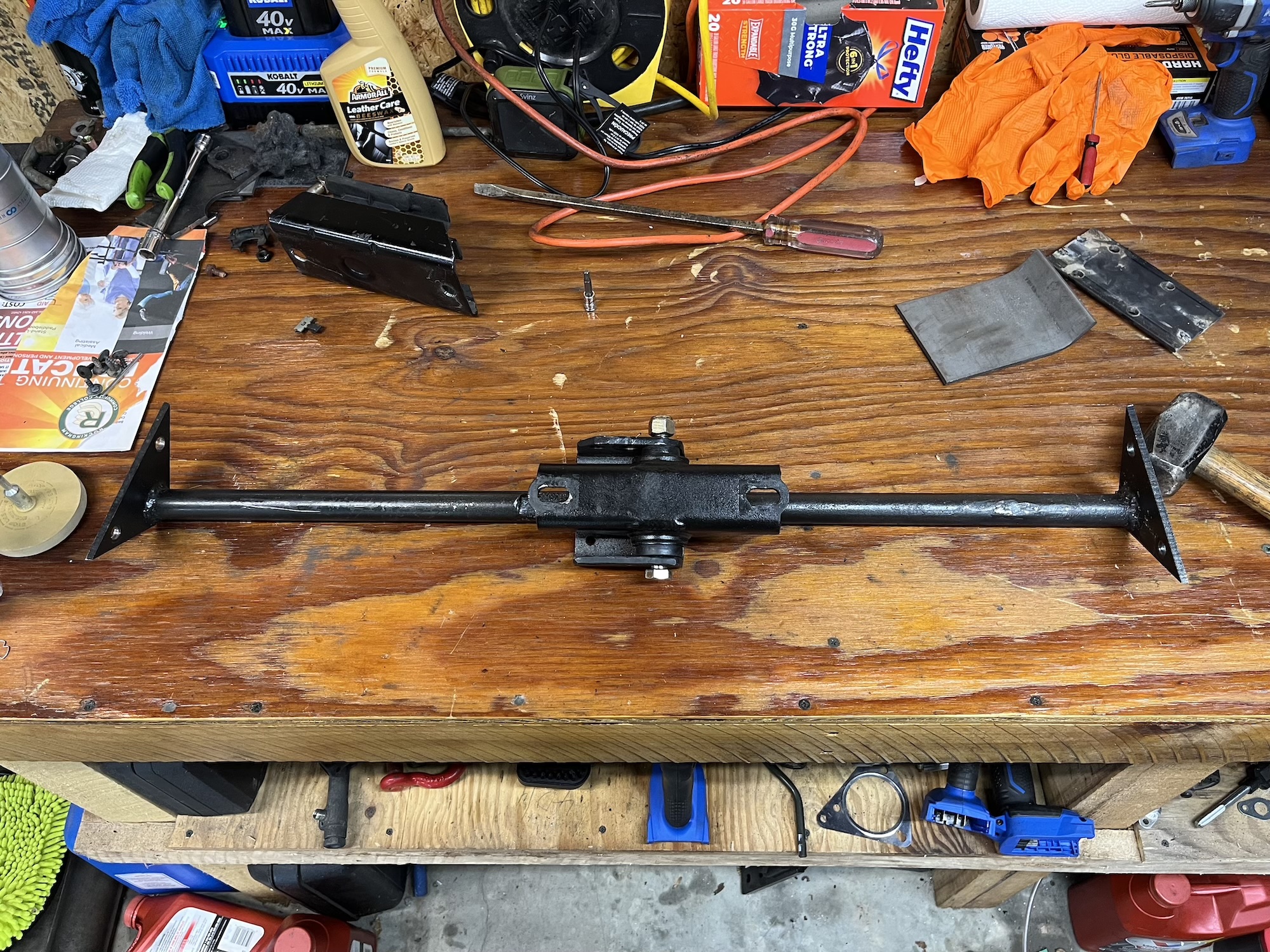

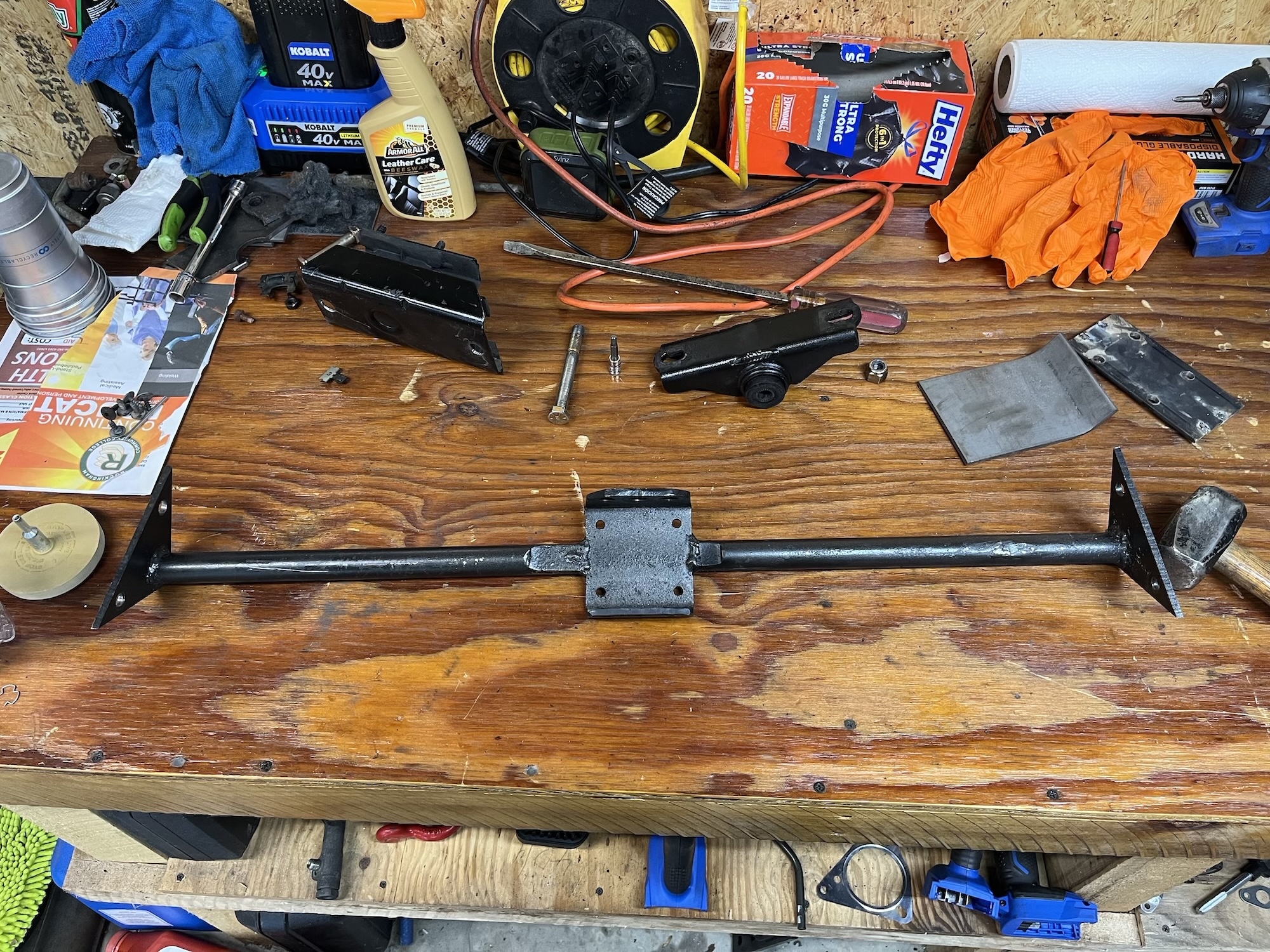

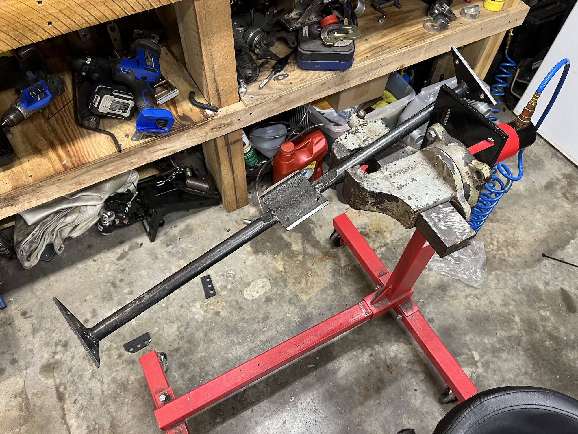

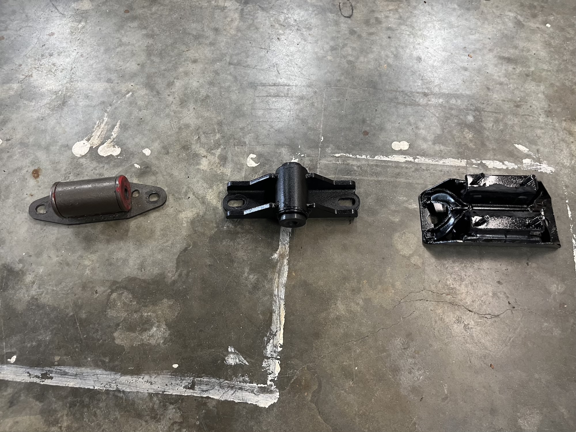

Hey TJers,
Ever since I got my TJ running with a diesel engine, be it the Kubota V2403 or my BEW TDI, I have had an issue with engine vibrations being transmitted through the chassis and into the cab of my Wrangler. The Kubota was considerably more severe than the TDI, but I thought that was just the nature of doing a diesel swap. I would have never imagined in a million years that going to the OEM-style transmission mount would solve all those chassis vibration issues.
Since I began installing a diesel engine into my TJ Wrangler, I have been using my own fabricated crossmember and bushing-style transmission mount to hold up the various transmissions I've used on this swap. I did this for multiple reasons, one was to have a flat bell pan and the second was to move the drivetrain forward since the TDI engine was so much shorter than the 4.0l engine. This had the benefit of giving me a very long rear driveshaft in my TJ. The third reason was I believed this bushing and sleeve design was better than the factory OEM-style transmission mount.
I went with this design, trying both a perpendicular and parallel setup, because over the years, I knew of so many other people using a similar design. The reasons ranged from ease of replacing the bushings to a stronger design, and handle more power and torque being applied to your driveline, be it the engine or transmission. I had decided that going to the bushing in a sleeve-style mount for my transmission would be a better setup for my Wrangler. Well, I was wrong!
A while ago I was talking to my friend David, who has a TDI Swapped XJ Cherokee with an AW4, and asked him randomly what transmission mount he was running in his XJ Cherokee. He mentioned that he was using the factory OEM-style transmission mount. It was a quick question and we went to talking about other things.
Well, I couldn't get that tidbit of information out of my head. I decided the other weekend to see if I could quickly modify my crossmember for my transmission to accept the OEM-style mount. I was initially surprised by how quickly I modified my crossmember to accept the OEM-style mount. The entire modification only took about 30 minutes, though that wasn't surprising seeing as the transmission mount I was using was designed for the AW4.
After reinstalling the modified crossmember back onto my AW4 in my Wrangler, I started my TJ Wrangler. I instantly knew this was going to change everything. The engine is quieter, and the vibrations have been reduced by about 90%. The tub and chassis vibrate less now in gear, meaning Reverse or Drive, than the tub and chassis used to vibrate in Park or Neutral with my previous transmission mount setup.
The surprises kept on coming though. The BEW TDI, which I have now put over 150 miles on since doing this modification, runs cooler, accelerates faster, revs faster, and seems to breathe better. It's almost as if I had some driveline bind with my old transmission mount that wasn't allowing the TDI engine and AW4 automatic transmission to move as freely as it needed. I don't have a better explanation for it. My TDI engine just seems better.

Since I began installing a diesel engine into my TJ Wrangler, I have been using my own fabricated crossmember and bushing-style transmission mount to hold up... the various transmissions I've used on this swap.I believed this bushing and sleeve design was better than the factory OEM-style transmission mount.....
I went with this design, trying both a perpendicular and parallel setup, because over the years, I knew of so many other people using a similar design. ......decided that going to the bushing in a sleeve-style mount for my transmission would be a better setup for my Wrangler. Well, I was wrong!.....

sitting in my invisible mechanics arm chair I will say your probably correct on better performance and your reasoning correct too. The last iteration it appears your bushing ends were pointed fore and aft.... so pivot was in orientation with crankshaft allowing for easy rotation of engine. AKA you gave it a pivot point. So yeah when under power .... like a drag truck lifting of driver wheel from torque at take off* the engine would rotate some and tweak everything. So this tweak...... in your set up; limited only by the engine mounts, likely pretty freely was causing bind down the chain. Engine had to work harder to overcome it all.
Folk with the OM617 report that using the OEM MB engine mounts didn't work well cause the torque from twisting engine.... particularly in Low range first gear... would keep ripping the driver front engine mount rubber in half in short order. Far as a know everyone used OEM jGM trans mount so their limit there was the trans mount... unlike yours which was the engine mounts. When I bought mine. (pre converted) the driver side was ripped apart. Myself w/out welder- nor hands on know how to redo motor mounts. Stuck with new OEM mounts but filled the cavity with a not stifff, but it will help rubber.... mayyyybe 30 durometer? and will put a limit strap so engine on driver side can lift no more than??? Im thinking 1/4"???
When you had that bushing side to side ... it likely was just not enough meat of rubber to reduce the vibrations etc. that tiny cross member likely didnt spread the load well either.
PS... IMHO that is not enough BEEF in that cross member. It might even be tweaking. Think about it.... that small bar stock is replacing what the GM engineers spread out thru the whole Skid plate/pan and the broad spaced attachment to chassis. If they could have gone that small they would have.. Think of all the mula they would save in manufacturing and materials if they did. My arm chair engineer status red flags kinda go off looking at it. (Granted gotta background that includes movement science's though aimed at human movement not vehicle movement)

I agree with you on the the engine mounts and the small amount of rubber as well causing limited moment creating the bind.
As for the crossmember diameter, the video and photos don't do it justice. The diameter of that bar is bigger than the photos make it look and the wall thickness on that bar is massive as well. I was trying to go through my notes to find the exact specs on the diameter and wall thickness again but I can't find it. I did ask several people that I trust that do fabrication and work in machine shops if this bar would be strong enough for my application before committing to it.

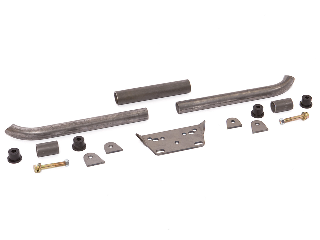

Yes I did and it was based on other crossmember designed that are available from companies like GenRight as well:
https://genright.com/shop-by-vehicl...train/universal-transmission-crossmember-kit/
My design was based off of this roughly. I've been running this design for years now and with a heavier transmission as well. The Ford 6r80 I was running weighed 234lbs and I never had an issues with this setup. The AW4 is around 100lbs lighter which will help as well. It is something I will be keeping a close eye on but everything points to this being more than strong enough for my setup.
Thanks
Grant

looks like their's has two mounts. One using kit above... and another one at back of T-case. Guess you are running two of them as well. If so then red flags go down LOL
