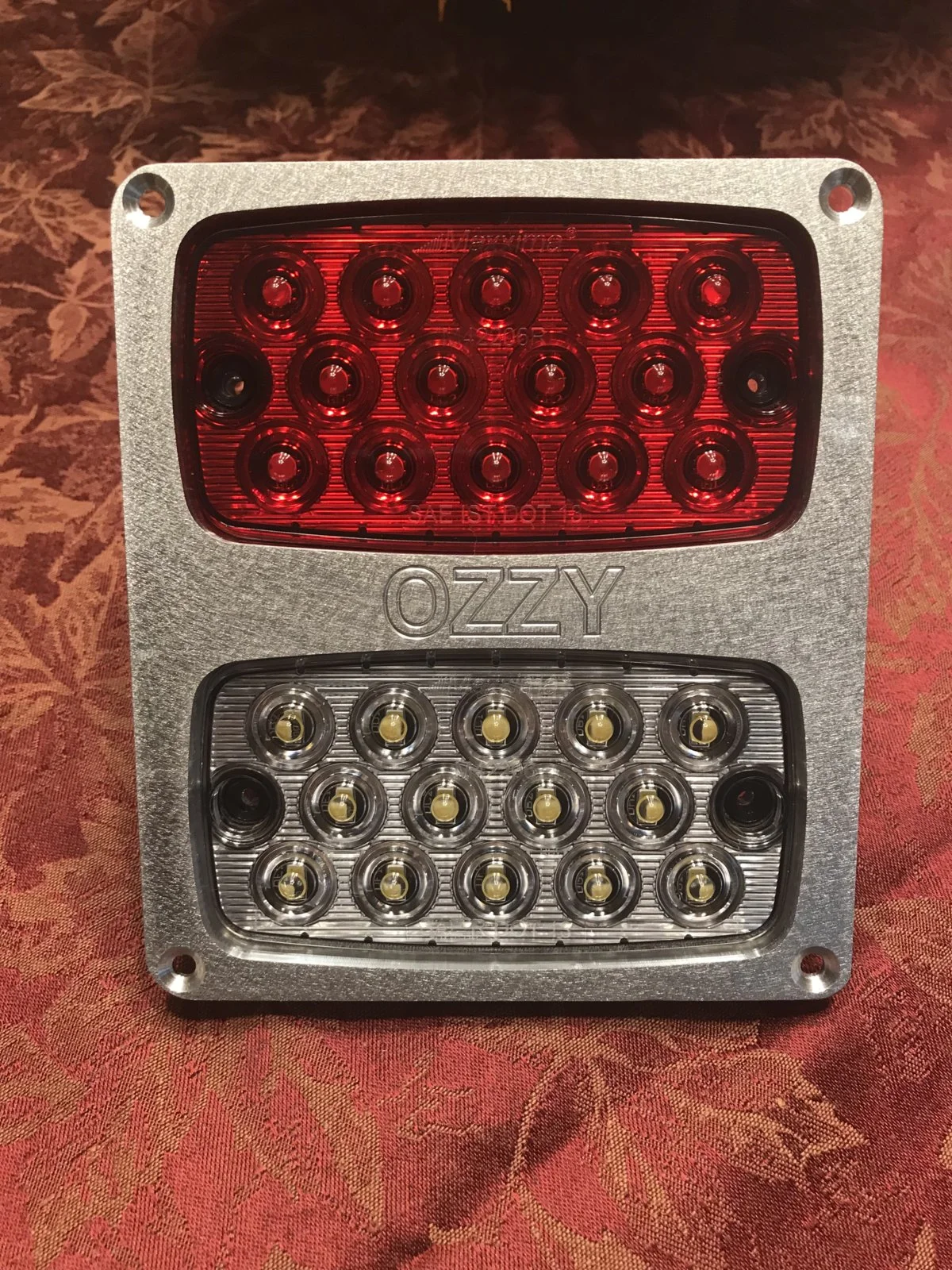

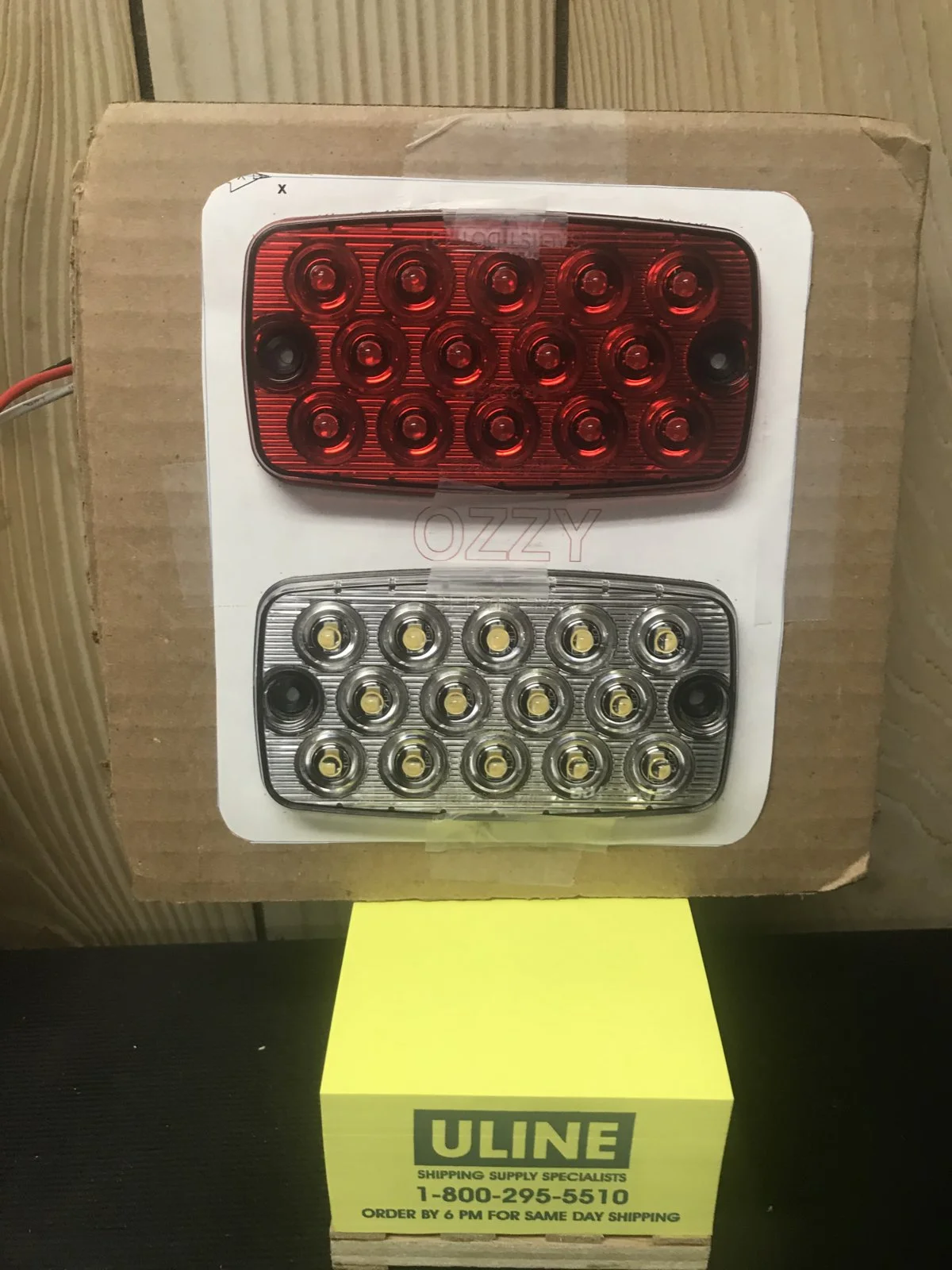

A while back I researched LED tail lights. After seeing all the different options and prices I decided being a machine shop owner I would build my own.
I wanted them to be as flush as possible so I found some LED lights (Red and White) that were low profile and the size I thought would look good. I also bought a LED license light.
I now designed the layout and size of the bracket. After I was happy with the looks of it I made a drawing on the computer and cardboard mock up of it to place on the Jeep to see how it looked.

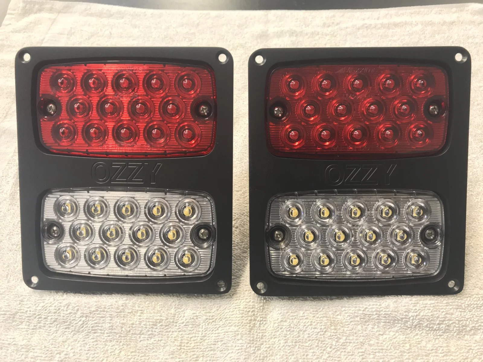

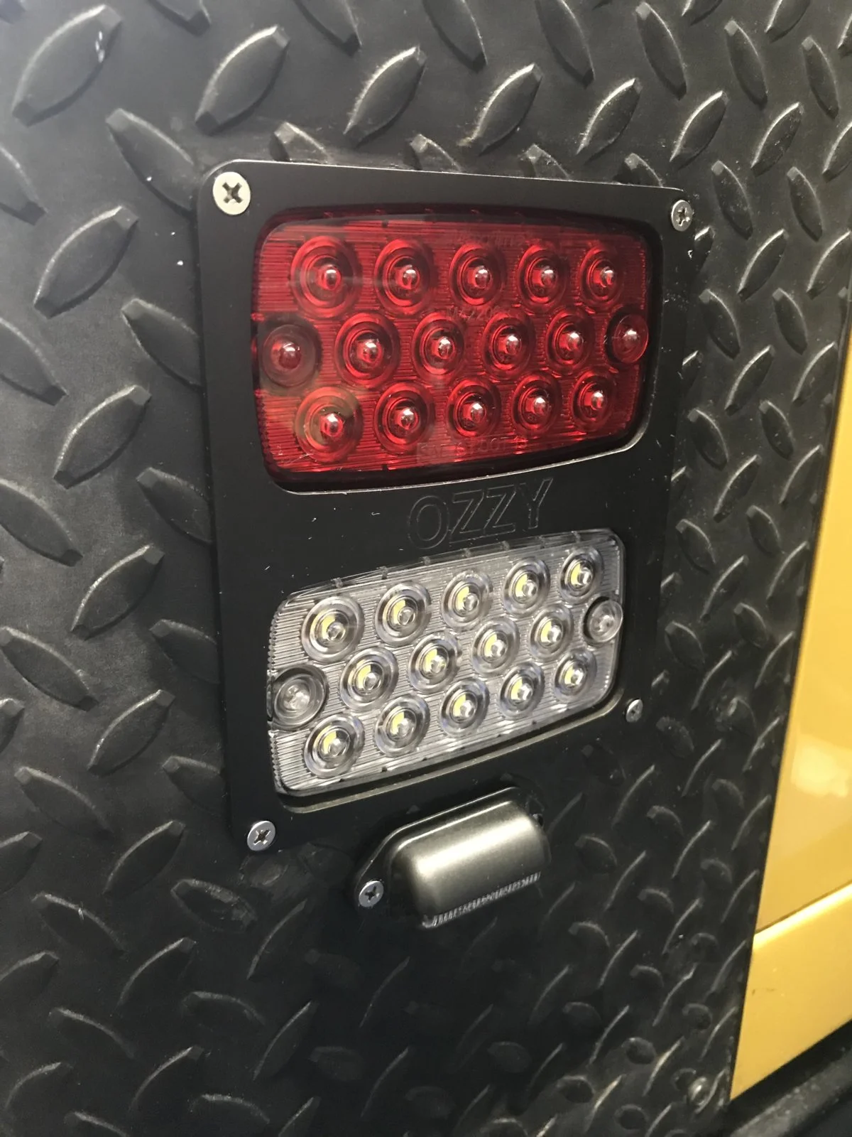

I liked it so the next day I programmed it into the computer and made a program to machine them out on my CNC Mill. I made a total of two sets. One with the word OZZY engraved on them and one blank. OZZY is my favorite male rocker and the name of my jeep. After the first one was finished I tested the lights fit in the pockets machined and then made the rest. After finished I took them in and had them Black Hard Anodized. This keeps them from corroding and matches my Jeep.

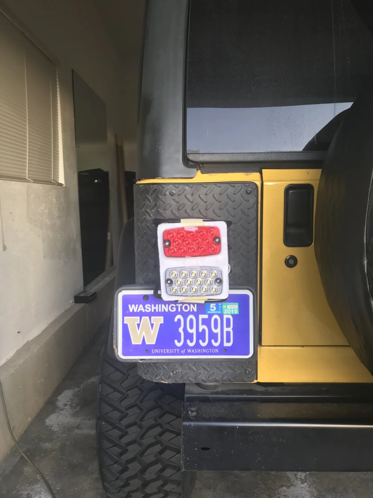

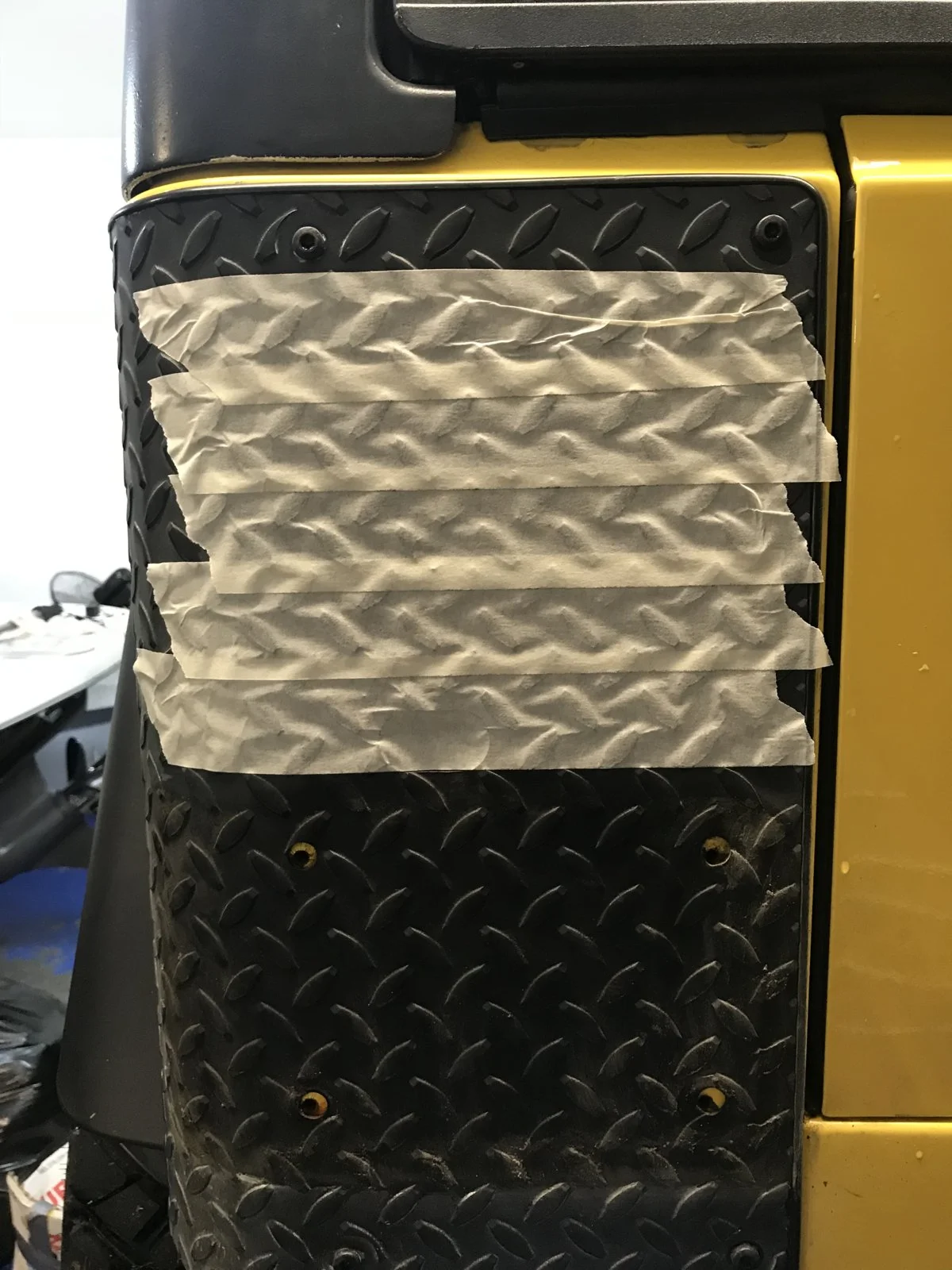

I first removed the old tail lights and cleaned the back of the Jeep so the tape would stick well.

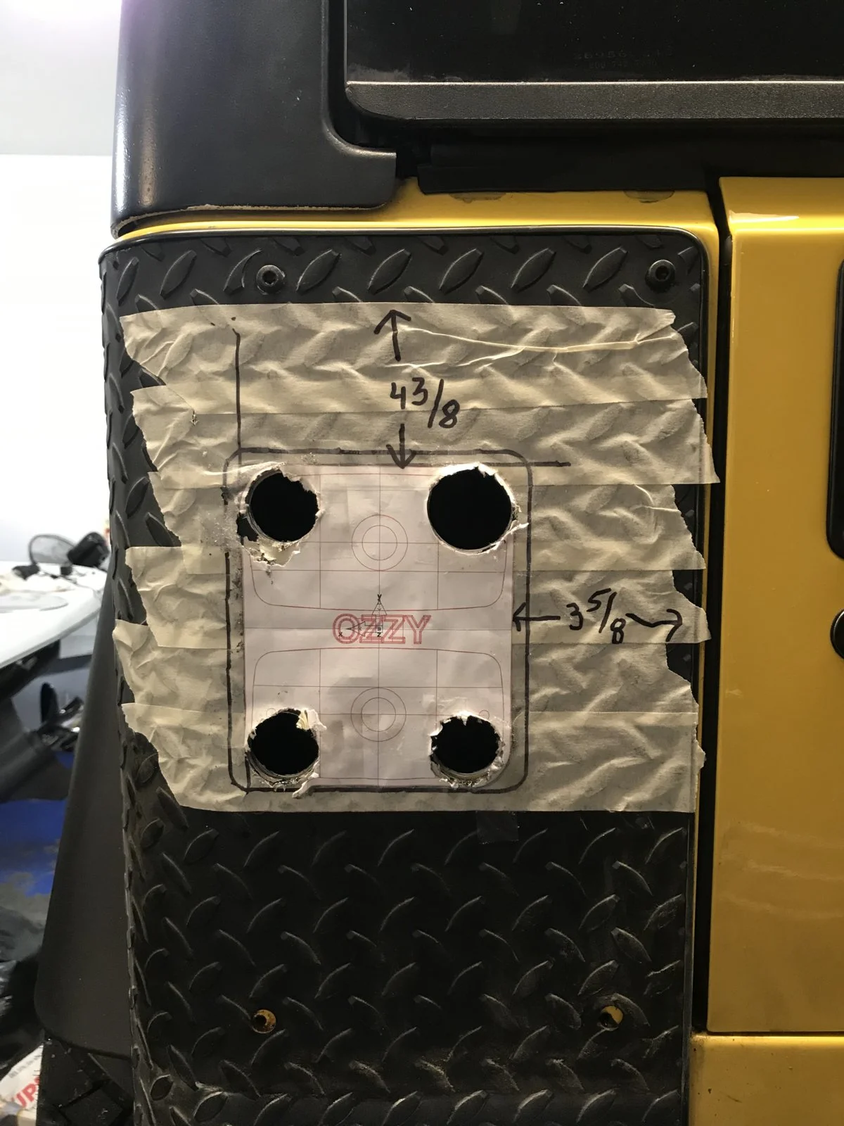

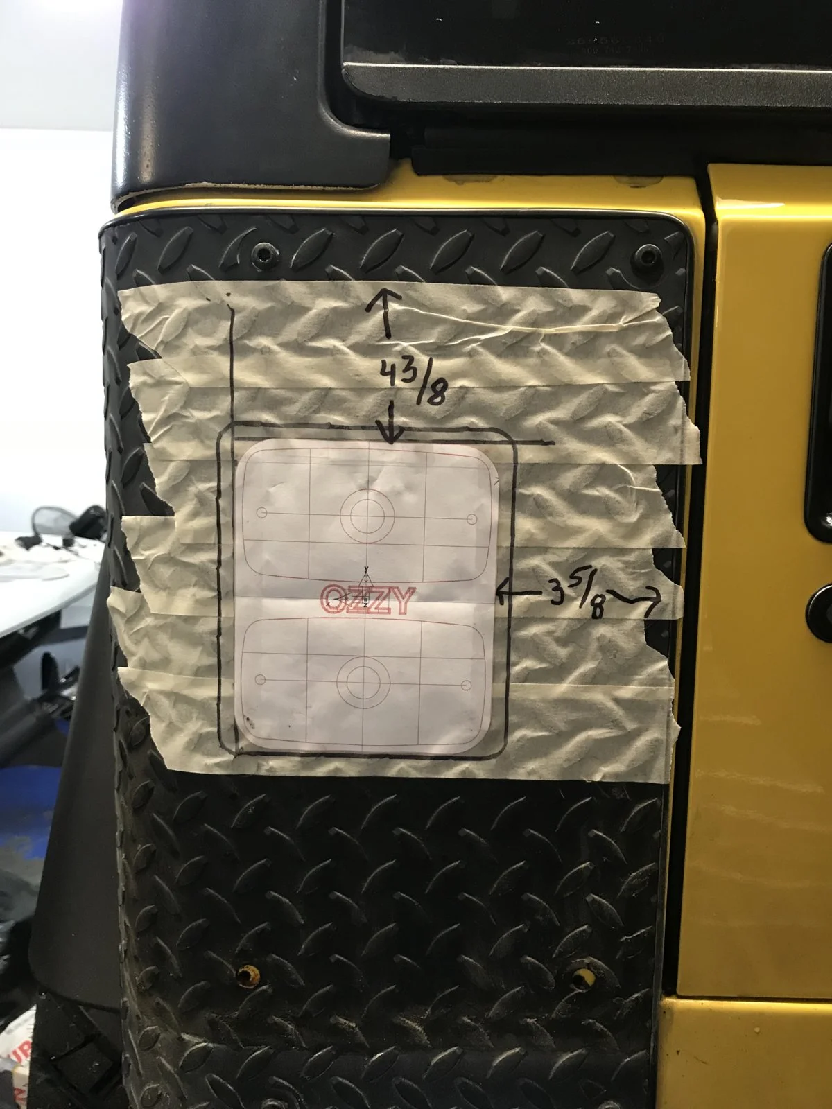

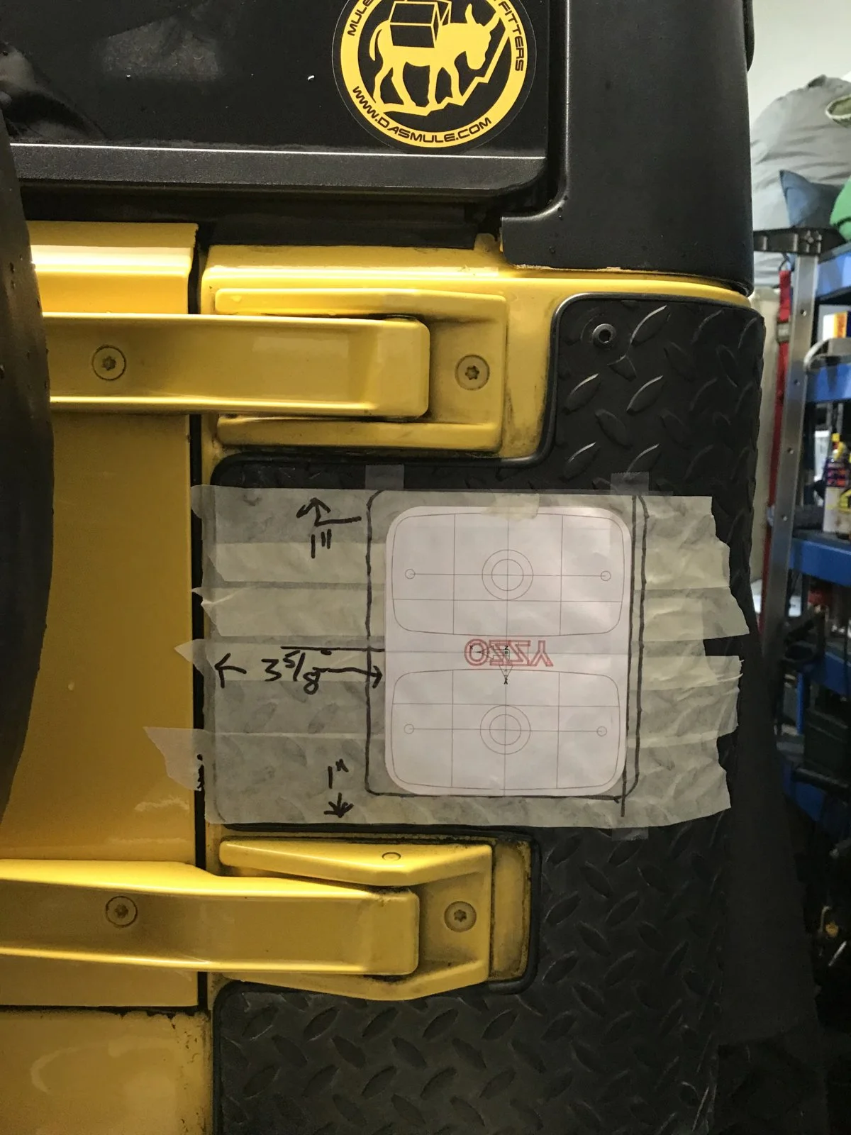

I then made a pattern to position on both sides of the Jeep so I could lay out where to cut the opening for the bracket I made. I measured the passenger side between the hinges to find the middle point of them and then transferred that number to the driver’s side. I then measured from the tailgate opening out to get the same position on both sides that way the brackets would be centered this was too. After measuring 2-3 times to make sure everything was correct I taped the pattern in place. I then checked to see if there were any issues behind the panel by removing the guard behind the rear wheels to gain access to this area. Nothing was in the way so I was good to go.
I used a 3/16 drill to drill in the center of all four corners of the bracket to guide the holesaw. I then switched to the 1-1/2 holesaw with a ¼ pilot drill and drilled out all the corners making sure to stay inside of the pattern lines. I did this on both sides.
Next I got the Sawsall with a fine tooth and short blade and cut from hole to hole making my opening again staying inside the pattern lines. Some might use a cutoff wheel on their grinder for this. I was more comfortable with the Sawsall. I then test fit the brackets and ground or filed the opening until they slipped in. After I knew they fit I put a level on the top of them to make sure they were perfect. You could use a tap measure as well. I then laid out the mounting holes and drilled them through.

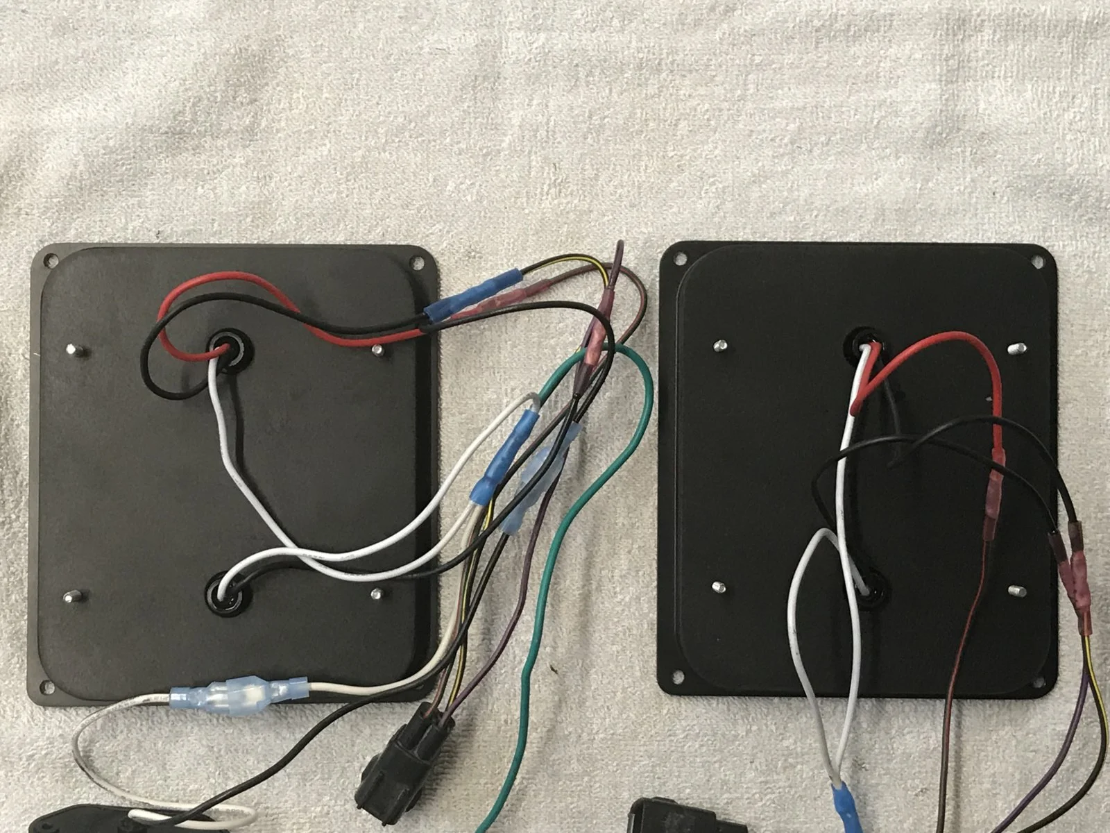

Back to the install. I then used rust preventative paint on the exposed metal. While this was drying I then went and wired the lights up. First thing you need to do is replace your flasher relay with a LED compatible one. This is on the steering column. I then cut the ends off the factory lights I removed so I could use the factory plug to plug into the Jeeps harness. I first tested my connections and then also tested on the Jeep before making my final connections. Once I knew they were correct I used butt connectors that had the heat shrink cover on them. I crimped and then sealed with the heat gun. I also used quick connects for the license plate LED as they went in through a separate hole on the Jeep.
Color codes are as follows for my TJ
Black from Top Red LED and License plate LED to Black/Yellow of plug (running lights)
Black from White LED to Violet/Black of plug
Red from Top Red LED to Green/Red of driver’s side plug, Brown/Red for Passengers side plug
White from all lights to green (not supplied) for ground to Jeep Body

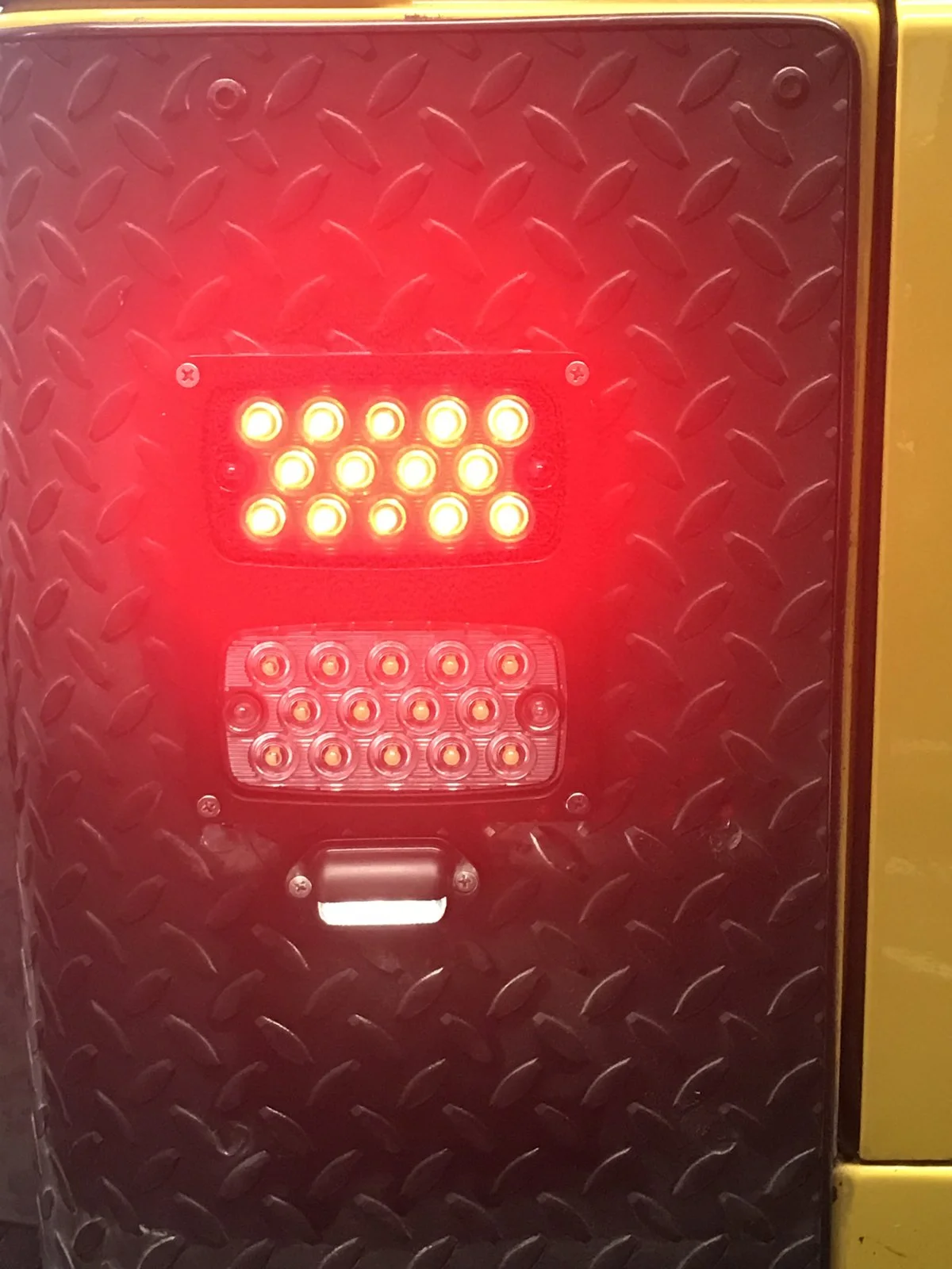

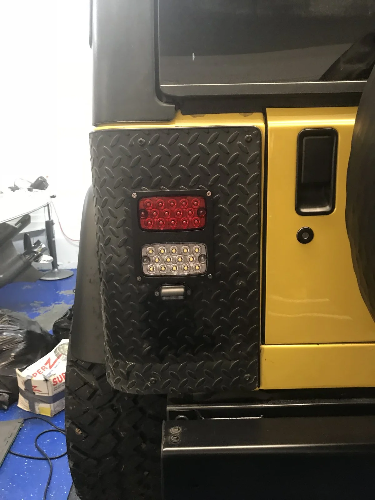

I then put a bead of silicone around the brackets, plugged into the jeep harness and attached the ground (green wire) to the Jeep body and bolted them in place.
I then tested again
They worked so I did the final assembly by screwing the brackets into place.
I took my shot of Tequila and chugged my beer and proceeded to put all my tools away.
Total Time of install 6-8 hours
