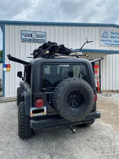

On 15 Aug 20 I made the drive to Hixson, TN to pick up my new top. I was greeted by Jason who showed me the top and explained how he and the team at BD had designed and manufactured the top as well as a short tour of the factory. Mike seems to have a talented group of guys under him that are highly motivated, even if it is a Saturday morning. After a bit over an hour the install was compete and Jason walked me through the top again and answered all my question on how the wiring was run and other tidbits. Finally, the long wait was over.

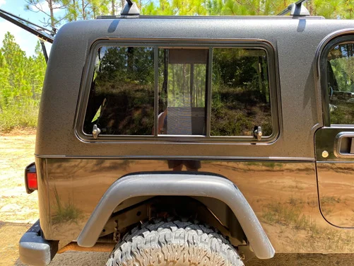

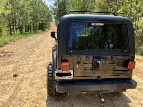

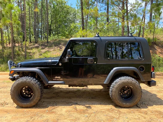

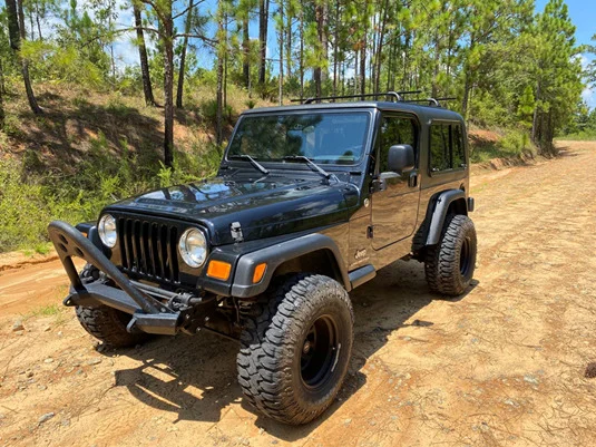

Exterior Fit and Finish

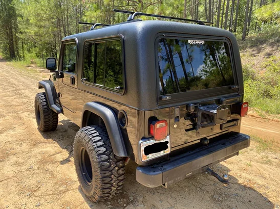

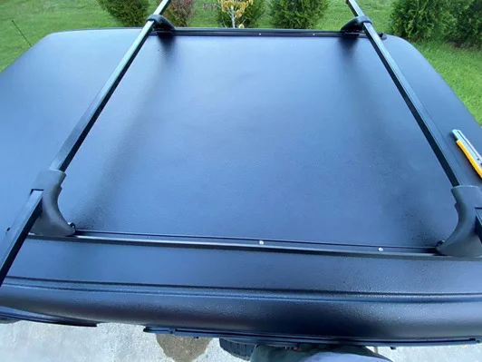

After some back and forth with Mike, I settled on their “Shiny” black exterior. I would maybe consider it a satin. Either way I was looking for something that would be close to OEM in terms of matte vs bling. I feel that their standard coloring is spot on. In the pictures below you will see some dark black spots. That is just water that I was too impatient to wait on before getting some pictures for this write up. The only gripe that I had with the exterior was that the rubber seal on the rear window was a bit too long. A few seconds with a box cutter and it was improved though.
I removed my tire to make access easier. Also looking at just strapping it into the tub when off road. Speaking of which, some folks have raised concerns about the side window handles sticking out and being broken by limbs and such. I plan to just remove the top when offroad. No need to risk breaking a brand new top. Maybe future generations will include flush mount handles but I still wouldn't risk it.
An easy improvement that can be made would be key matching all of the locks. On my top the side windows match but the rear has its own key. And I know this one is a bit knit picky but the handles on the left and rear rotate interiorly to open and the right rotates anteriorly. I haven’t played with them yet, but I plan to swap the handles around if possible to remedy this. It’ll drive me nuts.

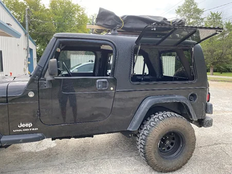

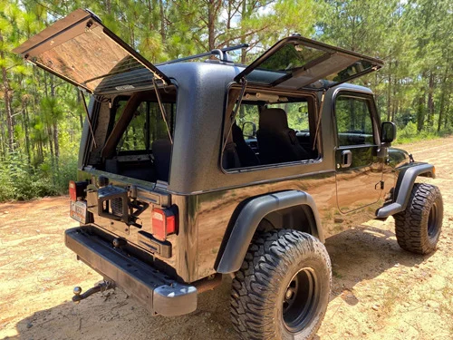

Side access has been great for loading the kid and chucking random things in the back.

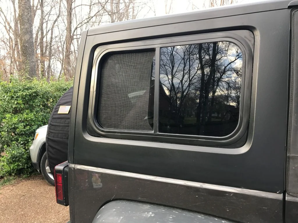

The middle sliding windows seemed odd when I first heard of them but for me they are perfect for keeping my crazy husky’s limbs in the ride at all times.
Note: The rubber caps on the aluminum rails pops of quite easily. May want to glue or screw it down to keep them attached and stop junk from accumulating in the bars over time.

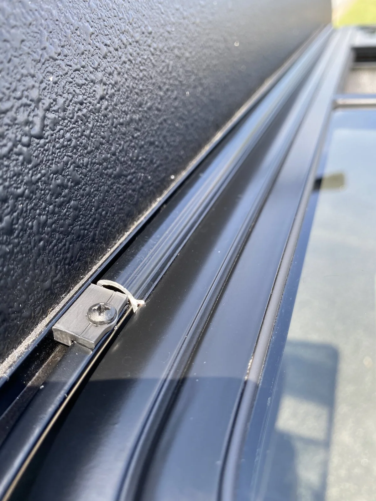

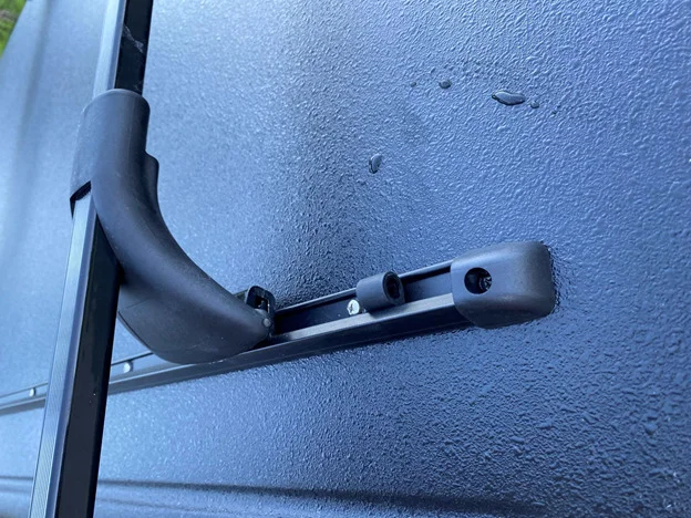

I found these little hoop guys on top. I imagine the are for bungee cords/tie down points. At least they seem about perfect for it. The eyelet slides to the left to the screw you see and a few inches to the right to the end of the rail.

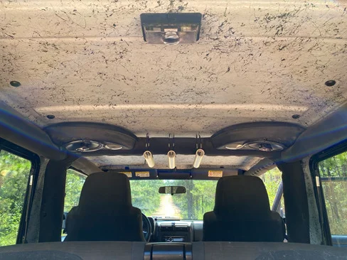

Interior Fit and Finish

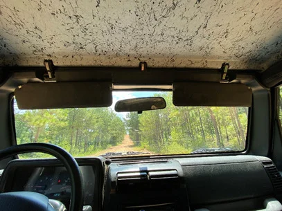

I opted for the standard grey interior which has black spackling. I believe all the tops come with one LED dome light that can be mounted anywhere.
The PVC pipes are my el cheapo rod holders. I had meant to experiment with different positions and clean them up a bit, but this worked for about $2 so I called it good and left them as is. I will say, I like that this location keeps my reels much cleaner than a truck bed or bumper mount. It worked well with my soft top but I don’t think I'll be driving down the road with my new rear window open. I plan to see if I can move the pipes forward and make a mount that hangs down from the ceiling. Not sure if it will impede visibility or if it will make enough room for 7+ foot poles. More to follow.

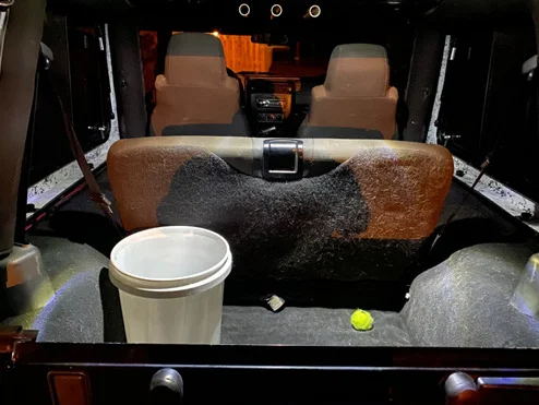

It’s a bit hard to get a good pic but here is the trunk area at night with the dome light on. The strange orange colors are from a streetlamp down the driveway.

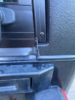

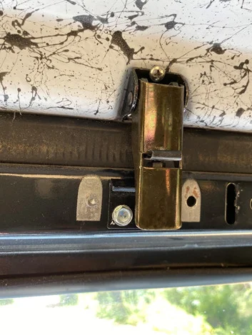

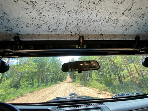

Here you can also see the three attachment cams at the windshield. These and the thumbscrews on the tub need adjustment within a few hours after install as the weather seal settles. Also, I had to flip my mirror right side up in order to increase visibility out the back. How strange.

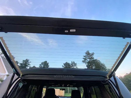

I chose to add the defroster option to my top as well. My job requires that I move somewhat frequently, and I wanted to have a little cold weather capability added. Not sure if a wiper is in the future but that could be useful as well.

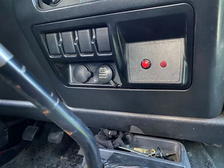

Here is the defroster switch and timer light supplied by BD. It works for now but I plan to upgrade my console later with something like what 12V guy makes. I just need a lot more stuff hooked to the switches that I don’t have before that happens.

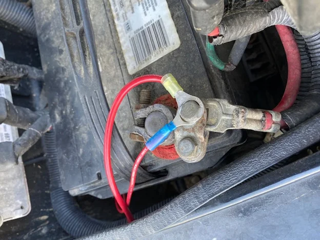

Here is the battery tie in for the defroster.

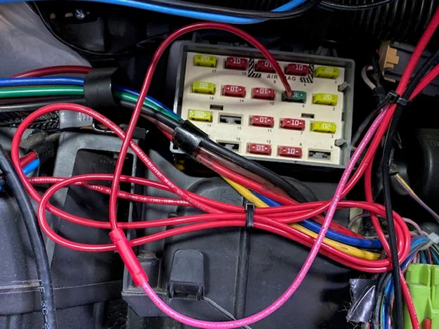

Here is the fuze tie. I didn't check this but I was told that the switch is tied to the wiper fuze to ensure it will not be active when the key is off.

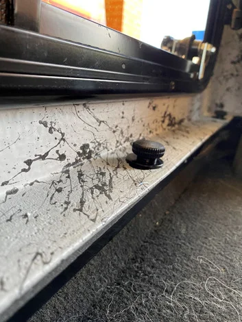

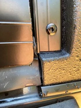

Each side of the rear has 4x thumbscrews on that attach the top to the tub. These need to be adjusted as the seal settles during break in. Note the drop of water next to the thumbscrew. I believe it came through the sliding window’s felt-ish seal while washing the Jeep. Not a concern and the downpour I drove through on the way home did not present any issues for the top.

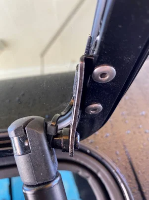

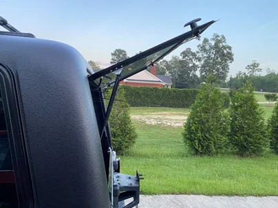

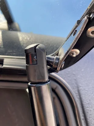

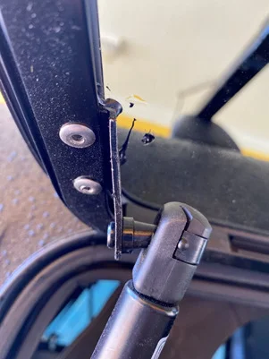

One of my side window struts popped off today and refuses to stay connected when closing the window. It looks like the bracket that attaches the strut to the window is bending with use. I believe these brackets need to be made of thicker material or the geometry of the hinge needs to be modified to alleviate this. By the time I publish this, I will have contacted Mike and I am sure we will find a way to resolve my issue.
The bracket here on the left is fairly straight, but you can see that the others are all and different degrees of twisting or bending. I will admit that I have done a poor job of taking it easy and using both hands while closing the windows. Mike is aware of the issue as they have the same problem with their company vehicles. They are working to find a viable solution already.

Good looking top. I like the opening of the side windows. And yes flush style latches on the sides would look better to me. Can the sides be ordered without the slider? And the rear hatch opening without having to open the tailgate is nice but with a spare tire what's the point. I think with a little feedback and tweaking it could be great. Thanks for the pics.

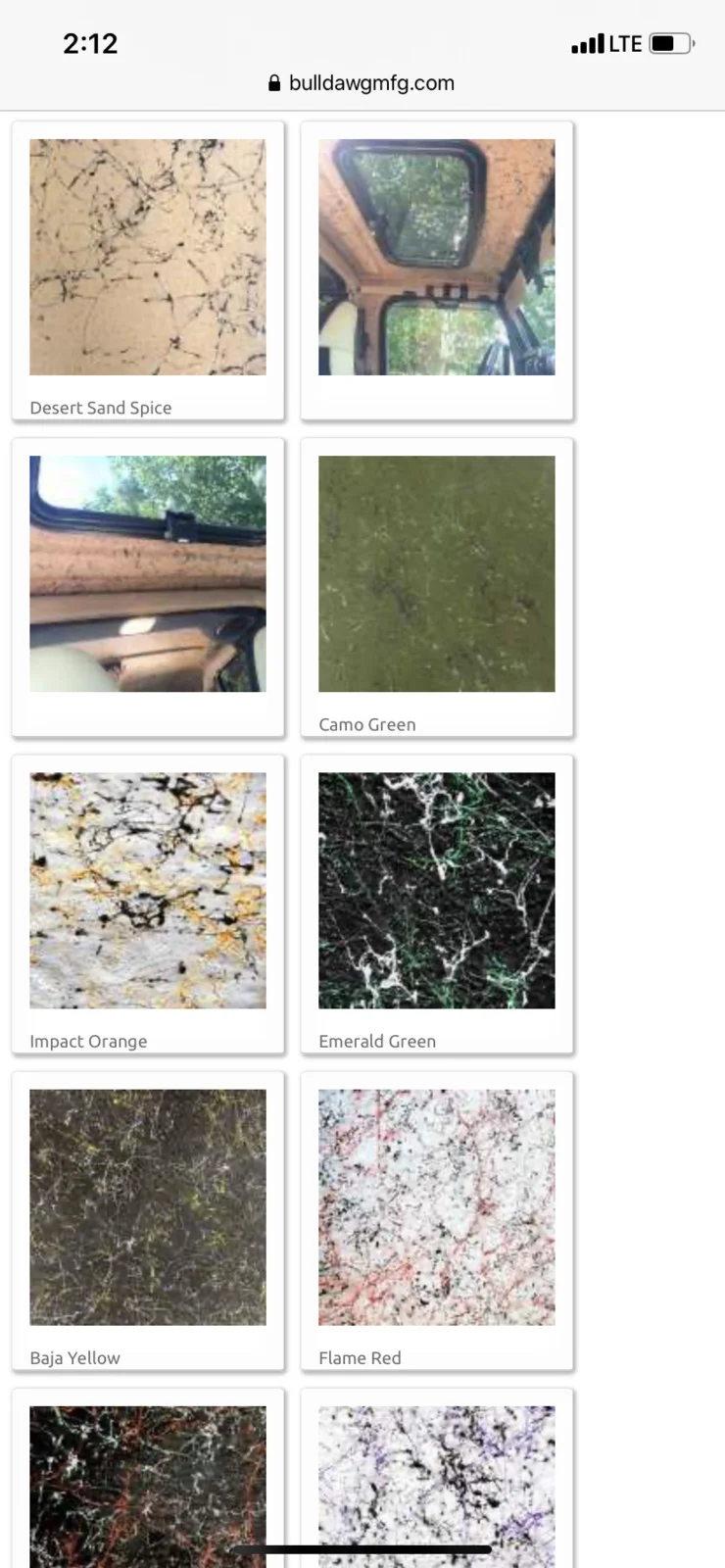

Ive not seen any solid color options from them but I would imaging they can do what ever you want based off their other tops custom color options.

I was looking the how the windows are installed into the frame and it looks like the side windows could be easily removed (but not recommended by the manufacturer). The main problem is the rear window. The hinge for the rear is recessed so the top itself would block the rear from sliding off.
It appears that you might be able to remove this screw and slide the hinge off. Dont think Ill be trying it though.

Bulldawg mailed some replacement 30lb struts vs the original 40lb struts for the side windows. This remedied the issue with the brackets bending.

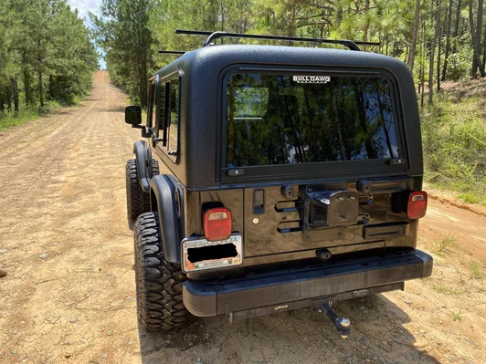

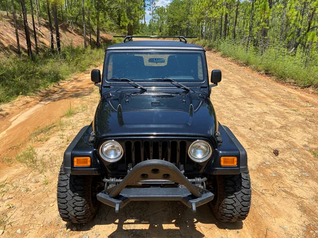

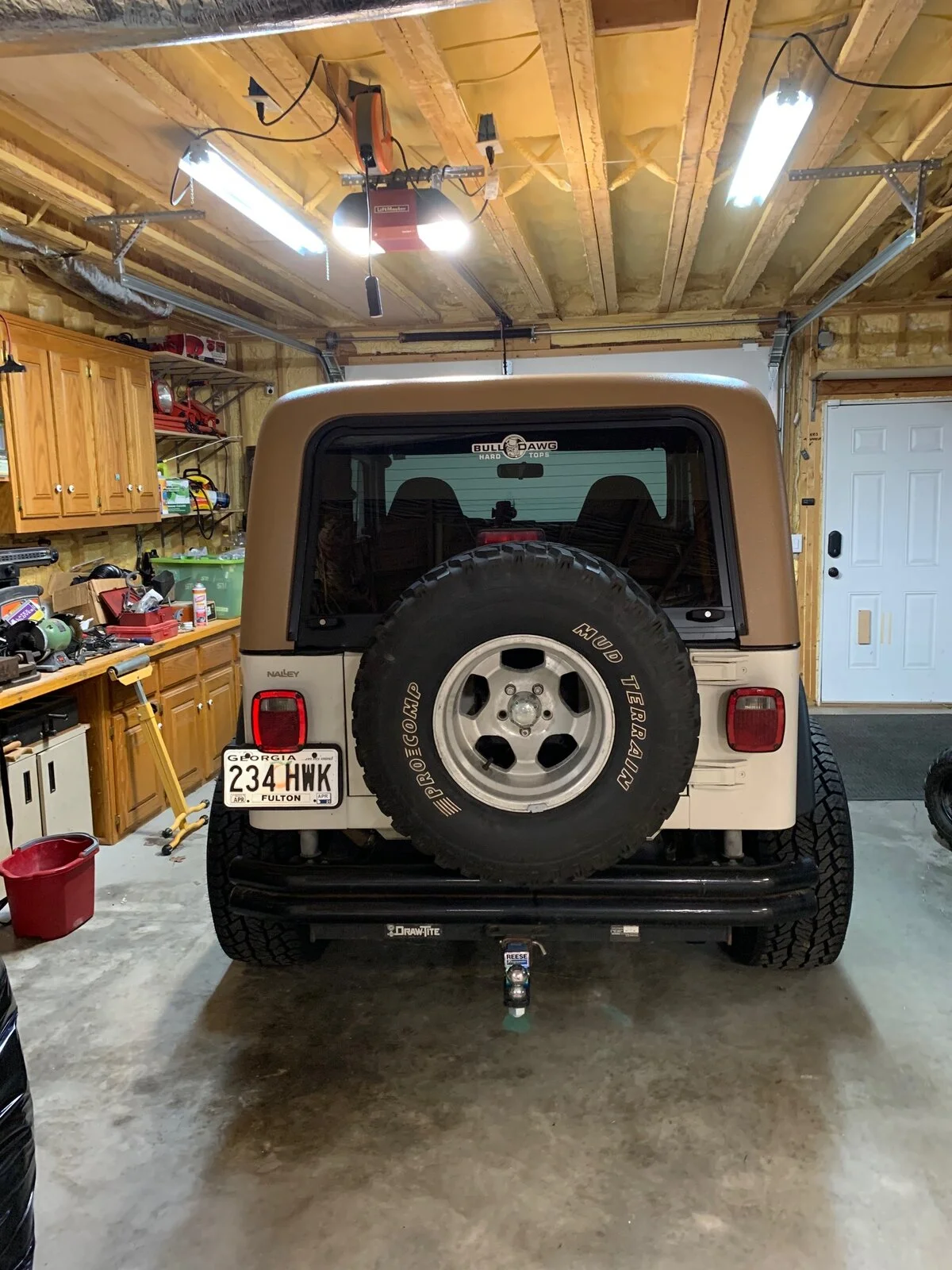

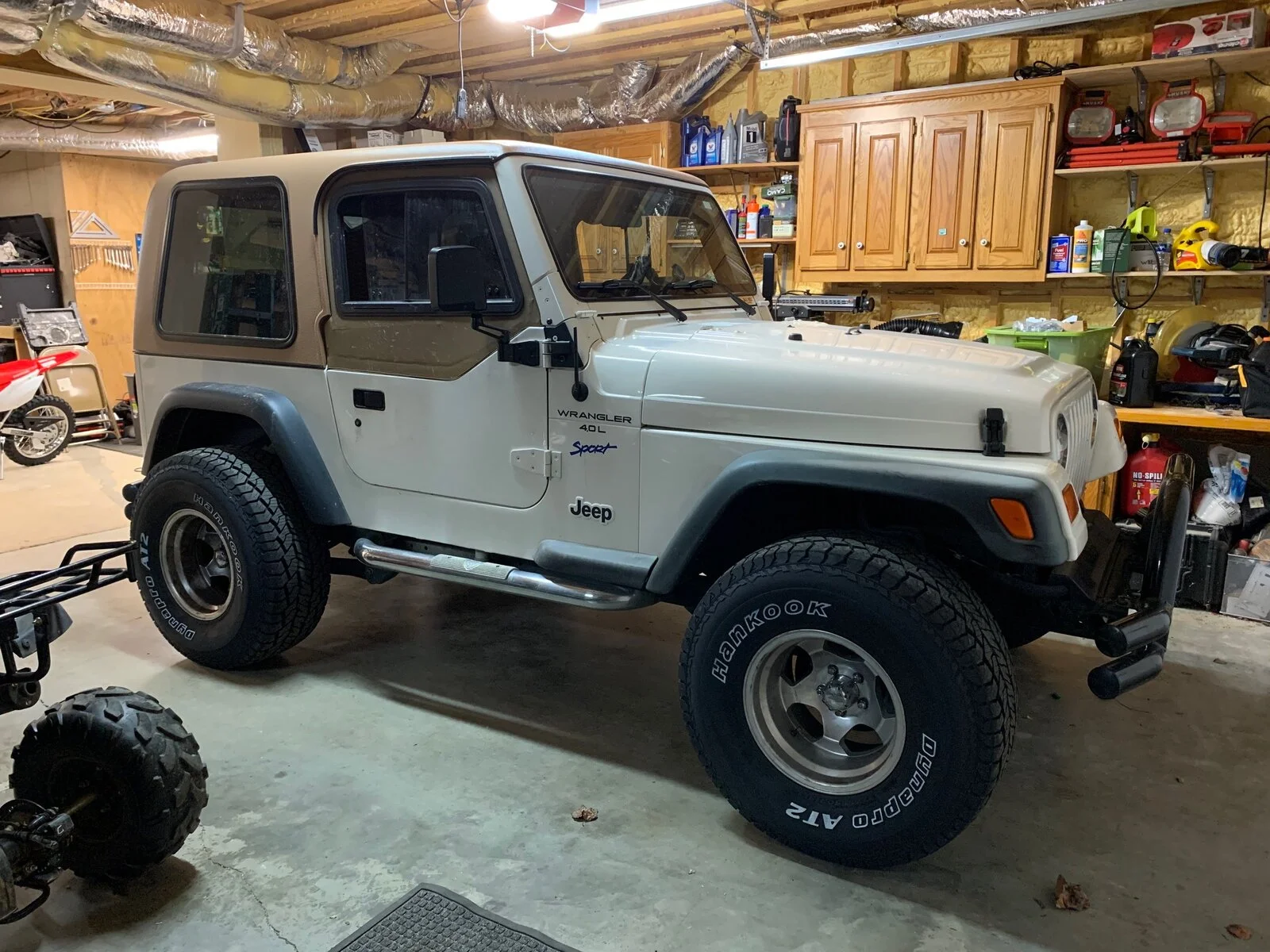

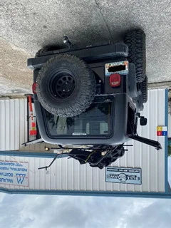

A new BullDawg top was put on our TJ shortly before we picked it up. This is my first TJ so I don't have knowledge of the original top but this one seems to be very well made and I think it looks great on the Jeep. Mine has fixed windows on the sides that do not pop up.
