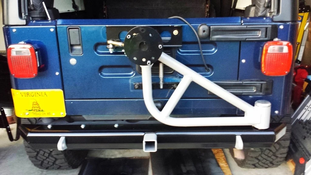

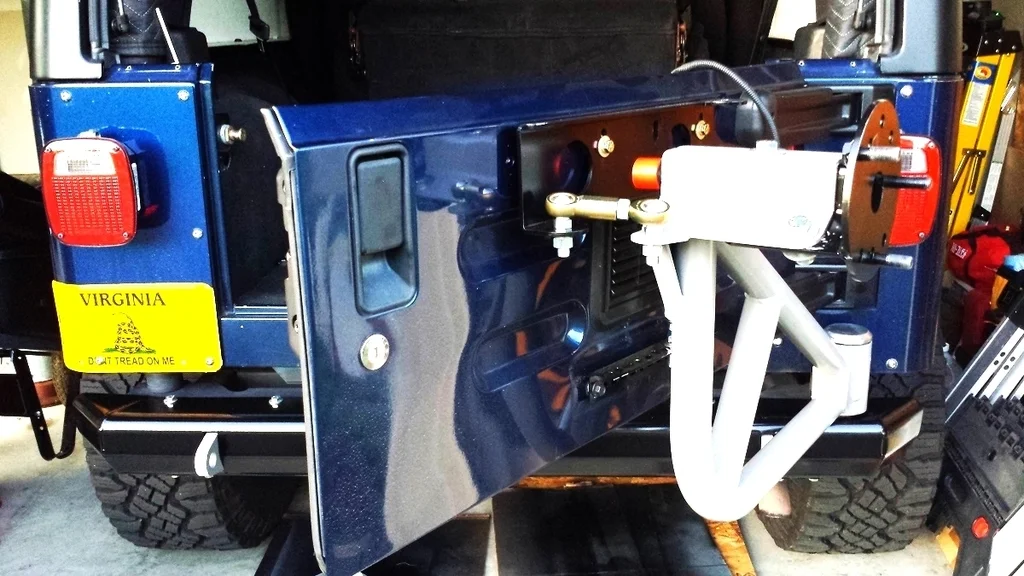

Not all swing out carriers are evil. I've been running with a UCF version that I've been very happy with. However, it's one of few that attaches to the tailgate, as well as being the only one, I'm aware of, that has a steel core and aluminum cover. This helps keep the weight down. The only issue I've had is having to tighten the nut a couple times that puts pre-load on the swing out bearings.
That said, I wouldn't necessarily advocate for it now. When I bought mine, years ago, it was a little over $900 on sale. It's now $1250. At that price I'd buy a Savvy bumper and MORryde.
The way that attaches to the tailgate is very similar to the way the AEV tire carrier mounts on the JK. I had one on my JK and it was the only bumper mounted carrier I’ve ever liked, and I liked it quite a bit actually.
I didn’t know something similar existed for the TJ. My experience with traditional bumper mounted tire carriers for the TJ is that they are terrible. This looks to be the exception.
