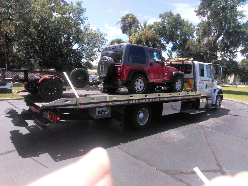

Came in on the hook...
Update: Long story short, after consulting with the one mechanic, its going to another shop tomorrow - both the 1st guy, as well as my Mercedes mechanic, recommend them.
Talking to the 2nd guy - he's going to start with the fact that it overheated, possible sticky t-stat combined with the computer going into limp mode. I've driven the Jeep twice since I got it home, close to home, about 2 miles. It exhibited NONE of the problems it showed on the road trip - so this guy may very well be exactly right. In any event, it'll get checked out by somebody that knows more than I do.
AND...

Another update:
Drove it down to the mechanic today (with no observable problems), who proceeded to do a complete cooling system check - finding nothing. No DTCs, no nothing, everything perfect. Which was what I originally expected. He was about to give up until...
... he put it on the lift. He wasn't aware there were 3 cats on the thing, and the rear cat showed bluing! So that's gonna be taken care of along with mounting a new muffler. I asked him if it made sense to replace the front cats at this time, he said it really did not. The guy is honest - THAT will be remembered.
Oh, and he heard a rattle in the rear cat as well - which I had been hearing for some time.

Its home. Drives fine - the exhaust rattle I've heard the past year or so is gone. Exhaust is slightly louder than before. There were bits of ceramic falling out of the old cat. However, the "blue spot" they found wasn't a blue spot - it was over sprayed black paint from my painting under the Jeep! There's no question the cat was bad, and I'm 99% hopefully optimistic that that was the real problem, but that wasn't a blue spot! I didn't enlighten them...
They were very impressed that the cooling system was in great shape - which made me feel good about my working on that. Also, the tow truck driver who brought it home for me was impressed with how the parking brake held the Jeep on his tilted flatbed. That was very recent as I hadn't been able to adjust it correctly until I replaced the mass of rust adjuster dingus under the Jeep.
And he also thought that the radiator was a bit on the small side - I'm inclined to agree with him.
