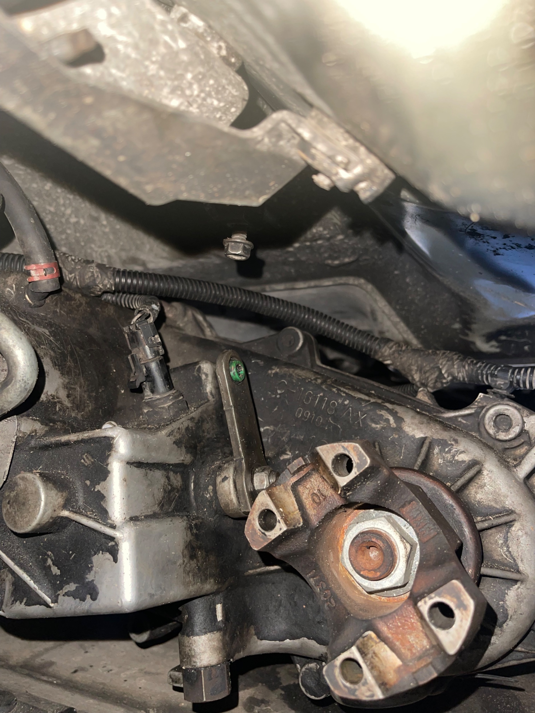

There has been major confusion in this thread caused by what I would say is questionable information given. I think at this point we need to see a photo of the shifter plate on the transfer case to make sure it's not upside down (it can be used either way potentially), and reevaluate that he is understanding which position of the lever equates to which drive mode of the t-case.

Can you upload a pic of the shifter plate that you are shifting? I'm wondering if you got it upside down and are confused about which position is which.

Again I thought he'd disconnected the shifter and was shifting the t-case by hand? If that is the case then the shifter plate has nothing to do with it. And that is what he said.

You're in 4LO right now. Now try moving it forward as far as you can. It should go 3 clicks. Neutral then 4HO & then 2WD. If it only goes into 4HI still take it for a drive and let us know what it's doing.

He’s shifting the transfer case by hand using the lever bolted to the sector plate…look at his photo, his plate is upside down for a TJ.

I shouldn’t say questionable, it more a lack of information we can work with to help. With no pics we can’t do much. The pic of the lever helps a lot.
He needs to flip the plate and reevaluate each shift. The plate is facing up which is how it should be on a YJ…down on a TJ.
Drive went great. Okay so I’m in 4H now. I wasn’t able to get into 2WD but I’m thinking maybe like the other guy said I have the plate the wrong way. Gona flip it around and see if I can get into 2wd

Worked. I’m in 2H now. I’m gona reconnect the linkage
