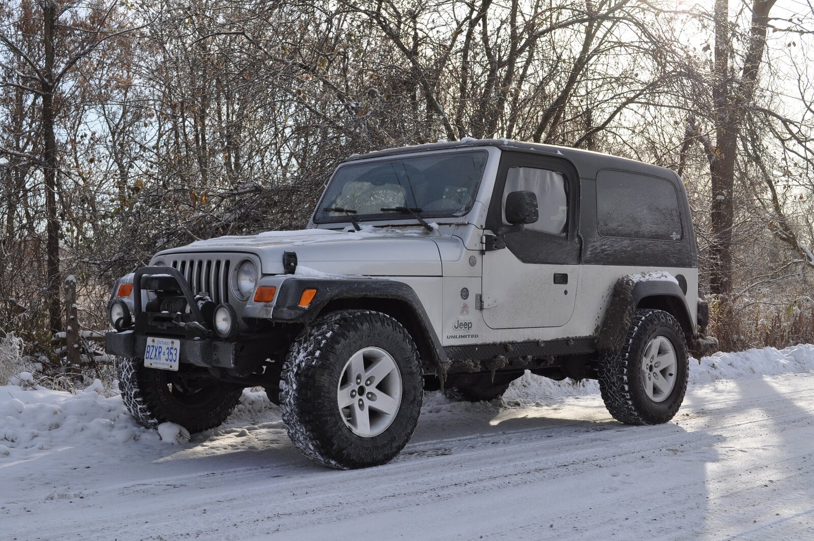

I have a 2" lift on my LJ and have 265/75/16 Load Range "C" Goodyear Duratracs. I don't have any rubbing issues.
@reconeTJ - I'm from Canada 🇨🇦 too and usually get my tires at Canadian Tire. Duratracs go on sale about every 3 or 4 weeks. I bought the same tires except 245s for my XJ about a month ago. They even say "Made in Canada" on them. (y)
That Jeep looks a bit low to have a 2" suspension lift with 265 75r 16 tires.
It looks like it is still at stock height. What brand of lift is that?
That's definitely what it has. It's just a 2" pucks and stock springs. They have 165,000 kms on them (a little over 100k mi.) so maybe a bit worn but not bad.

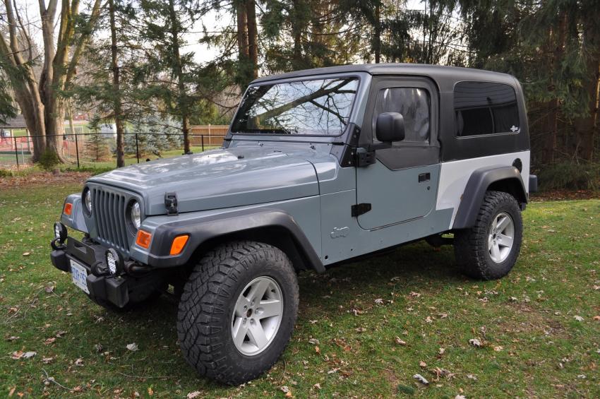

Here's my TJ with no lift and 245/75/16s for comparison. I've never put 265s on it but I think it would be tight.

Or maybe my Pro Comp 2" lift springs are a bit high? In looking back at the pictures in this thread, my 2" lift looks more like the other Jeeps with 3.25" lift and the same size tires.
I don't know what the dimensions are for a TJ but there's an easy way to check stock height on an XJ. There must be on a TJ too.
On an XJ, you measure straight up from axle tube to the bottom of the uniframe rails (that's the term Jeep used vs. unibody). If you have 6.75" up front and 8" in the rear your suspension is stock and there is no lift. I have a 2" lift on my XJ and the numbers are bang on - 8.75" front and 10" in the rear.
If you know you have no lift and your numbers are less than the above you can be sure your springs are starting to sag.
Anyway, my LJ runs fine. No bottoming out, no unusual road noise, good even tire wear, no bouncing, no leaning, etc. It sees some off road use but nothing crazy and nothing that would have damaged it. The above pic is about 3 yrs. old - about 75,000k mi. I took the one below last summer and it actually looks better!
