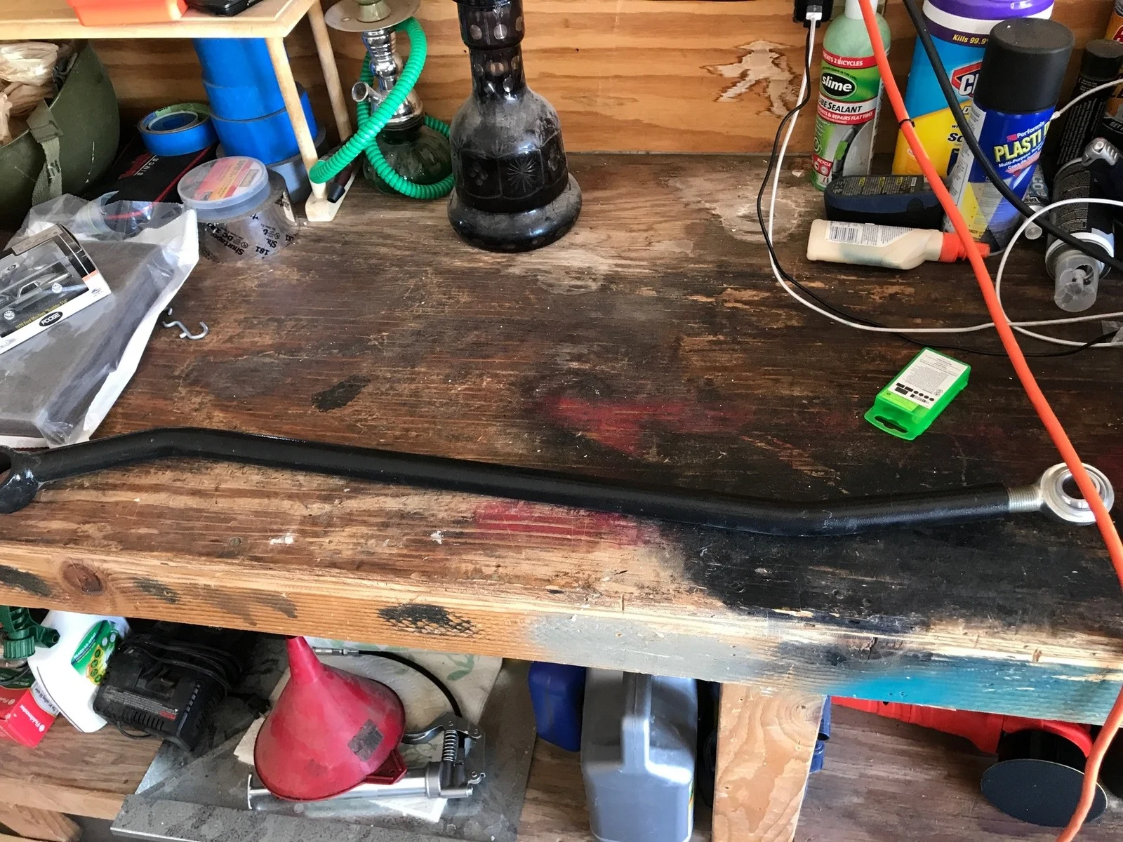

Blank TJ Enthusiast Joined Mar 23, 2017 Messages 514 Location Alamogordo, NM, United States May 20, 2017 #1 This track bar came off of a Cherokee and I am curious if it will work on my Tj Sent from my iPhone using Tapatalk

Chris Administrator Staff Member Ride of the Month Winner Joined Sep 28, 2015 Messages 71,051 Location Gillette, WY May 20, 2017 #3 Yes, the Cherokee XJ track bar is interchangeable with the TJ.
OP Blank TJ Enthusiast Joined Mar 23, 2017 Messages 514 Location Alamogordo, NM, United States May 20, 2017 #4 Awesome so what do I need to make it work Sent from my iPhone using Tapatalk

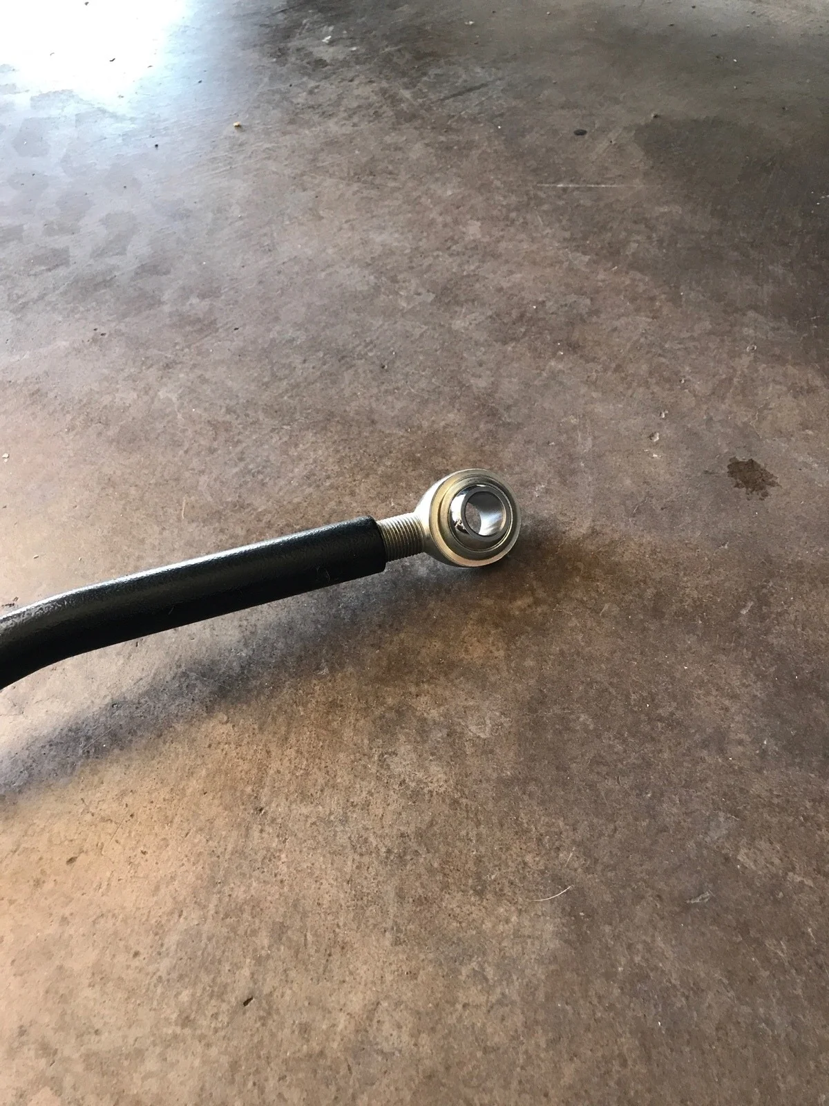

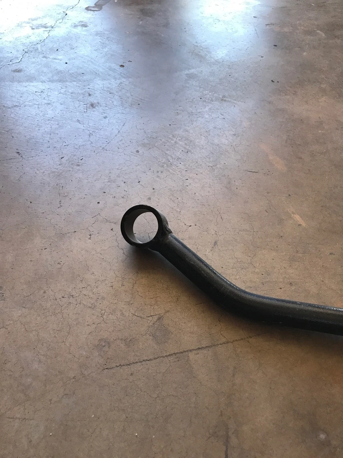

Jerry Bransford Retired to more relaxed pastures... bye. Supporting Member Joined Nov 9, 2015 Messages 29,739 Location Fleming Island FL May 20, 2017 #5 You'll have to figure out what brand of track bar it is to know what bushing and driver's side mounting bolt it requires, that is not the OE track bar.
OP Blank TJ Enthusiast Joined Mar 23, 2017 Messages 514 Location Alamogordo, NM, United States May 20, 2017 #6 That's the million dollar question Jerry Sent from my iPhone using Tapatalk Reactions: Jerry Bransford
