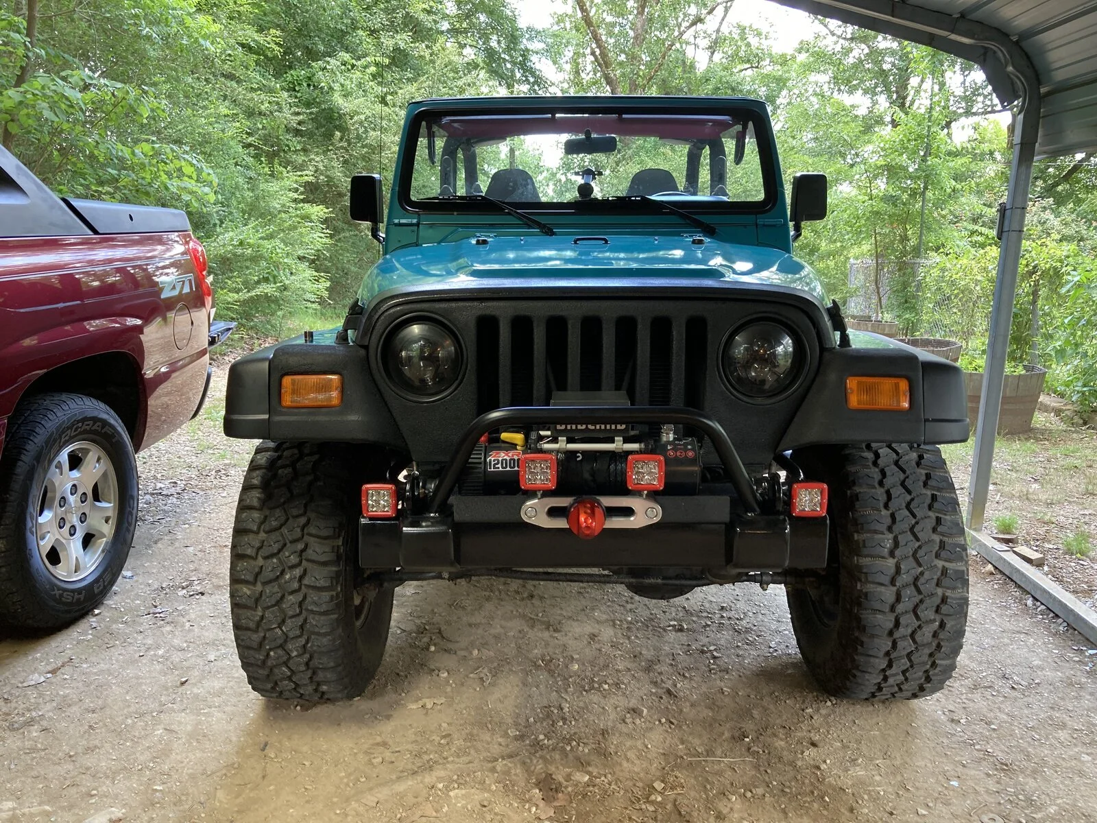

The factory front bumper? Brother sold his JK so I might have a winch and UHF coming my way.
You will need a winch plate.

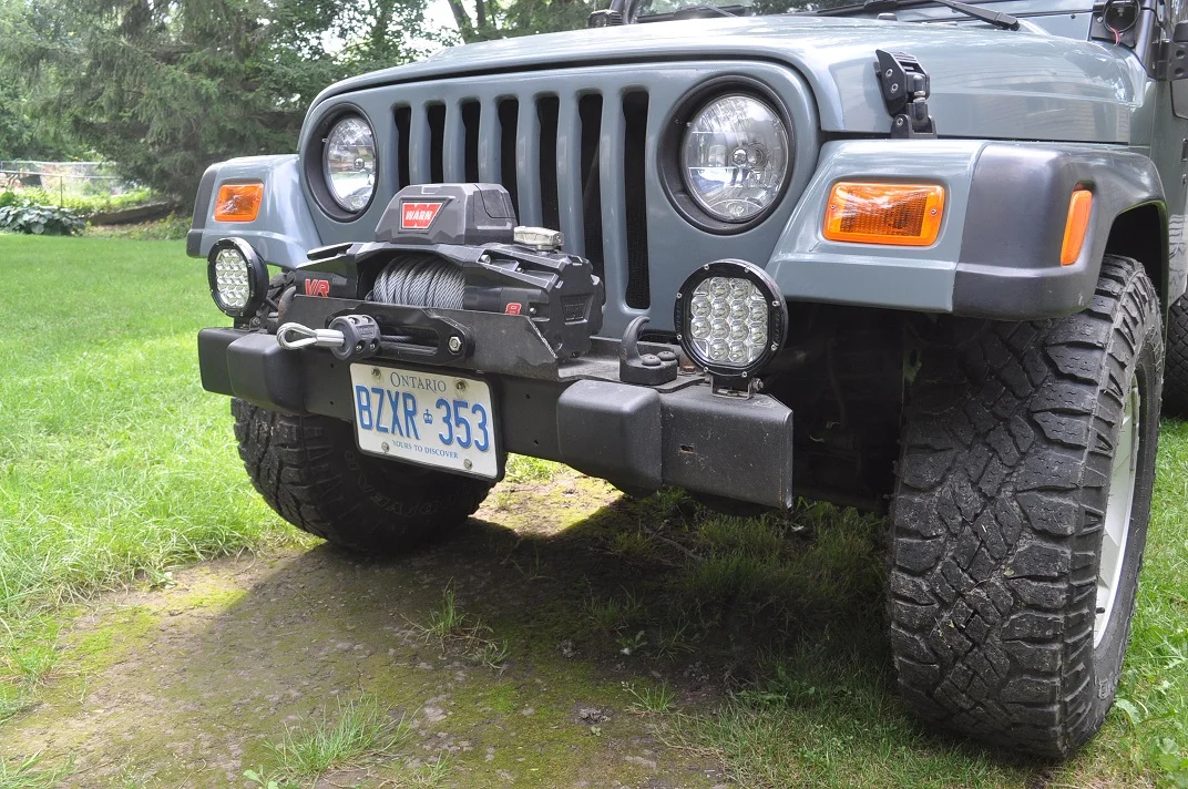

Canada too. I see Jeeps and other vehicles without bumpers but you can't get one certified without them and you can certainly get pulled over if you don't have one or both.
I like the stock bumpers too. (y) I cut my front one down by 3-3/4" on each end and duplicated the original angle so I could attach the plastic end caps. I had a Warn winch plate on it previously but for some reason it wouldn't accept the Warn winch I got. I put on a used cheapy and it works fine.

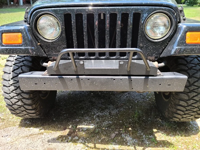

I think your reading what Jerry said a little too literally. He is correct the bumper is irrelevant to the mounting of the winch plate. I don't think he was suggesting you run just the plate and no bumper on your jeep. There are aftermarket bumpers that integrate a winch plate into them and then there are winch plates that should be firmly attached to the frame.

@Fishtaco I ordered my winch plate today from eBay - $79 delivered to Perth. May need a slight mod or two but should be OK. Dominator Extreme 12000lb winch from Kings 4WD for $350 today from their Malaga store and that's all that's needed. Like you, I prefer the look of the original bumper. Happy to share my results with you once installed - be a week or two before that's finished. This is the winch plate I got - the photoshop skills on the ad are freaking hilarious by the way! https://www.ebay.com.au/itm/1747671...d=link&campid=5337789113&toolid=20001&mkevt=1
