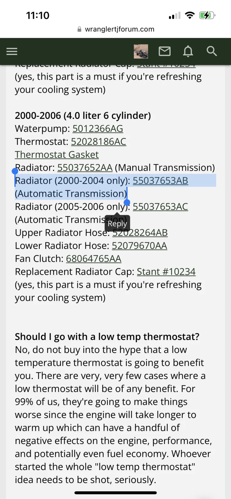

Hi @Huff1371 I've found myself down the same internet search as you; The Cooling System Overhaul FAQ lists the 55037653AB as the right replacement for our 2000 Saharas.
