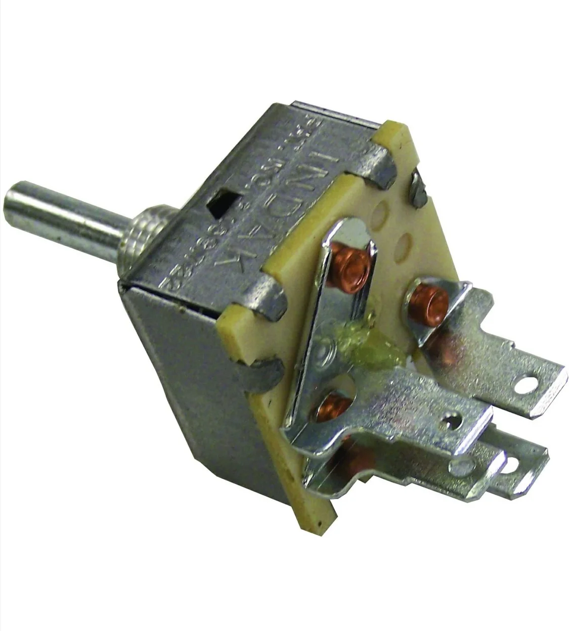

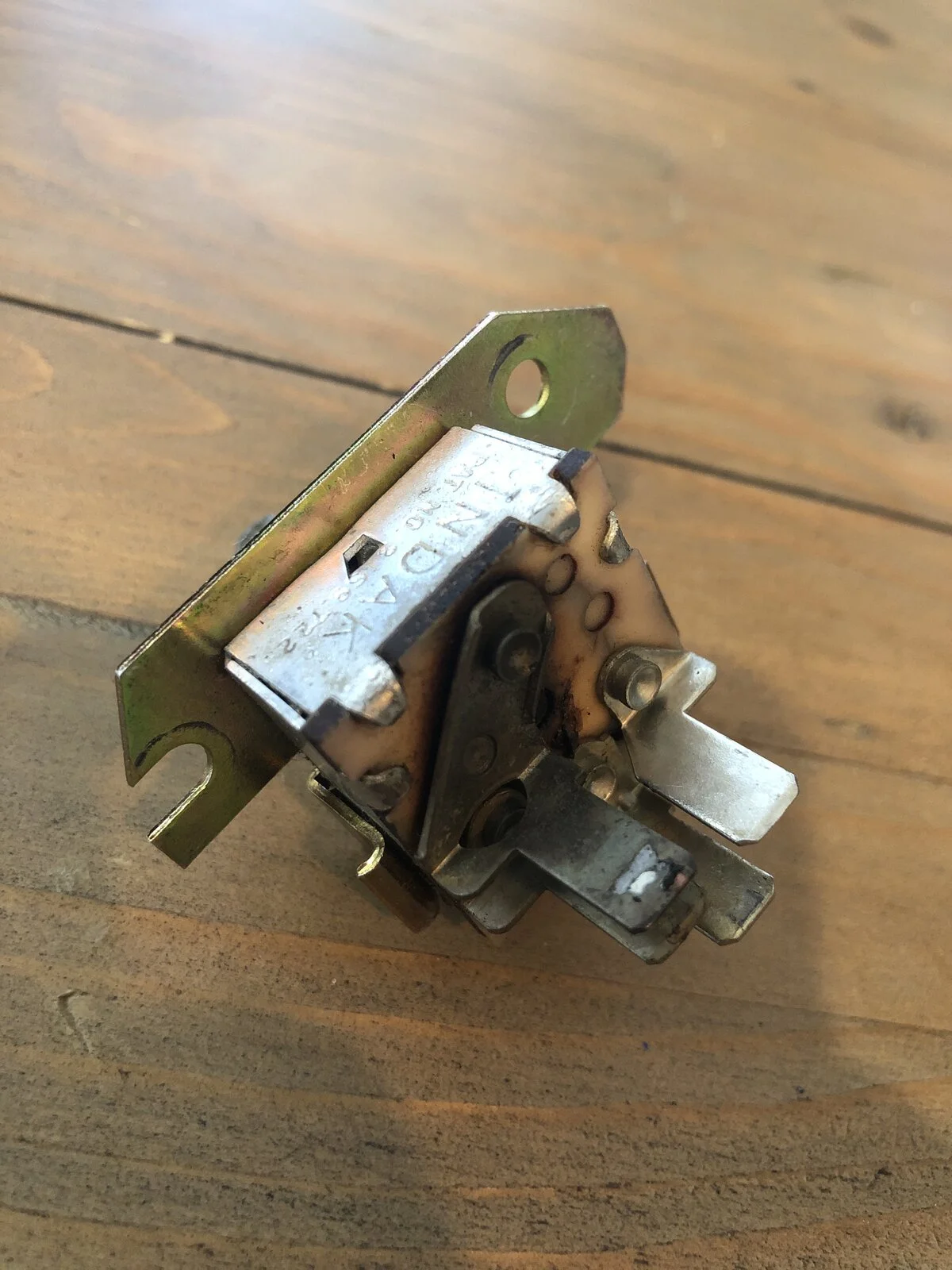

Pretty sure my early 97 switch is a CJ switch in different case (J5462784)
I am thinking I can open the tabs and swap the housing out see the pics to compare, both are 4 connectors and the configuration looks the same
Any thoughts?

Any reason I can't bend the tabs back on both, swap the boards then bend the tabs back down?

I did not, right now running without the high blower working. I need to find a way of breaking the CJ switch open without destroying, or figure out how to rewire that the switch is on medium is actually blowing on high, in DFW if you need AC, you need ALL the AC.
