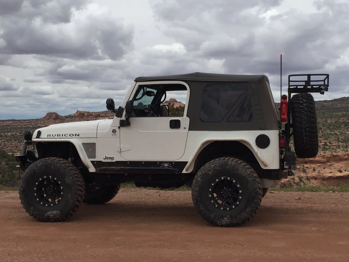

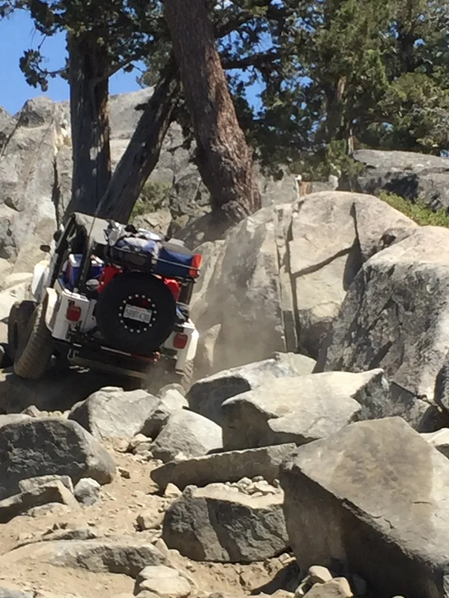

I ran the Hard Rock 4x4 rack also for years. I used it for lite weight things like sleeping bags etc. I also did not like have any amount of weight that high up. When I would get off camber I could really tell if I had a lot of weight on it, but again if you use for lite stuff it's fine

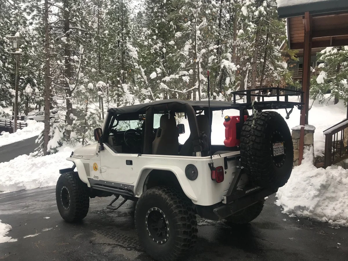

I believe the cargo rack is rated to 100 lbs. Which seems reasonable. Combined with 2 full Jerry cans, up to a 38” spare, a couple antennas, and a Hi-lift, it ends up being an impressive amount of weight on the bumper. They also rate the bumper to tow whatever the vehicle is rated to tow (so up to 3500 lbs GTW for an LJ).
In addition, the rack is both height adjustable (4 positions) and depth adjustable (2 positions). The way you have yours set up is great for the hard top. I set mine at the closer depth when I’m using a soft top.
