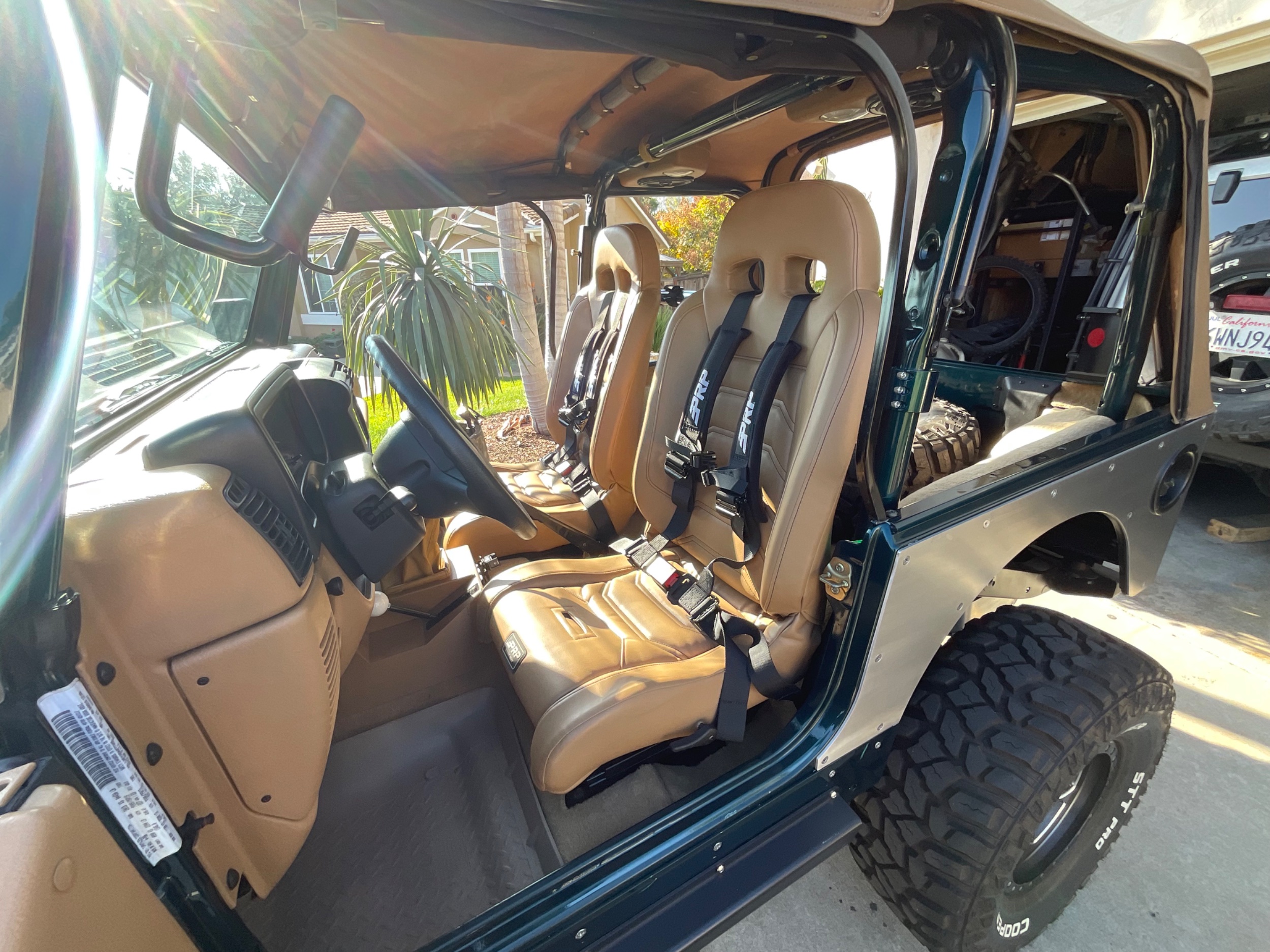

I have ACC replacement carpet in the doeskin color , they sell a few shades of tan
