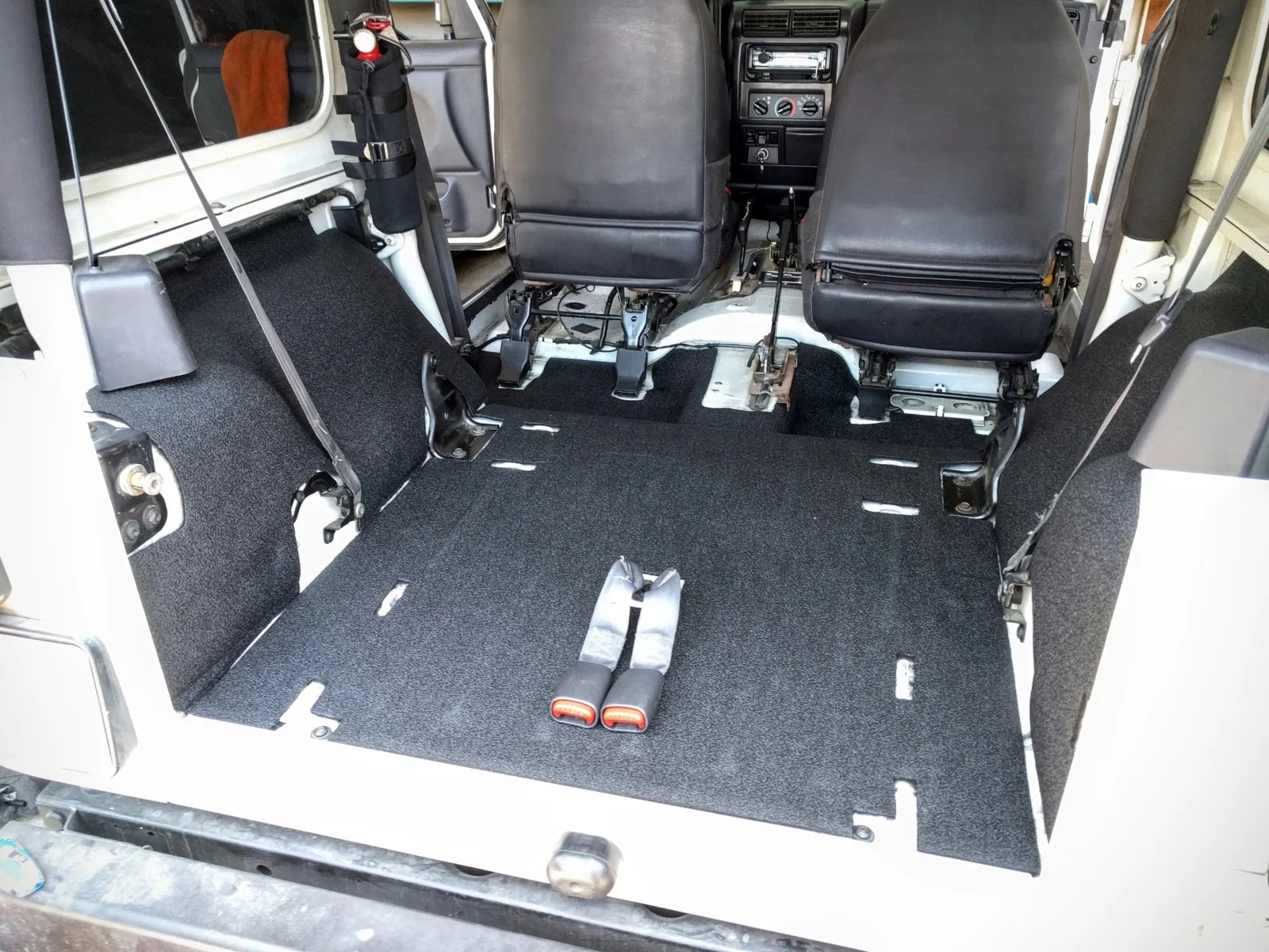

I used the bedtred because its less carpet-y, and love it! It's like bedliner that you can take out anytime you want and put back in. Power-washable, uv resistant, and wipes clean easily also.
Tough stuff!
This pic is from when i had just gotten the back installed (My install job was a bit crappy because of my effed up hands, but it's easy if you have normal hands!)
