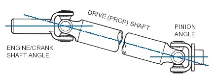

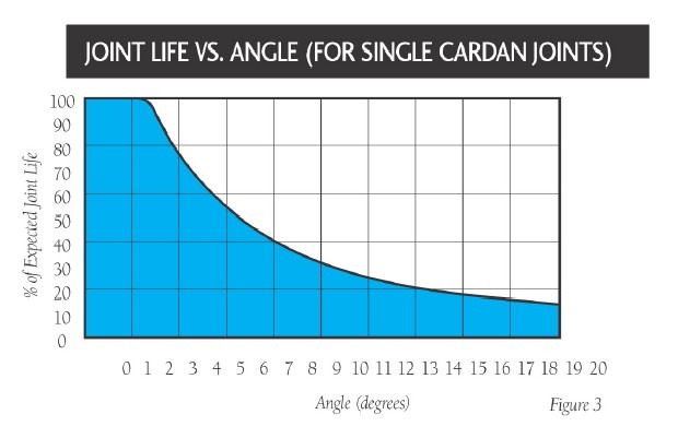

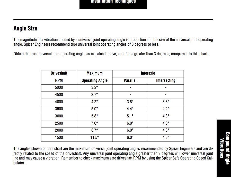

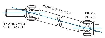

@EROCK, in the interim between removing the TC drop, adding SYE, and DC rear driveshaft. Adjust the rear pinon angle to match the TC output shaft angle, measure the driveshaft angle, then subtract the pinon angle from driveshaft angle. The remainder is the operating angle of the u joints. A severe operating angle will shorten u joint service life, and can potentially cause damage within the transfer case. In the table and graph below are limit recommendations from the stock u joint manufacturer, and the drawing on the right illustrates parallel output & input shafts.
spicer operating angle.jpgSpicer u joint life graph.jpgDrive Shaft drawing.jpg
Here's an example of how to use this information. Let's say the TC and pinion are at 7 degrees each, and the driveshaft is 14 degrees, subtract 7 from 14, which leaves a remainder of 7. Seven degrees is the operating angle of the u joint. Spicer recommends not exceeding 2500 rpm with a 7 degree u joint operating angle. There are variables, but keep it simple for the time being. With as much TC drop is on there now, I don't think the operating angle is going to be extraordinarily severe.

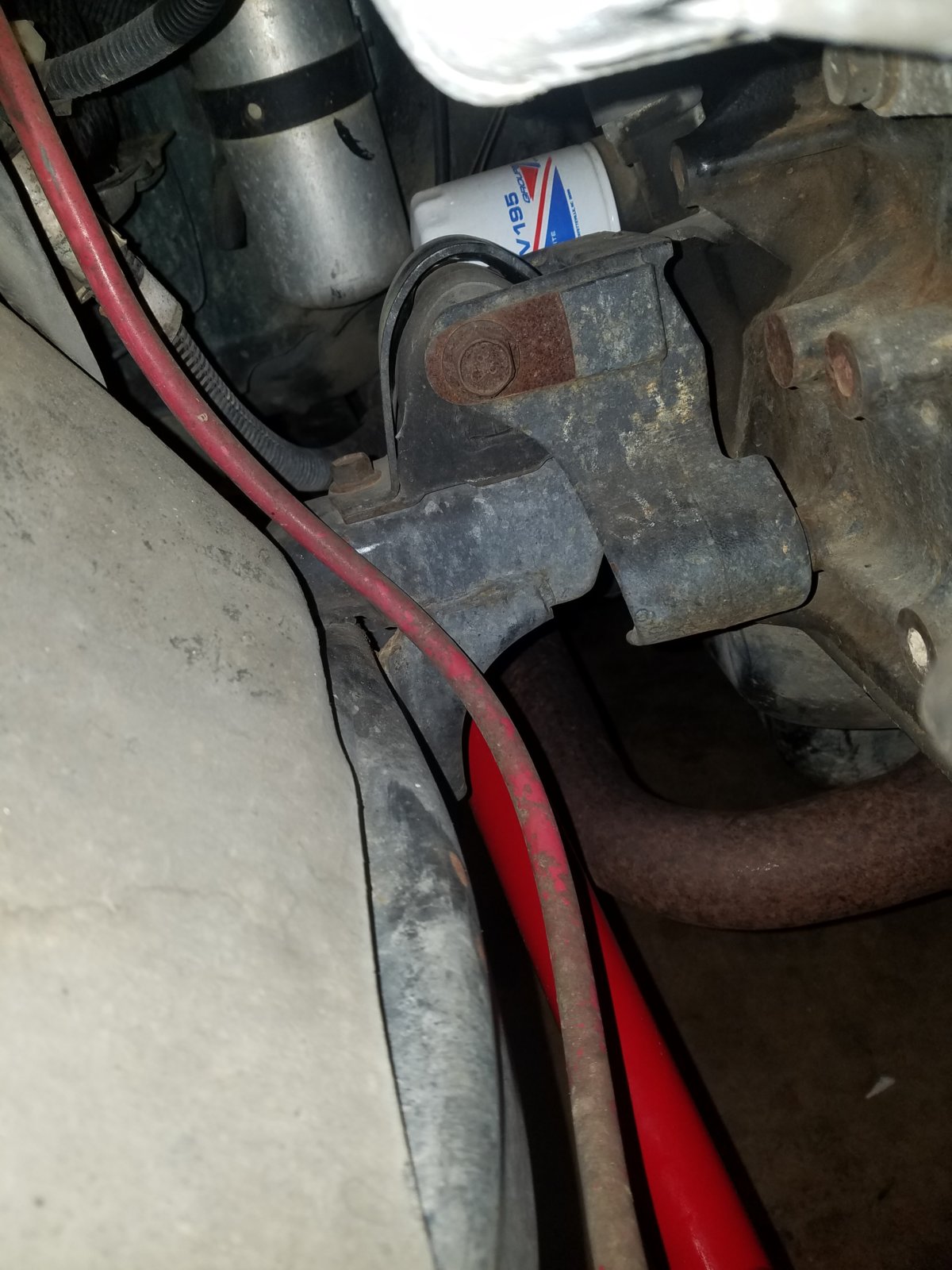

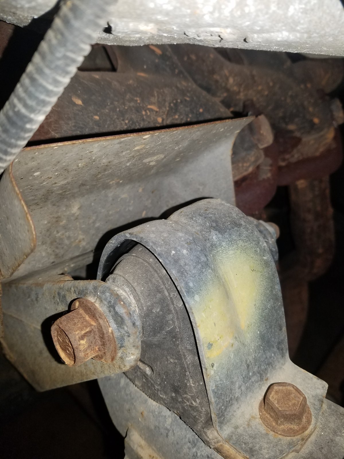

Take a picture of the engine mounts and share the images with us please.
View attachment 73924View attachment 73925View attachment 73931

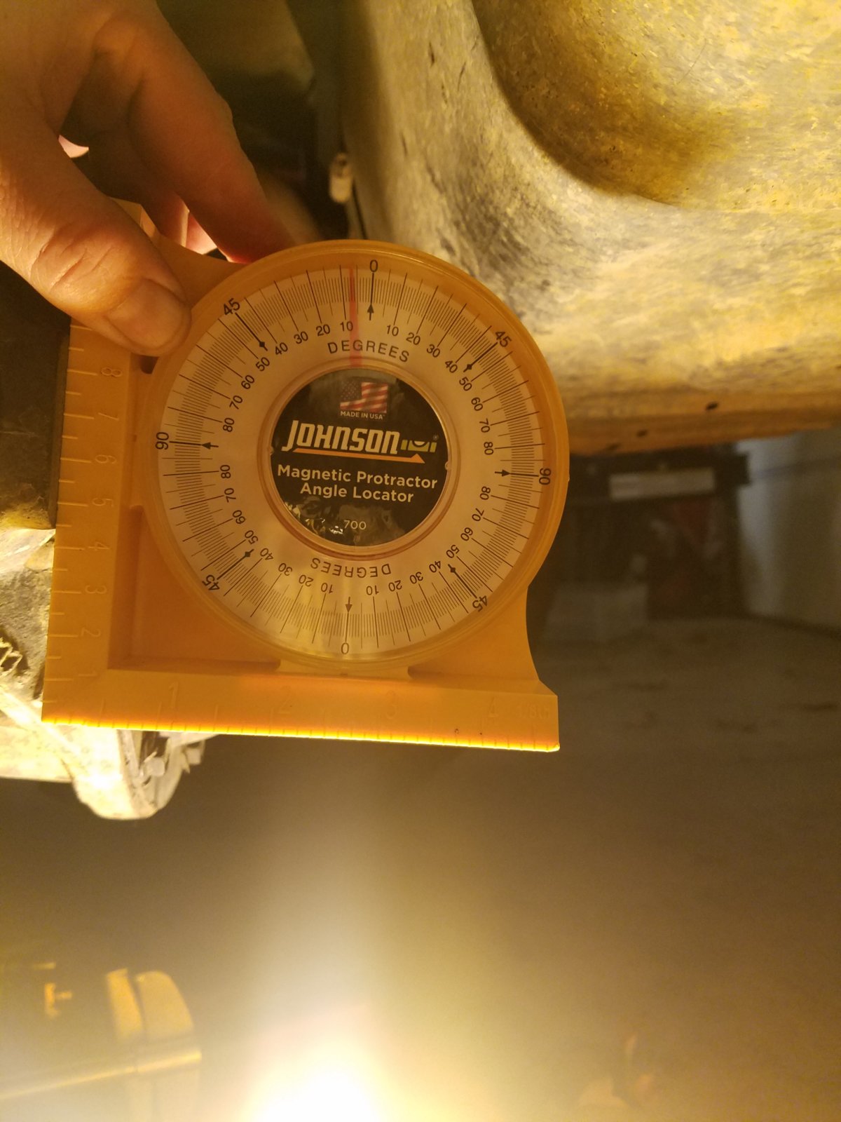

Man! This is great info. I drove my Truck to work today. So I'll get a pic of motor mounts in the daylight tomorrow. I did take quick angle measurments on the Harmonic balancer and the rear diff last night. 81 degrees on the Harmonic Balancer and 77.8 degrees on the rear diff. That's perpendicular measurments of course and I know this doesn't matter really until I get them parallel and see what my drive shaft angle is.

Any chance you can put a clearer pic of this diagram up. I can't read the numbers.

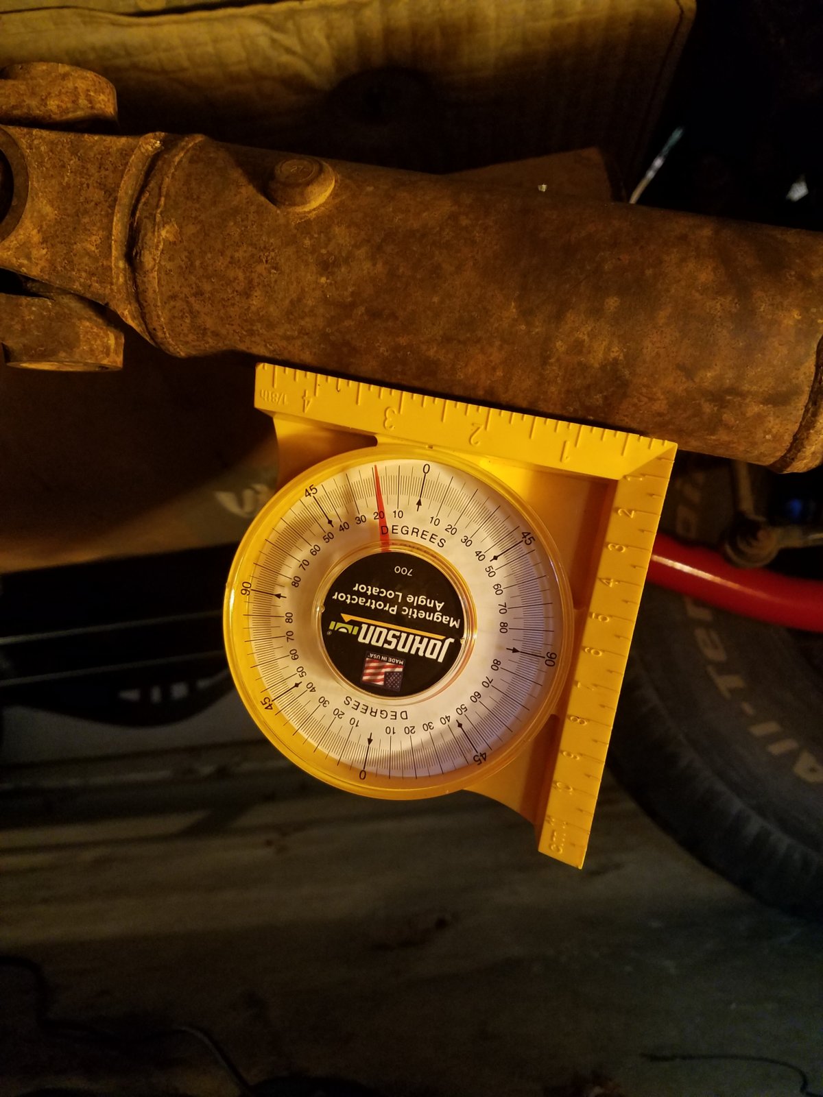

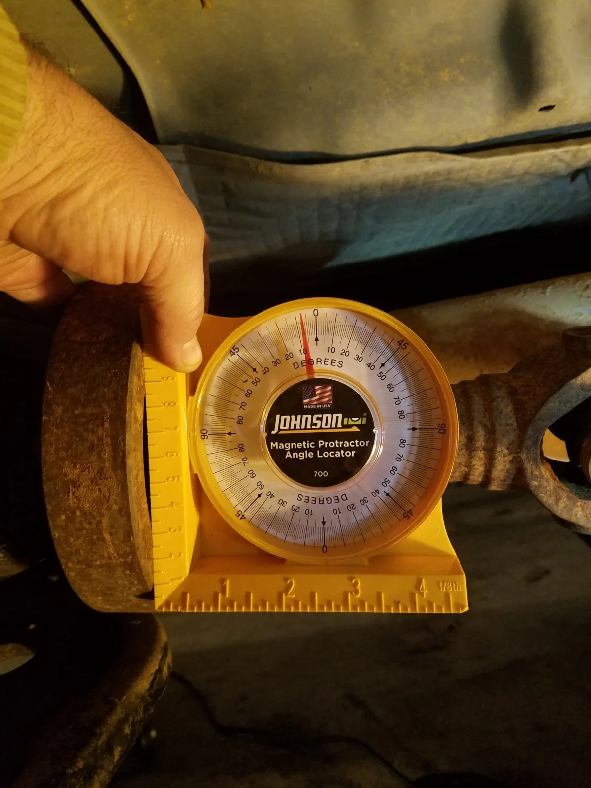

I adjusted the rear diff to be 1 degree below the TC. The following measurements are what I got.
Harmonic Balancer 7.5 degrees
Drive shaft 18.5 degrees
Rear Diff 6.5 degrees
Wierdly it now vibrates, it didn't before but now it does, especially under hard acceleration. I only drove it maybe a mile.
Did you click on the image to expand?
Thanks for the engine mount pictures. I was curious to see if it had a riser beneath; it does not.

I adjusted the rear diff to be 1 degree below the TC...Wierdly it now vibrates...
Raise the pinion 2 degrees and try again.
You need a digital gauge. :)
Rotate the output yoke so the u joint is vertical. Place a socket on the cap and measure again from the socket top.
