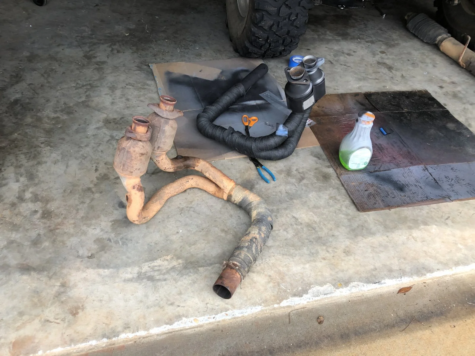

Jkelly,
Hopefully you’ve fixed this already.

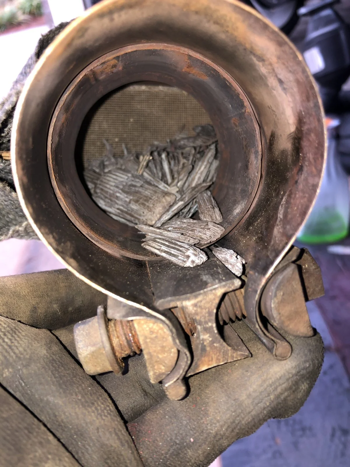

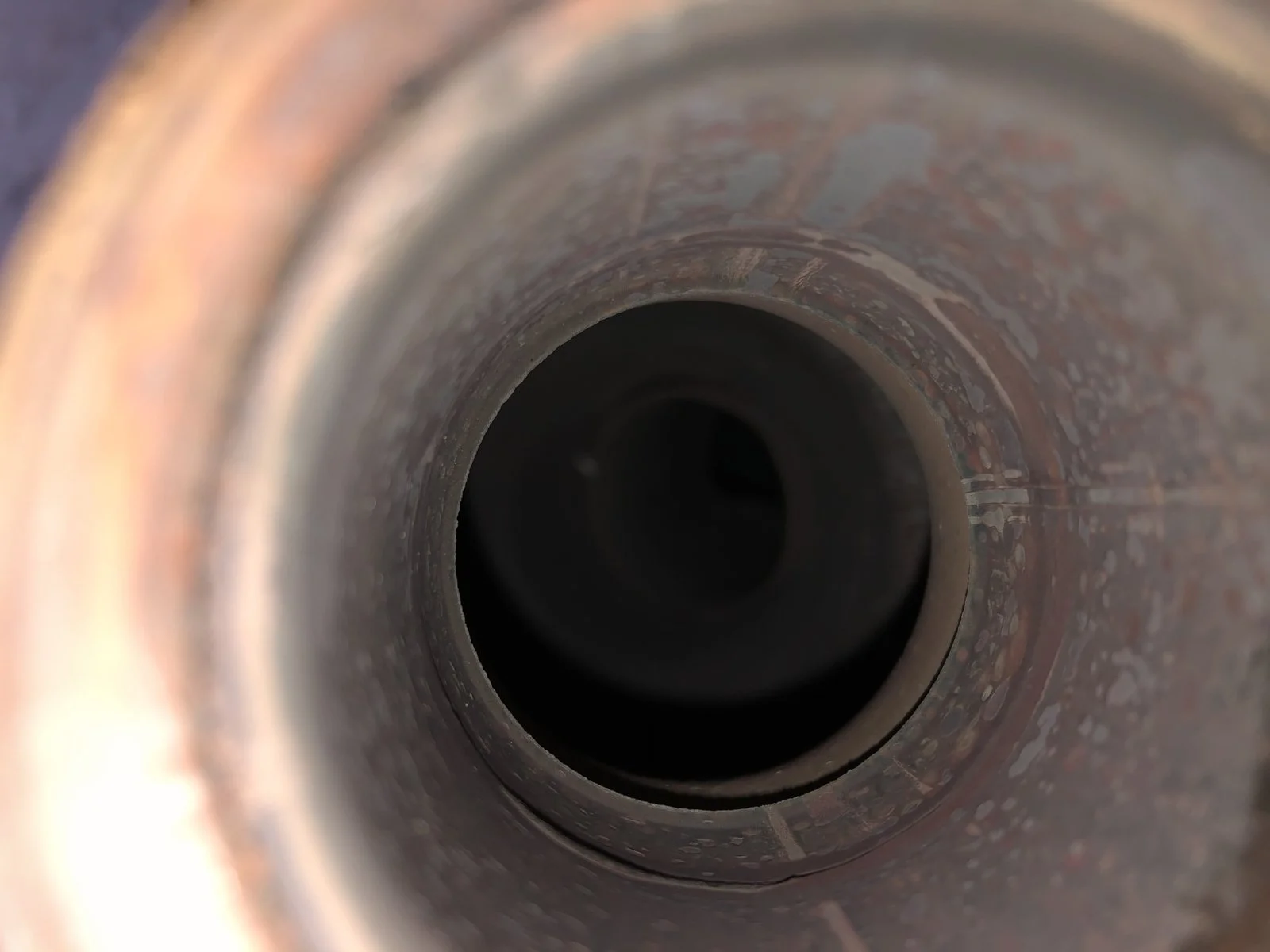

However I just completed the job.
Replaced my Y down pipe as the rear cat is gone, completely gutted inside. The debris are embedded in the lower (3rd) cat.
I found parts off cheap auto parts and rock auto. The rock auto were the o2 sensors and they are Denso. Direct fit and color coded like the original (white clip in the rear, black clip in the front). The y pipe might have been from outside the US, however after I painted it and wrapped in it exhaust wrap, it won’t flake from corrosion like the Chrysler one.
Got exhaust mounting flange bolts (4) from the dealer.
Went together well. I did not change the upper, exhaust o2 sensors although I should have considered that.
In total my cost was around 300. Did all the labor myself over a few days after work and such. Got all the exhaust put back together in about 4 hours. It’s a bit of a difficult install getting the stud bolts to go into the flange with the heat shielding in the way.
I used 15 mm sockets and 5/8 wrench. They both fit about the same but 15 mm seems to be the correct size.
Rock auto also sells a o2 sensor socket specially built to remove o2 sensors. Works great.
Here are some pics of what I found
