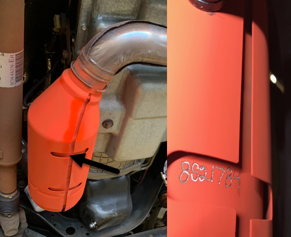

MARKING OPTION
Mark the catalytic converter using an etching tool and a bright color heat-resistant paint. Required items for marking (Charge to garage overhead):

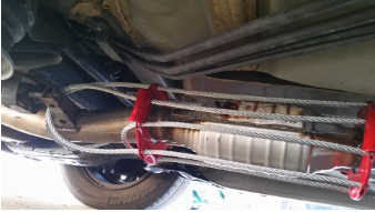

CLAMPING OPTION
For vehicles requiring more protection, the catalytic converter can be secured to the vehicle using securement clamp. The clamp shall be used in addition to the marking. Required items for securement:
Catclamp (https://catclamp.com/) (Create and charge to SAP Work Order.)
Parts list:
· (2) Top clamps (threaded) · (2) Bottom clamps (non-threaded) · (4) 2” shims · (4) 2.25” shims · (4) 2.5” shims · (4) 2.75” shims · (4) 3” shims · (4) Security bolts · (1) Security bit · (2) Heavy duty zip ties · (1) 40 ft Wire Rope
*Tool needed: ¼” ratcheting socket wrench
*Do not weld to your vehicle
*Do not cut additional wire rope
This option will take about one hour to install.
1. Selecting Shim Size
Clamps should be positioned as close to the converter as possible. Once location is chosen, select your shim. EX: 2” pipe will need 2” shims. (If unsure of pipe size, hold a shim against the pipe and choose the shim with the least amount of gap between shim and pipe.)
2. Assemble Clamps
With shims inserted into clamps, assembled clamps around the exhaust pipes close to the converter. (Top clamp on top of exhaust pipe and bottom clamp on bottom.) Insert tamper proof bolts and hand tighten only. Repeat with the second set of clamps on the other end of converter.
3. Routing the Rope
Route one end of the rope around the chassis or nonmoving durable portion of the underbody to the halfway point, creating two equal length working ends of the rope. Starting with clamp #1, feed the end of the rope through a top hole. Pull the entire working half through. Pull all slack out with each loop. Feed the end straight through the corresponding hole of clamp #2. Route the rope around the chassis or nonmoving durable portion of the underbody. Continue to the next hole down on clamp #2 and then through to the corresponding hole on clamp #1. Continue this pattern from top to bottom. Repeat these actions with the other working half of the wire rope, until every hole has a cable routed through creating the cage like pattern around the converter.
4.Tighten Clamps and Securing Wire Rope
Assure the clamps are still in desired position. Using the security bit, begin to tighten bolts. Alternate between left and right bolts to assure even tightening. Make sure the rope stays tight between clamps. Any extra cable, secure high up on the chassis with provided zip ties if necessary. Do not cut any additional length.
Final Check
Make sure clamps and cable are not touching any sensitive components of the vehicle, such as brake lines, electric lines, heat shields, any part of the drive train, etc. No cable should hang below the lowest part of the vehicle. Each vehicle is different and the CatClamp is a universal product. There are many different installation configurations with three to seven attachment points, depending on the vehicle.

MARKING OPTION

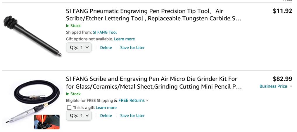

- SAP#10215607 VHT Flame Proof Red
- Si Fang Engraving Pen (See ordering information below)
Work Instructions for Marking Option
- With the vehicle on the lift clean catalytic converter to prep for painting.
- Paint with SAP VHT approved red paint. (Follow instructions on the can)
- Engrave with vehicle license plate number. Make sure to engrave the Cat itself and not the heat shield if possible. See pictures below.
- This process should take about one hour to complete.
CLAMPING OPTION
Work Instruction for CatClamp Option
Parts list:
2. Assemble Clamps
3. Routing the Rope
Final Check
