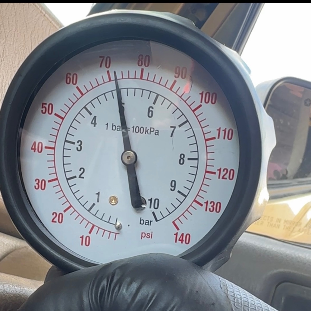

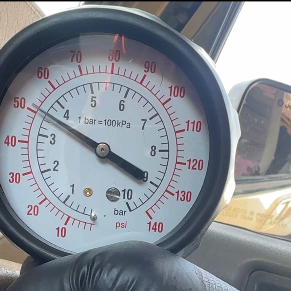

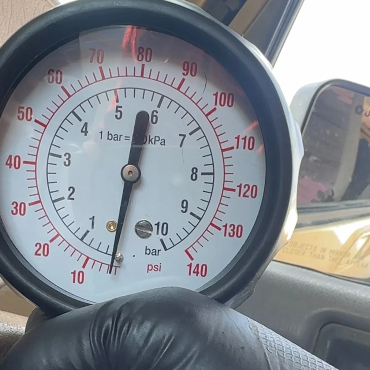

Kidding aside, the engine ran cold idle for about 10 seconds before shutting it down when it puked out those 3 quarts. Otherwise before and after that it was running with appropriate oil level. Seems like, so far, it didn’t sustain damage from low oil.
Off:
Idle:
Rev:

It’s so inconvenient to get that tester back on haha so I’m not in a hurry to get that done today to look at it hot. I’m fine with the numbers right now.
Thinking my pump just grew muscles. Or it only pooped out a small sludge ball thing and big granddaddy Sludge is still in there squishing with my relief valve.

When an engine/oil is cold , the pressure always looks great . I would like to see 18 - 20 p.s.i. hot idle and 40 p.s.i. at 2200 - 2500 r.p.m. hot . You're likely just fine , but the hot readings will tell a more complete story , after you get a chance to check it . Hang in there !
