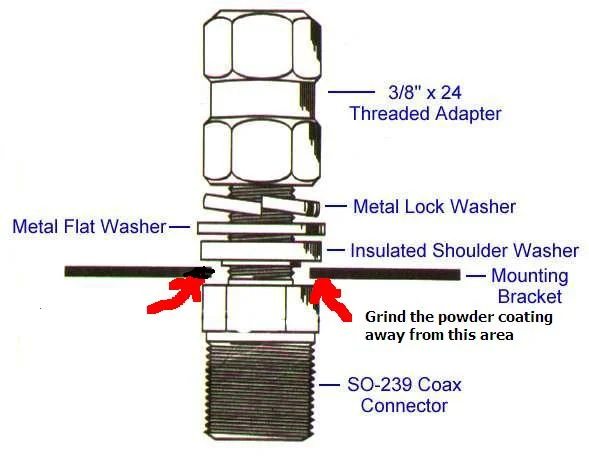

If you have the type of mount shown below, take particular care that its Insulated Shoulder Washer is present, installed exactly (!) as shown, and that it is centered in the hole. If it's not, the antenna will have a dead short to ground.
Also, certain parts of the mount must be well grounded. Like where it bolts to the Jeep, and where the top of the SO-239 Coax Connector touches the mount... the powder coating must be removed from the bottom of the bracket as shown so those two parts have a good solid electrical connection. Don't remove the powdercoating inside the hole.

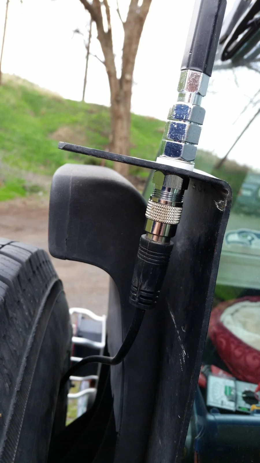

Here is pic of my mount
It appears to be assembled properly. Did you grind the powder coating away from the mount so the it is properly grounded where it is attached to the Jeep and also underneath the mount where the top of the bottom-half of the antenna mount touches it so it is properly grounded? No ground will cause a high SWR too.

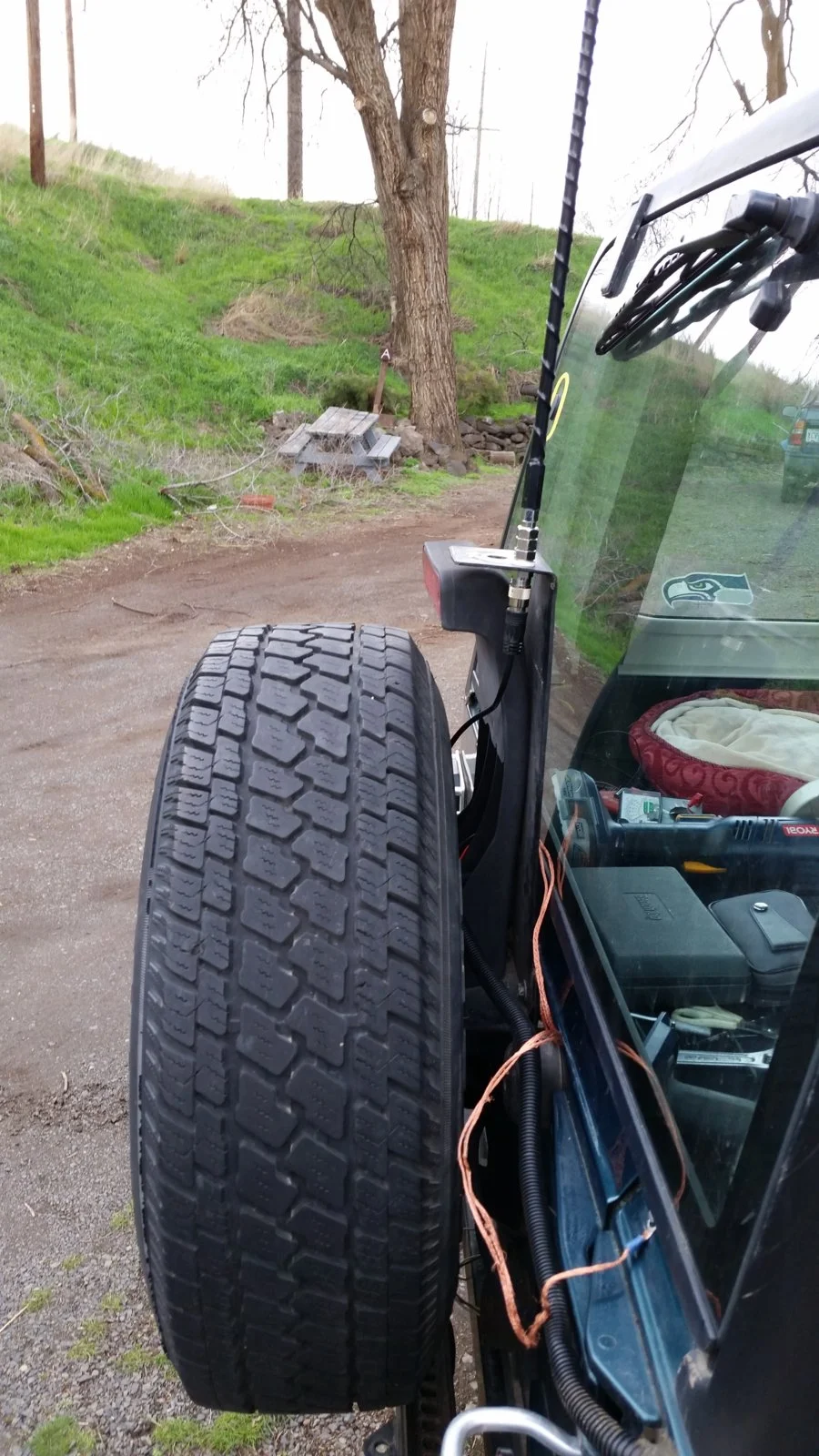

It does not have a tunable tip. I've never have got it close enough to try to tune it. Is the ground shown in the picture sufficient? The mount is one that I made
The wire itself is probably adequate for a ground but I dunno how it is attached to the mount or Jeep. Tailgates are seldom well grounded so if that's your ground, odds are it's inadequate.
I've never seen a FIrestik with a white cap on it but for non-tunable tip Firesticks, they are usually tuned by pulling a wire out of the top of the antenna and snipping short lengths off between SWR checks. Don't snip off too much at a time... which is why I always recommend the FS series of Firestick antennas which have an easily tunable threaded brass tuning tip.
