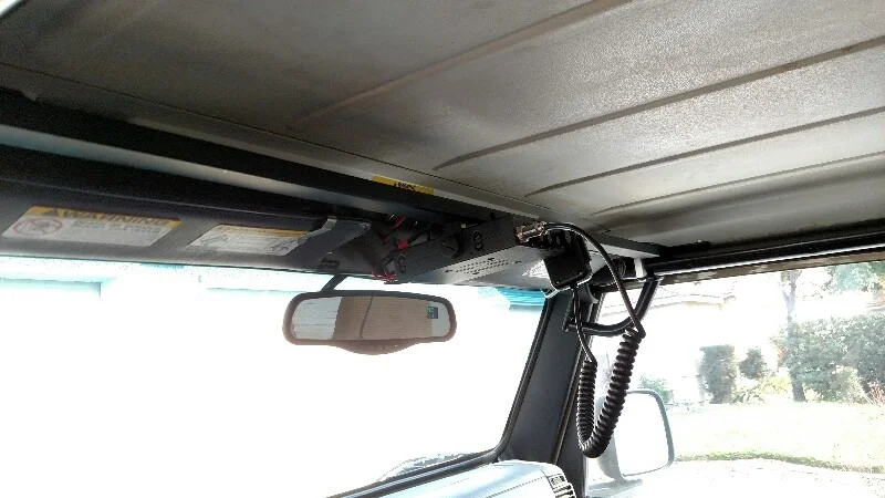

My CB & ham radios have had a few positions over the years but the last 15 have been just above the mirror. Using an Arizona Rocky Road mount which both hides the wiring inside and doesn't require any drilling. I zip tie the antenna cable to the side rollbar pieces and center support and then run the cables (2m ham to the passenger side, CB on the driver's side) along the sides just below and inside the tub's outer edges so it's not visible.

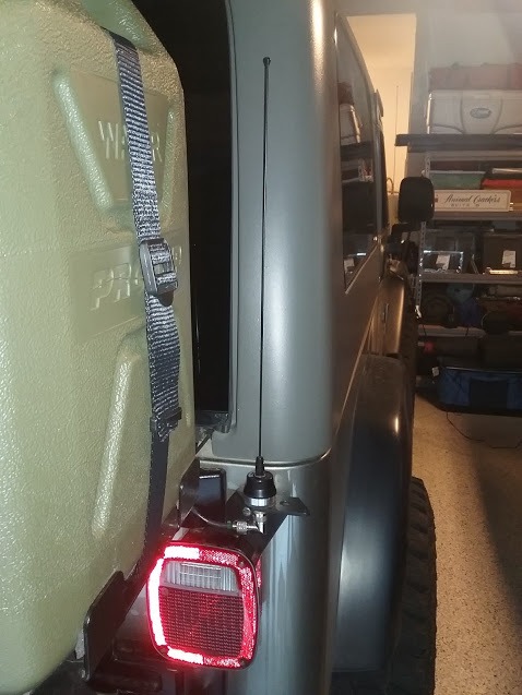

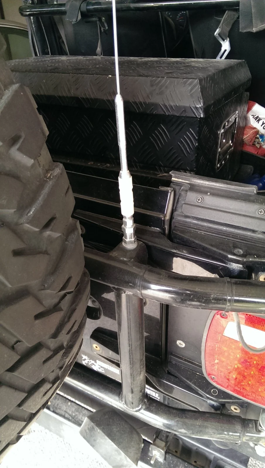

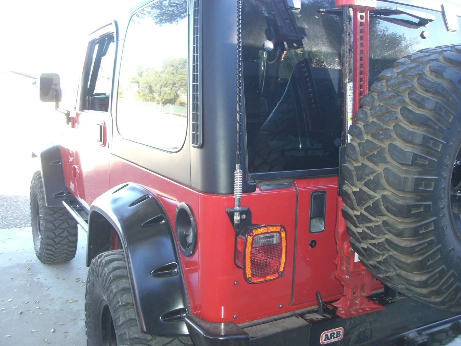

For my antenna, I used the Terraflex bracket on the Drivers Side Taillight. Finally, my antenna cable is routed along the roll bars (under the padding), down the B-pillar, and then along the bottom of the top edge of the tub. Goes through the grommet for the taillights, and follows the taillight harness to termination.

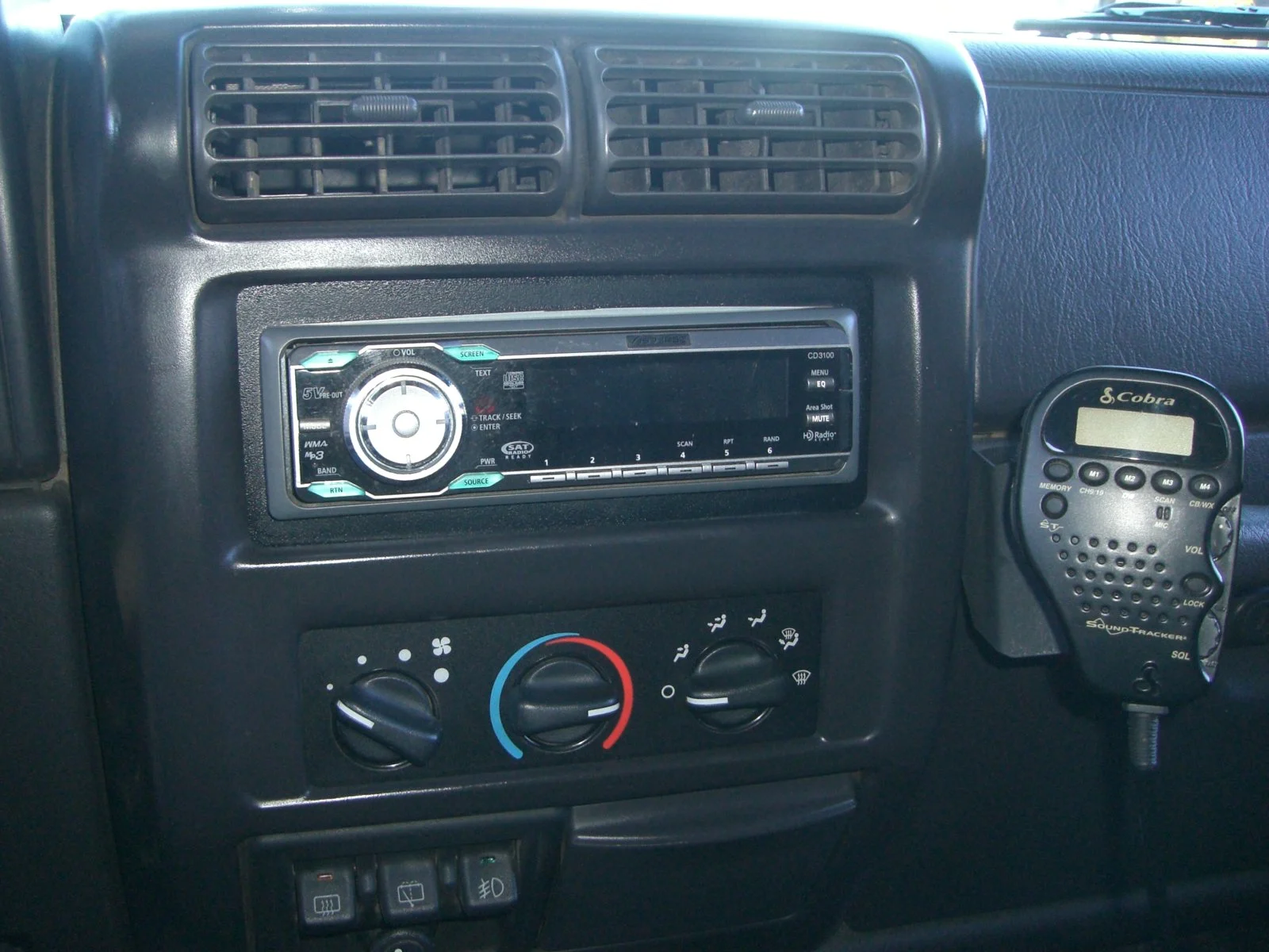

I prefer a very clean, uncluttered dash area. I’m still at work on this, but so far CB is the Cobra 75WX-ST. It mounts via a Road Pro Mount directly to the right of the head unit and attaches to the hidden box under the leading edge of the center console. Antenna coax travels under carpet to b pillar and under edge of tub. Next I’ll use the Teraflex Mount on drivers side and 2 or 3’ firestick.

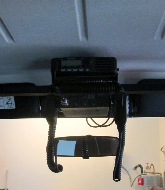

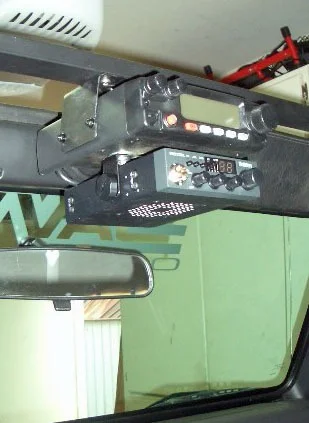

My radios are mounted to an Arizona Rocky Road overhead mount (Kenwood TM-281A 2m ham above; Uniden Pro520XL CB below):
x0AIT6X6WFrnZUJ7swIrBXIGPCR7DsvfbI-gQNk_kn1XtNTm9oGPQxpQVKMsLn20syfisSu9oN0QxqDcD5E=w555-h637-no.jpg

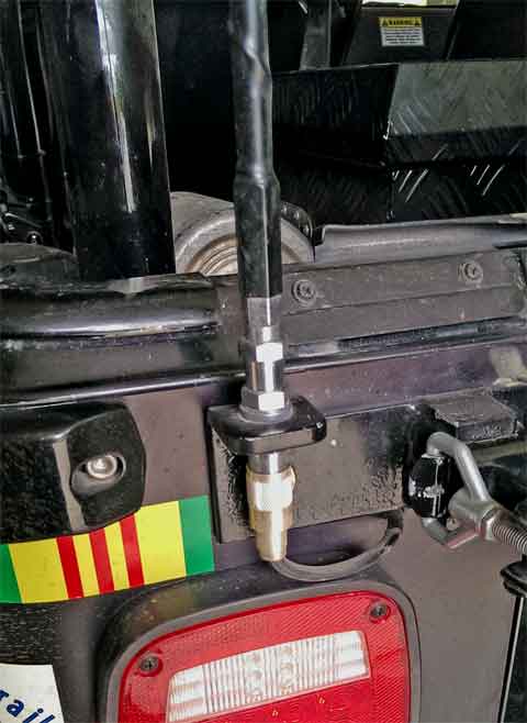

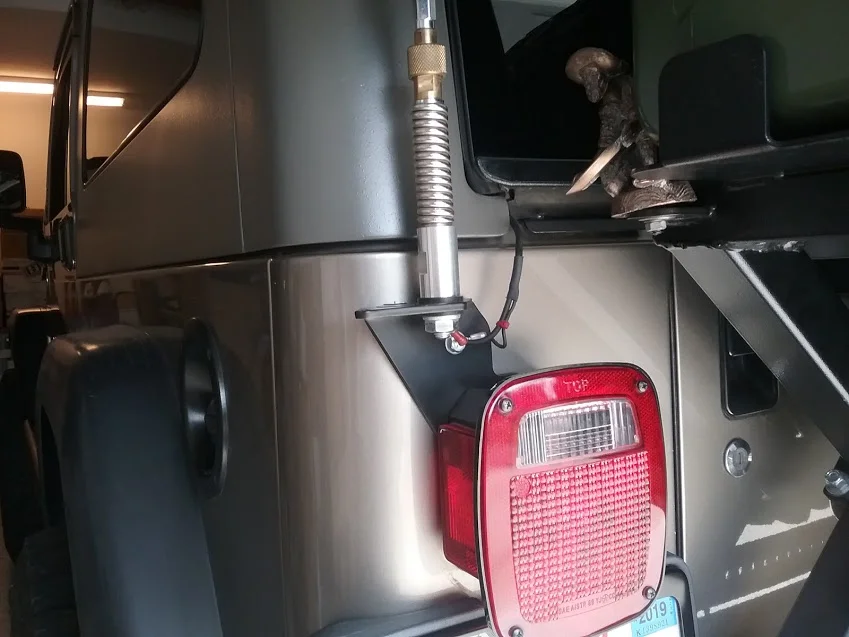

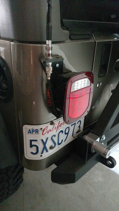

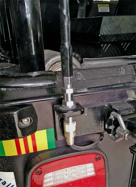

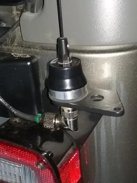

Antenna mount brackets are Teraflex tail light mounts. The CB antenna is on the driver's side, either a 2' Firestik II or 4' Firefly depending upon need, utilizing a Breedlove stud mount with mini quick disconnect. (BreedloveMounts.com.) The ham radio antenna mount is a Breedlove drop in NMO mount. I am currently using a Larsen 1/2 wave 2m antenna.

The mount is basic in design - a piece of rectangular steel tube,open on each end, with flat steel ends that sit on top of the factory sport bars and bolt to existing threaded holes in those bars.
