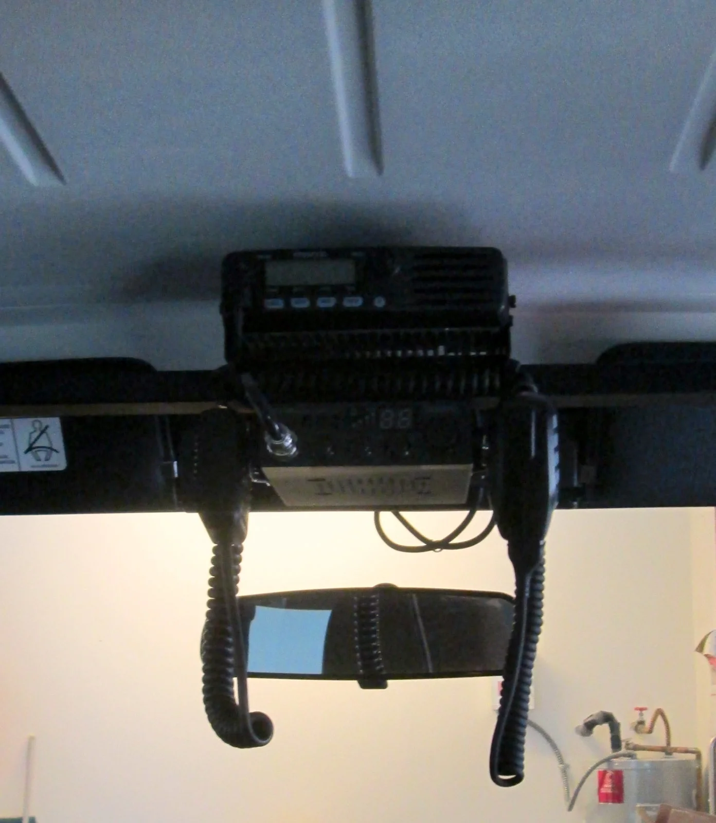

I would go the CB route. Most Jeep groups you would go with or run into have CBs. I do carry two VHFs, incase someone in our group breaks his CB and is unable to communicate with us. They are small cheap and handy to have.

Despite its limitations, CB remains is the most common means of radio communication for offroaders. A Uniden Pro520XL is all the radio you need, mated with Firestik coax, stud mount and antenna. rightchannelradios.com is a good online source with many tech articles, however recently I have been patronizing wearecb.com, which is located in Oregon - prices are good, as is service.
I also have a 2m ham radio in my jeep. Ham communications are superior to CB, but one must have a license and hams are a small minority of the offroading population which limits utility for inter-group communications.

But in terms of price/performance, Ham radios beat CBs by a mile -- or by many miles. A typical CB radio has a 4W transmitter, but even cheap handheld Ham radios have 8W transmitters (e.g. https://www.amazon.com/dp/B00MAULSOK/?tag=wranglerorg-20).
If you're ever out on your own and out of cell phone coverage, a CB radio isn't going to go very far. But even a cheap Ham radio has a good chance of reaching a local repeater, and then your odds of getting in touch with someone are much better. Even in remote, mountainous terrain, I've been able to communicate more than 25 miles with a cheap handheld Ham radio.
So, I say, go for both.

I bought a cheap Baofeng VHF for around $30, the usb cord for $10 and programmed it using free software to the RR frequencies to keep in my tool bag when wheeling. Our club uses both depending on the group out, that handheld works great.

For a starter radio, it's hard to beat one of the cheap Chinese ones. Baofeng has a model that's less than $25: https://www.amazon.com/dp/B007H4VT7A/?tag=wranglerorg-20. That will get you going and give you something to work with so you can think about what you want for a mobile rig.
I went for the version with more transmit power: https://www.amazon.com/dp/B00MAULSOK/?tag=wranglerorg-20. I've been happy enough with it that I haven't felt the need to rush into getting something nicer.
That said, these Chinese radios aren't exactly easy to use, and the quality is questionable. You definitely need a USB programming cable to configure them: https://www.amazon.com/dp/B00CP0I474/?tag=wranglerorg-20. And you need to spend some time actually reading the manual to figure the thing out.
I think the Kenwood 2M radio is pretty popular for off-roaders around here: https://www.amazon.com/dp/B007470C0A/?tag=wranglerorg-20. Yaesu and Icom have comparable models that are a little more expensive. I'm holding out for a nice dual-band Icom rig with GPS, but the nicer radios get expensive.
