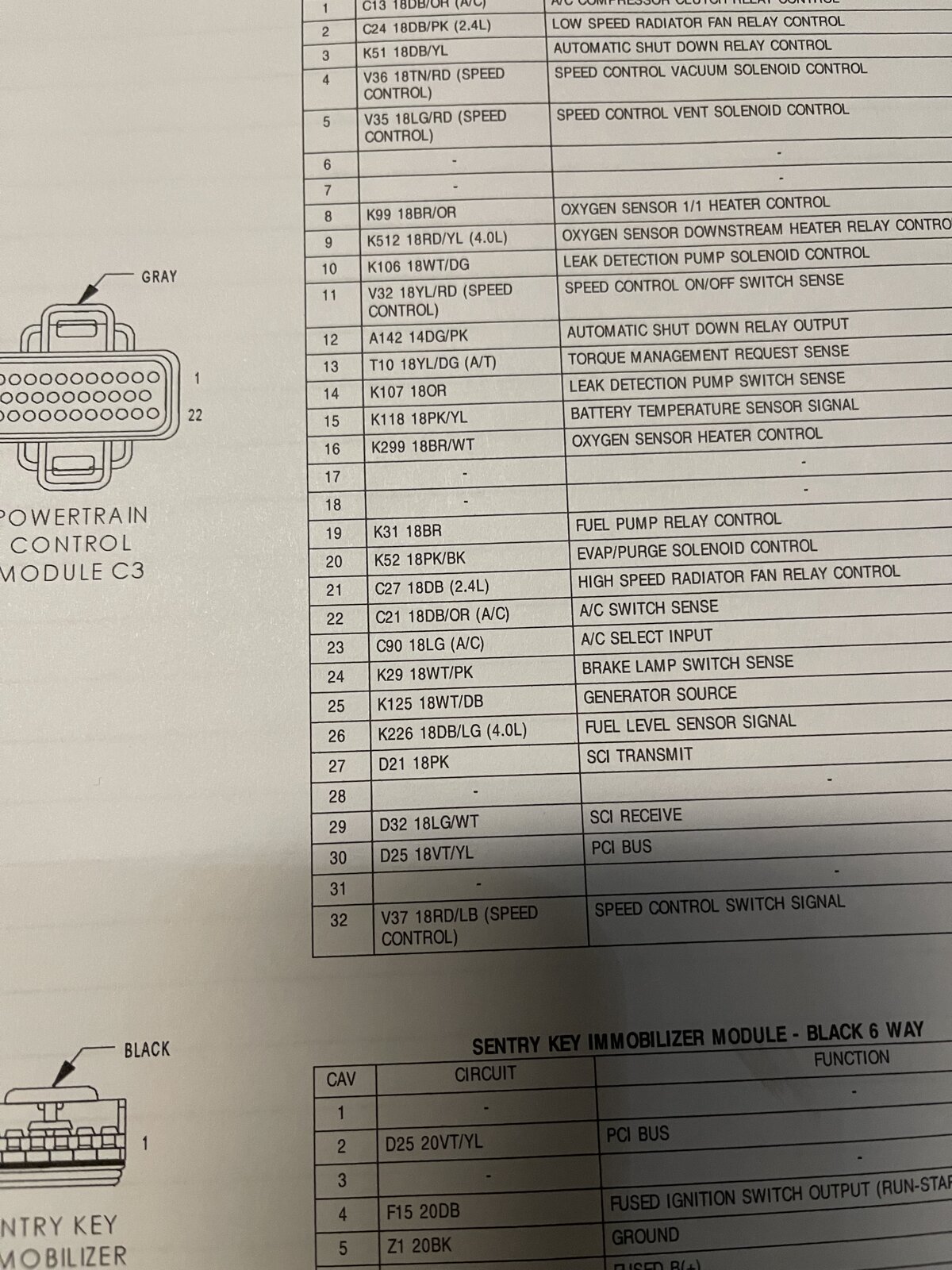

Would it be possible to depin the pci/transmit receive stuff from a 2004 connector and move it to a 1999 connector on the c3 plug

I know I can depin them I’m just curious if it would work. I’m swapping a ccd 5.9 mag into the tj with a pci and I have a spare Tj ccd harness so I could pull the wires for the pci out and replace with the ccd send receive wires.

Interesting. Right now what I’ve got going on a is basically a 2004 rhd that needed a trans and I had a 99 Durango laying around with a 5.9 and 46re so I figure you know what. Let’s do it. I also have a full donor 99 Tj. So my thought to make it as simple as possible and I can’t for the life wrap my head around the wiring. What I need to do to keep everything working properly. Gut the 99 and swap ALL the wiring into the 04. Or do I use the 04 stuff and run aftermarket gauges?? And get the 5.9 running with the Durango harness only? How do I splice in the body harness from the Tj… idk. I guess I will get a better idea once I pull the 5.9 and wiring (still my daily driver for another few weeks) idk. Am I over thinking it?? Idk.

To me, the wiring seemed very overwhelming when reading about it. But once I had both engine harnesses in hand and printed copies of the pin outs from the fsm it made a lot more sense of what was needed to do.
