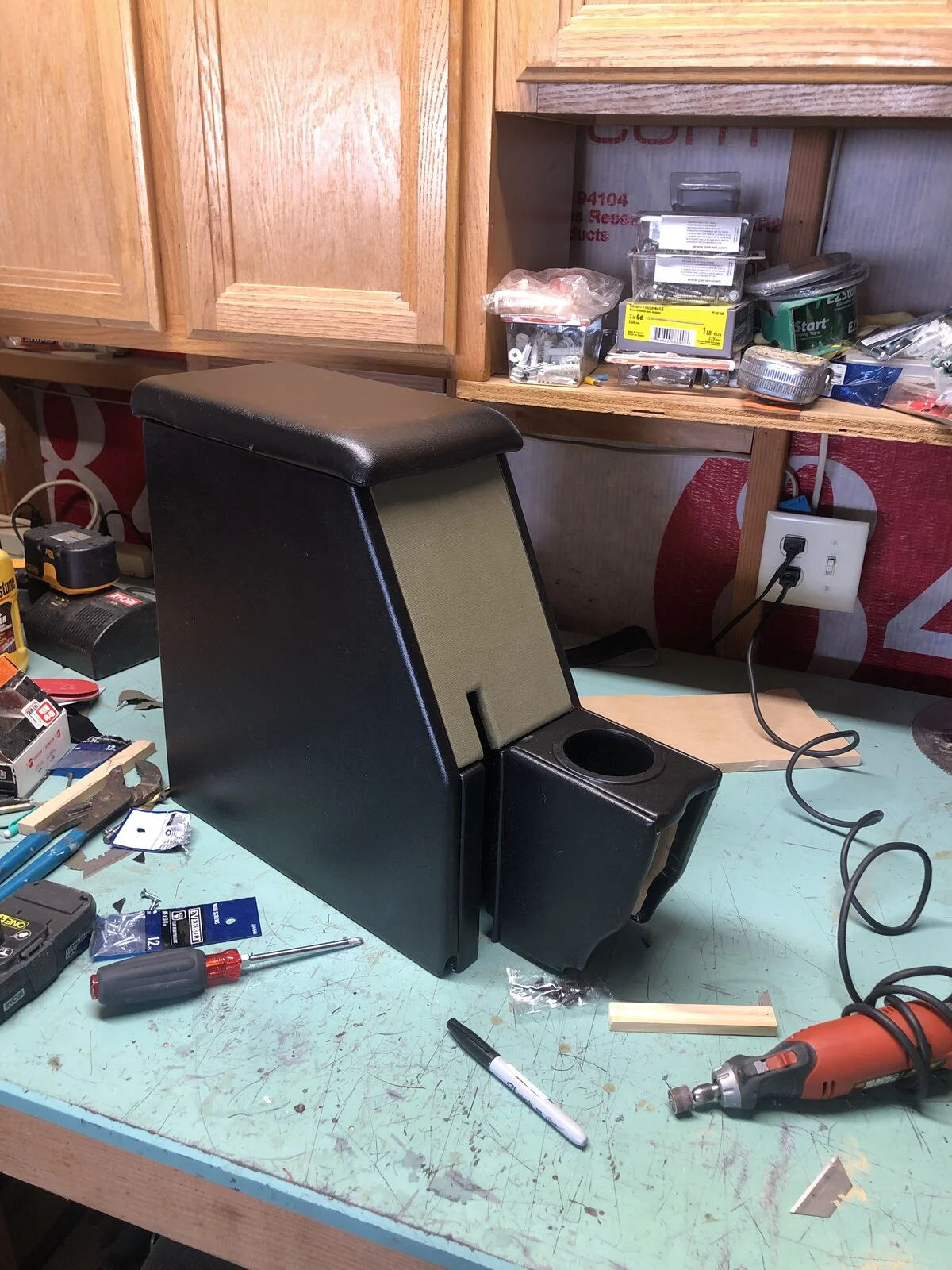

I just made my own. Cost about $40.00 with the usb charger. Took me the whole weekend, but was fun. Search YouTube for make your own center console. That’s all I did.

I basically just went on YouTube and searched “make a center console” I watched several videos. I used a little of each one. The most important was to make a template out of cardboard first so I could make sure the size was just right. Also using contact cement to upholster came out the best. Here is the link I found most helpful:
there are two parts to this video. It was not that difficult at all.
I was going to buy an after market, but the reviews were mixed, and making my own is more the Jeep way lol. Will post a pic before installation

Awesome job!!! What I hate about the console in my jeep is its so tight against the seats and creaks and cracks all the time so having the ability to choose the width would fix that.
