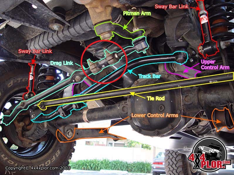

It's easy to recenter the steering box, you only need to use the short adjustment sleeve that's on the drag link which is there for that purpose.
Loosen its two clamp bolts just enough so it can be rotated then rotate the sleeve until the steering wheel is centered. Leave the bolts loosened then take the Jeep for a short test drive up & down your street and keep adjusting it until the wheel is centered, then tighten them.
