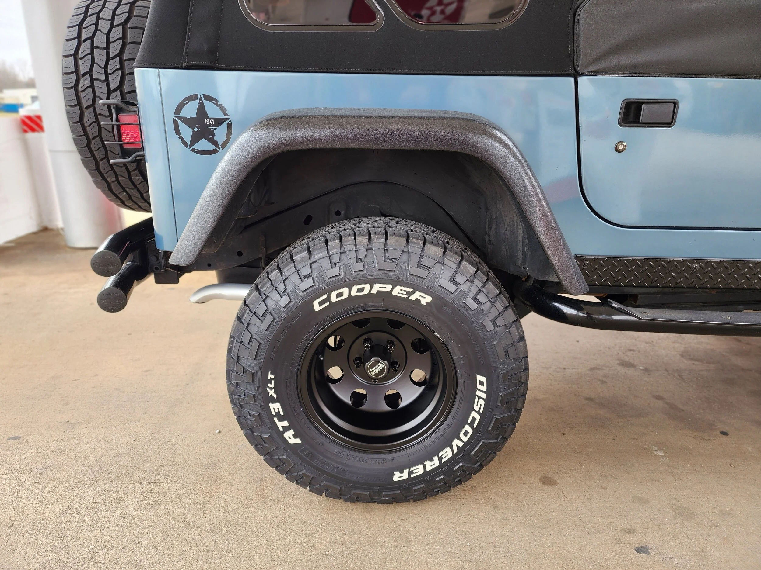

Alrighty, jumping on this old thread, at the advice of, and with @AndyG, instruction and help, after almost four years of struggling and chasing vibrations, and restoration of the jeep ,ditched the steel wheels last week, got brand new American racing bajas, discount tires best man discovered a bad tire, so another extra $300 on top of the $750 in rims, their best man spent two hours meticulously road force balancing, rotating tires on rims, chalk marking rim inside, turning, ect.
Felt great ,up until cruising speed 50-65, vibrations through wheel, shifter, shakes your teeth and the dash. Bad. Feels bearable at 70-85, but at 50-65, I Swear it's about as bad or worse as when I first got it, looking sad with the steelies and old mudders. Vibrations so bad it's unpleasant to drive at those speeds.
New tires, new rims, and have only put 9500k miles on it since I started this in 2020.
So, tomorrow will bolt on the centramatics and see what happens. Here's praying, I'm tired ya'll And the wife is tired of the parts blowing the budget. She's almost killed me multiple times over this, and even blaming Andy for its not working any more. 😅 I'll Keep results posted here.

Nice wheels! Those center caps don't survive sticks well.
-Mac
I've got some steel for backup, but seeing as I don't like mud. Or water. Scratches, dust... the plastic will probably work for a bit lol! ( don't off road, just ride for freedom and the feel of the wind in my hair. Um, over my bare head...)
